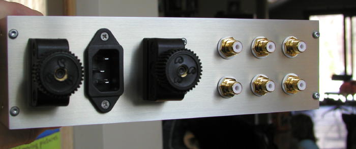

Peter Daniel said:As I said, finished version shouldn't be more than $150. But untill I get a proper quote, I can't really tell. As to female RCAs I like CTFA short, but there is nothing to stop you from using GRFA ( which are actually closer to what I'm using in all my mainstreem projects).
CCBPS is a good choice for the binding post. All holes will be predrilled in a finished version of a chassis and 0.75" distance on 0.50" holes will be a standard.
Aren't the CTFA 3/8" in diameter for the mounting holes, and the GRFA 7/16"?

You are probably right, but there is nothing to stop you from using smaller RCAs in bigger holes.😉
Peter Daniel said:You are probably right, but there is nothing to stop you from using smaller RCAs in bigger holes.😉
Very true. I did this for the chassis that I am currently using for my gainclone. I made all the rear holes 7/16" because I was using the Cardas ones on mine. I made an identical chassis for my friend who used the Dayton Audio ones (almost identical to the CTFA), and realized that they fit loose. I just wanted to bring up the consideration of the sizes in case you designed for the CTFA and someone wanted to use the GRFA.
Brian
Peter,
Are you going to allow for the option of only choosing having one set of RCAs mounted on the back of your chassis, or will they all be drilled for 3 pairs?
Also, would it be possible for you to provide the option of purchasing both the IEC connector, and the rca jacks from you to go along with the chassis?

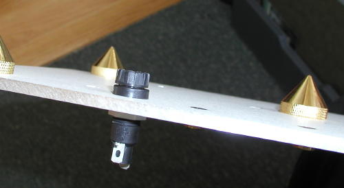

Where are you putting the AC fuse?
Brian

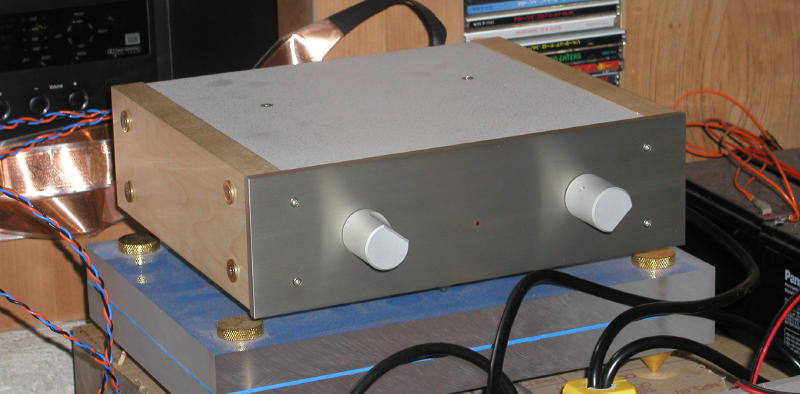

that is looking so sweet!

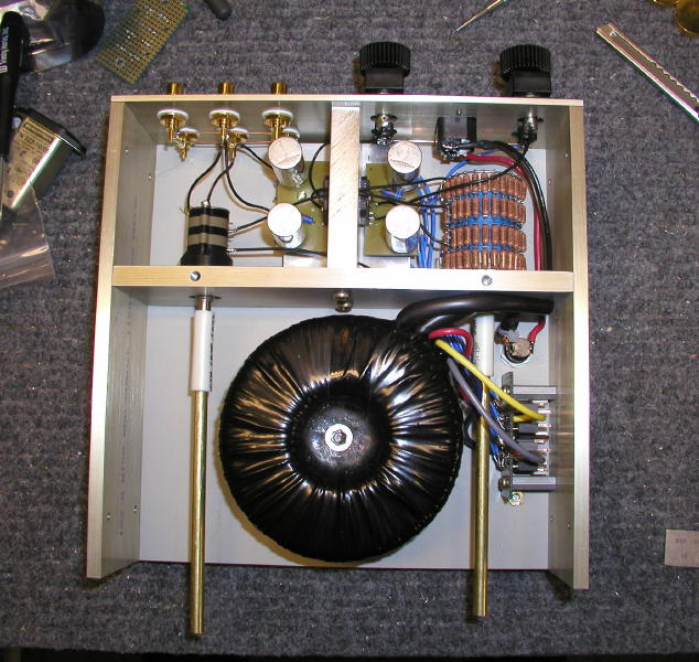

Peter,
Looking very good.
But I can't be the only one nervous about the mains wiring running right next to the volume attenuator. How about routing the mains up the middle, underneath the plate that holds the amp boards? Since that plate is at earth ground, should provide excellent shielding.
Looking very good.
I think the orignal plan with the AC inlet under the amp will be better. Then it will isolate the AC entirely form the Amp part....
I like the IEC inlet where it is myself. Putting it underneath will limit greatly the type of power cord used.

The amp is done and it's playing. No problems at all, no hum or noise.
I'm very satisfied with the sound quality and actually I didn't expect it to be so good. It has very "organic" sound without any traces of brightness. I partly suspect this is due to an insolated chip case that I used here. PS features 1,500/50 Panasonic FC caps. Will do more comparisons tomorrow. I also didn't observe any ill effect of placing top cover, but I used only 2 screws😉 And those Cards binding posts are very practical, will stay with them from now on.
