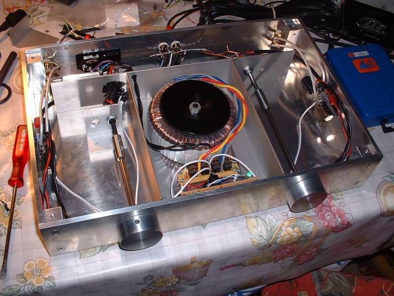

It will depend on the caps choice. They would have to fit between side wall and the shaft extender (standing) and they can't be to tall as the rect board has to be attached on top. You can always separate big caps from PS board and mount them whenever suitable (using some sort of glue or silicone).
But really, you don't need a snubberized PS. Although I tried it briefly, I'm not using it anymore. The "old way" is better;)
