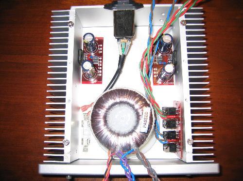

First, I have two of the kits, and they are just beautiful. They shipped to Thailand without incident, the packaging was first rate - great job Peter!
I am a total newby at this, and have a few questions:
- Regarding the LED - I don't understand Peter's explanation for wiring up the LED - where does the power come from on the (I assume) power supply PCB? Do I just attach a wire to one of the LM3875 supply points?
- Regarding the Grayhill switch and assembly, I understand the stop pins, but does anyone have a good picture (or clear explanation) of exactly how the switch is to be wired properly for three inputs? I have the Grayhill data sheet, and it isn't any help and I can't figure it out based on Peter's pictures.
- In my excitement, I mounted the LM3875 pretty close to the PCB, unlike the instructions in BrianGT's writeup. Other than causing a problem attaching the PCB to both the copper heatsink and the aluminum rails, will this be a problem? [note to self, read ALL instructions prior to doing anything!]
- Probably most important, the ground. Which of Peter's recommendations is the safest/best? How is the ground attached to the chassis itself?
Other items are pretty clear. I have decent soldering skills, the requisite DMM, so am able to do a lot of damage without really knowing it

sbolin said:- Regarding the LED - I don't understand Peter's explanation for wiring up the LED - where does the power come from on the (I assume) power supply PCB? Do I just attach a wire to one of the LM3875 supply points?
You need to drop the voltage to something around 1.5V across the diode. You can use an inline resistor as Peter suggests. You, of course, have to make sure that you insert the diode with correct polarity. Or, even simpler if you are using a toriod ps transformer, take some insulated wire (24awg or so) and make a few windings on the transformer. That will give you a dedicated AC winding for the diode. Then just attach the two ends of your winding to either end of the diode. With my transformer, 5 turns of wire.did the trick. You can check this out with your MM.
sbolin said:Regarding the Grayhill switch and assembly, I understand the stop pins, but does anyone have a good picture (or clear explanation) of exactly how the switch is to be wired properly for three inputs?
You can probably find a schematic on Greyhill's site. That and your DMM will make it a straightforward logic problem. Better than trying to describe it without a picture.
sbolin said:- In my excitement, I mounted the LM3875 pretty close to the PCB, unlike the instructions in BrianGT's writeup. Other than causing a problem attaching the PCB to both the copper heatsink and the aluminum rails, will this be a problem
No problem. You can always trim the spacers for the mounting rails.
sbolin said:- Probably most important, the ground. Which of Peter's recommendations is the safest/best? How is the ground attached to the chassis itself?
I've had good results using a resistor (10-100 Ohm from CG to the chassis ground point (no resistor from the chassis ground point to the mains ground - this should be a direct connection).

Thanks for the the info, I will try this (it seems easy enough). Also, good picts, very helpful. I guess you are using a dual mono setup - but why are two diodes missing? Is that standard? (I really have no idea, this is the first time I have seen the mono setup).
For the ground (I assume that the ground is to the immediate left of the GC card in the picture). Did you drill a hole in the chassis and connect it? On Peter's chassis, there is no direct way to connect the ground like this, but I suppose I could drill a hole in the bottom of the chassis for a similar setup.
It's actually 4 diodes that are removed. The transformer is a 25-0-25, center tapped. With a center tapped transformer you must remove these diodes and replace them with jumpers. It's shown in Brian's manual.
Yes, I drilled a hole theough the bottom for the ground. Not sure how Peter did his.
