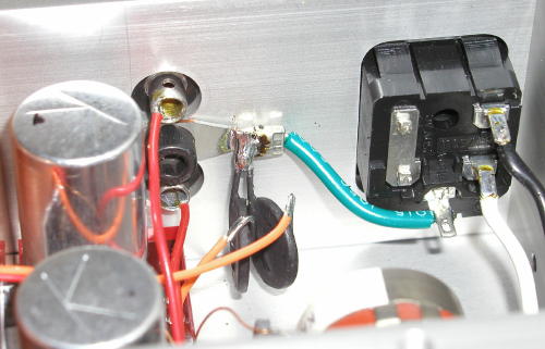

sbolin said:
For the ground (I assume that the ground is to the immediate left of the GC card in the picture). Did you drill a hole in the chassis and connect it? On Peter's chassis, there is no direct way to connect the ground like this, but I suppose I could drill a hole in the bottom of the chassis for a similar setup.
You may use the threaded plugs of the cones for that purpose. Just screw it deeper into chassis' bottom and place M6x1 nut from the top securing ground wire.
I recommend direct connection between chassis and earth pin on the AC socket and connecting grounds from PCB (CHG) through 10 ohm resistors to earth ground.
Use 68k (or so ) resistor in series with diode, 1/4W is enough. The LED were supplied with a chassis and those are the only ones that fit there.

sbolin said:
Hmmm...can I use the diode from the BrianGT kit? (I believe I have a spare).
Ok, this I can understand. What is the wattage of the resistor? I have a bunch of 8 Ohm/20W resistors I could use. How do I attach to the chassis ground point? Do I need to drill a hole in the chassis (as I believe Ken did in his picture above) and attach to that? On Peter's kit there is three brass (?) cone supports - can I attach the ground to one of the mounting screws?
Again, thanks for your help, very much appreciated.
You can use any standard led. I used the one that came with the chassis.
The resistor from CG to ground can be a 1/4 watt resistor. It doesn't (shouldn't actually) pass much current. It's only there to serve as a reference.

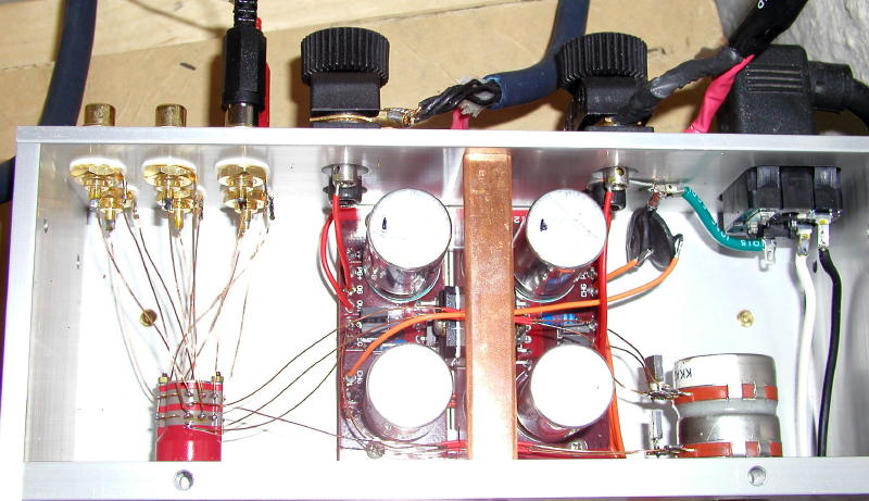

This picture shows ground arrangement: chassis ground taken from the lug attached to back panel through the screw used in Cardas patented posts (you can use cone screw here) and connected to AC Earth. Both channel grounds connected separately to that point through 10R thermistors (you can use resistors as well)
Here's the overview of the whole thing. As you see, I'm using PEC, but the series element is paralleled with 220k Caddocks to improve highs.
