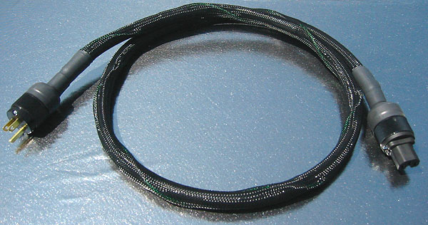

I believe IEC is a standard connector all over the world and since chassis is supplied without transformer, it's up to the person putting the amp together to chosse the proper voltage.
I am a little confused as to how the IEC connector looks on the bottom of the case.
Would I be able to use thicker "boutique" power cords, such as DIY versions of these: http://www.venhaus1.com/flavor2pic.jpg ?
It seems there wouldn't be enough room?
