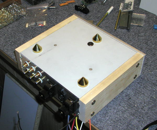

Metal part is 8.8" deep and 8.5 wide. Side panels are 0.8" thick.
To tell the truth it never even occur to me to mount the screws from the inside, I don't really like the perfectly clean look. Properly chosen screws adda bit more of a character to the overall appearance😉
If you check any Japanese stereo with side panels, you'll notice that screws are always mounted from the outside.

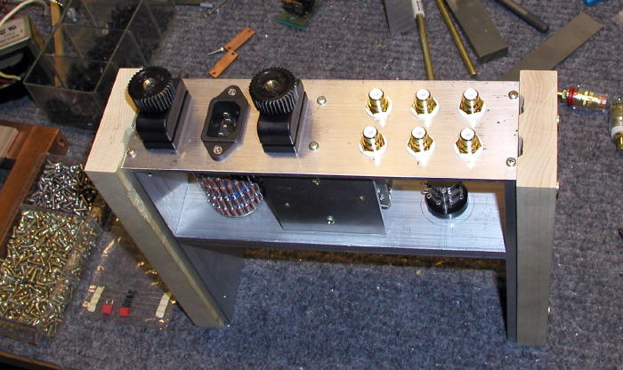

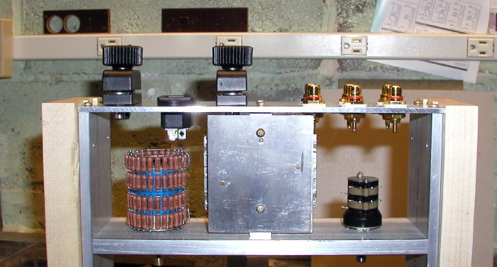

I debated quite long how to populate rear panel and this is what I finally settled on. Initially I had in mind symatrical arrangement, but because the selector switch is on one side, it was logical to mount all RCAs at this end (to simplify wiring).
I also wasn't completely sure about mounting AC socket on the bottom panel. It limits the choice of power cord to be used as well in some situation when such cord is missing, prevents the usage of the amp.
So eventually I decided to mount the AC socket on the rear panel, right between binding posts. Although weired arrangement initially, it appears not too bad at all.
The socket is mounted externally, but if panels will be CNC machined, it can be mounted from the inside as well, providing more elegant look. The only concern I have, that it's pretty close to volume control, but in reality I never encountered any problems with running AC cables side by side with interconnects and speaker cables.

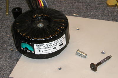

Ropie said:Can you explain a little more about how you would mount the transformer?
I find these hardware from HD to be the most useful in mounting potted toroid. The bolt goes through the bottom, but since it's sort of decorative, it doesn't bother me.
