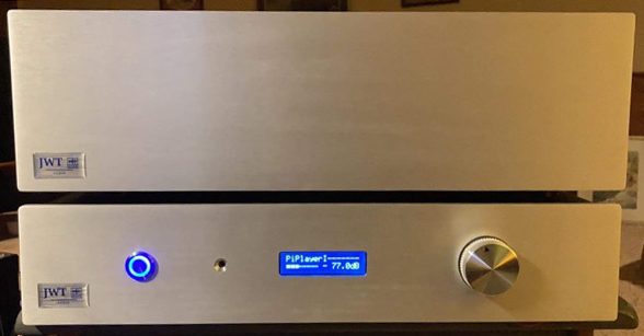

Just wanted to say thanks and pay my compliments to Modushop for the great custom work for my preamp front panel. This required CNC machining on both the front and back and was done perfectly. I ordered via the DIY Audio Store.
The picture shows the 2U Pesante 10mm customized panel with a 3U Dissipante atop, which houses a Class A amp of my own design.
Thanks especially to Gianluca for asking a clarifying question on my drawing to make sure they got it right.
Great service!
