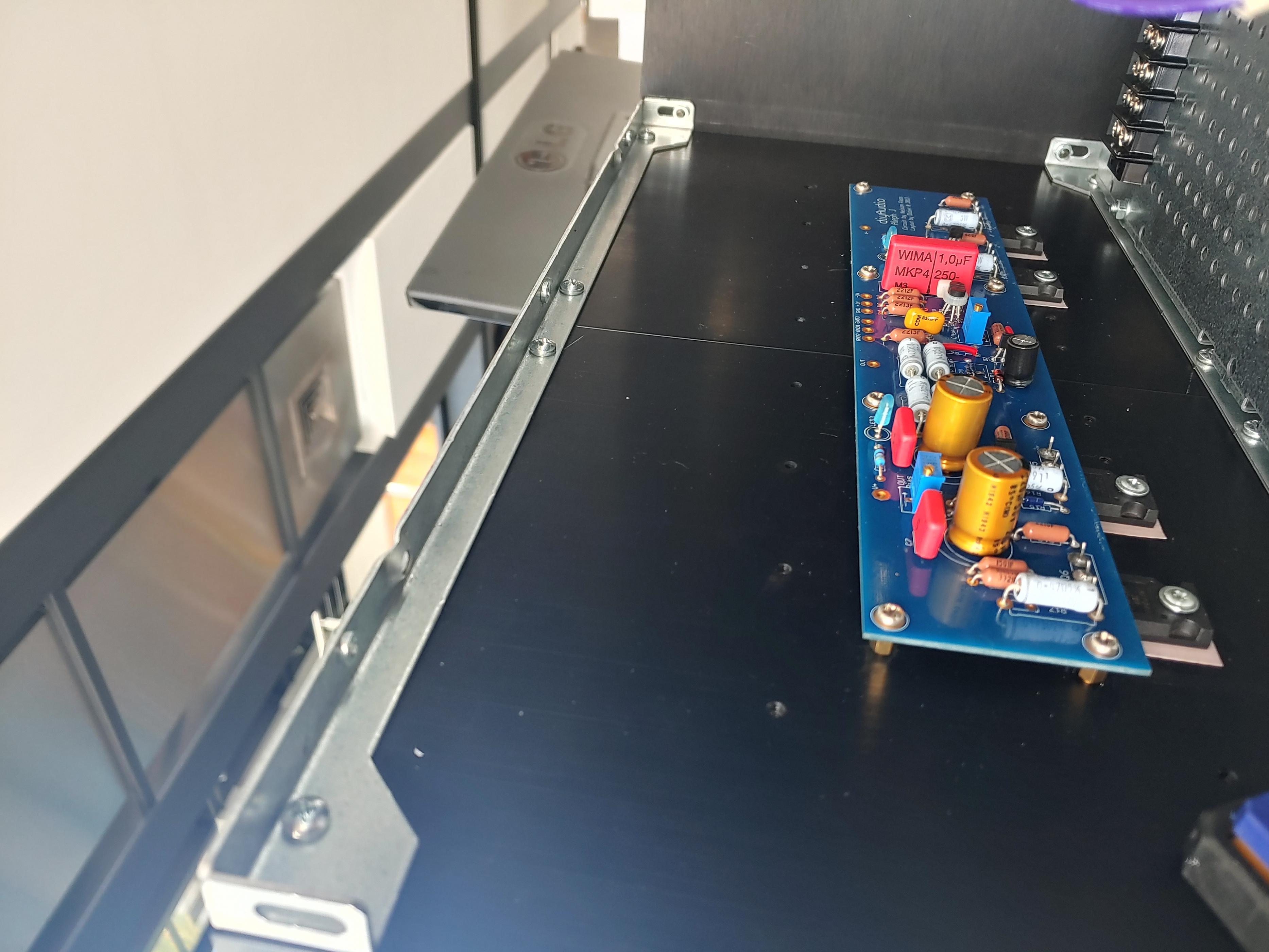

I am looking to mount the top and bottom panels and the holes in the rails appear to be threaded? Am I still supposed to use the sheet metal screws? I tried to put one in and it knocked the threaded collar out.
It may be that you were supplied the wrong (old style) bag of screws, which would have included self tapping screws, instead of the new nuts. The engineer is being consulted to debug this and we'll get back to you directly by email with a resolution as soon as we have an answer.
