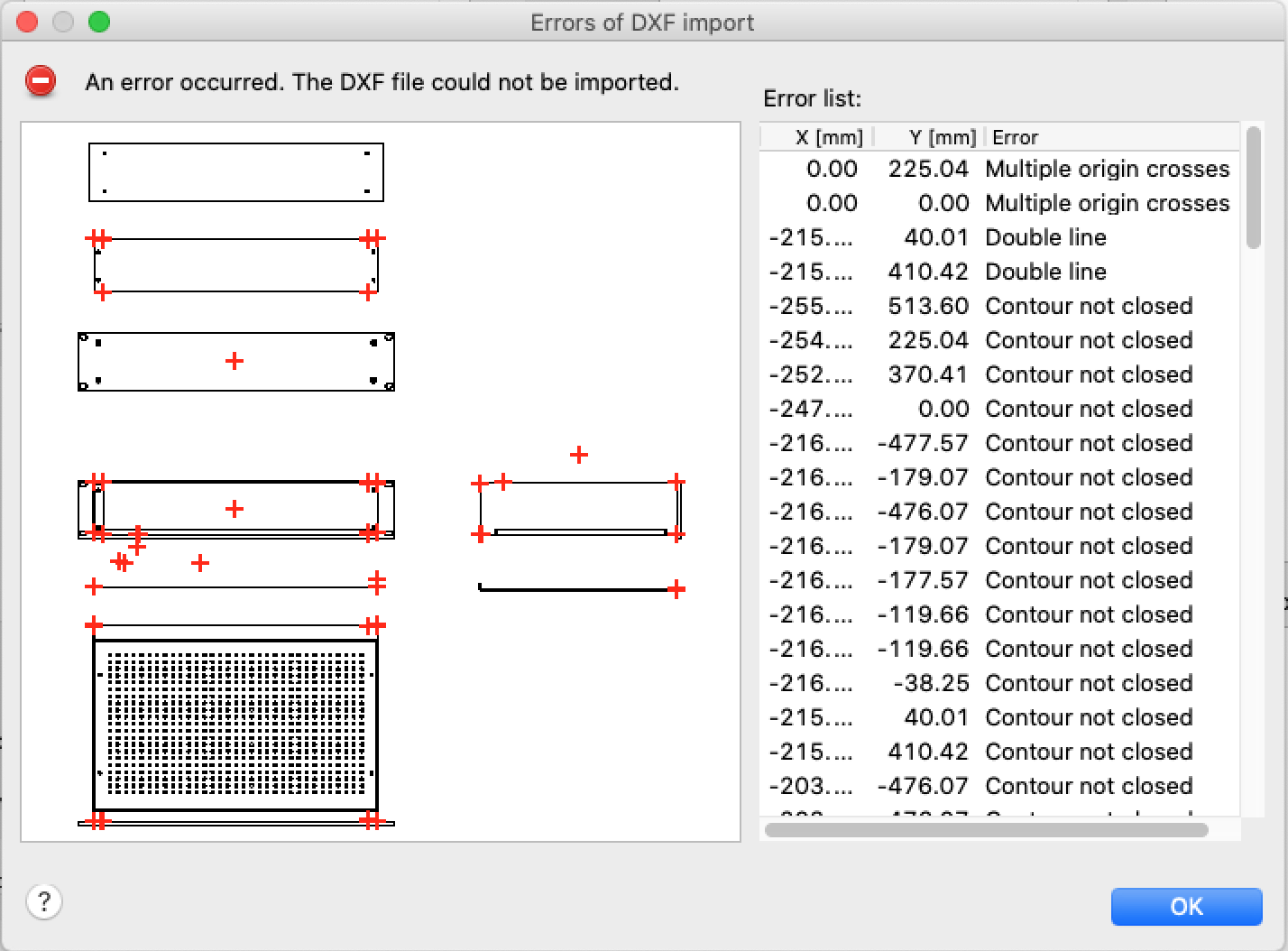

I downloaded Front Panel Designer and the import files manual. I am unable to import the Galaxy 2U .dxf or .dwg files into Front Panel Designer. I get a "Contour Not Closed" error from the import menu.
I've tried:
Galaxy_288_and_283.dxf and .dwf from both diyAudio and Hifi2000
and
front panel 1U 2U 3U 4U 5U.dwg from both diyAudio and Hifi2000
Am I using the wrong files? Is this a Mac problem? I can open the .dxf files in FreeCAD, but cannot manipulate them there. Any suggestions?

I have never tried to import a DXF into Front Panel Designer so I don't know how that works but in case you cannot make it work here are the dimensions of the 2 panels of the Galaxy 283/288:
- Front panel -> 240x90
- Rear panel -> 230x80
You can start a new panel from scratch using these dimensions and setting the thickness to "10mm" or "3mm"

I have been frustrated by this also - FrontDesign instructions say to create a new blank panel, then under Basic shape > Free shape from DXF file and import a file. When I do that with say, the Pesante DXF file, FrontDesign spits out a ton of errors (see screenshot).
(This is on a Mac). Probably the best approach is as suggested in another reply: start a panel from scratch in FrontDesign, then submit the drawing to the shop.
The problem is that I can't find a list of all the exact front panel dimensions - does one exist?

Yes, I think that creating a new sketch from scratch is the best solution
Let me know which is the panel you are referring to and I'll send you exact dimensions
