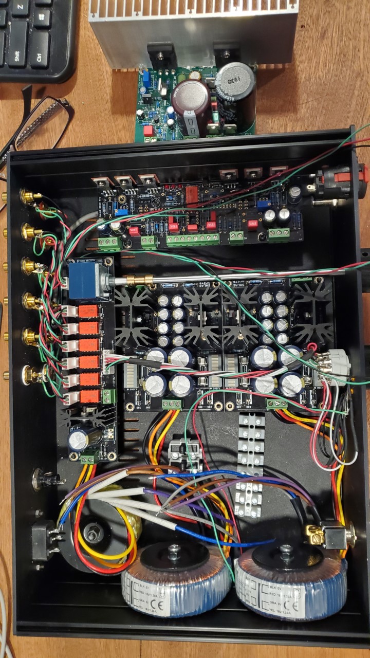

The space saving is temping for a 50w apex power amp. I'll see if Apex guys can help me out.
There is a very, very large difference between the cooling requirements of a linestage compared to a power amp. The extrusions are not heatsinks, as Gian says.
Depending on them to have any power dissipation in a situation like that is risky.

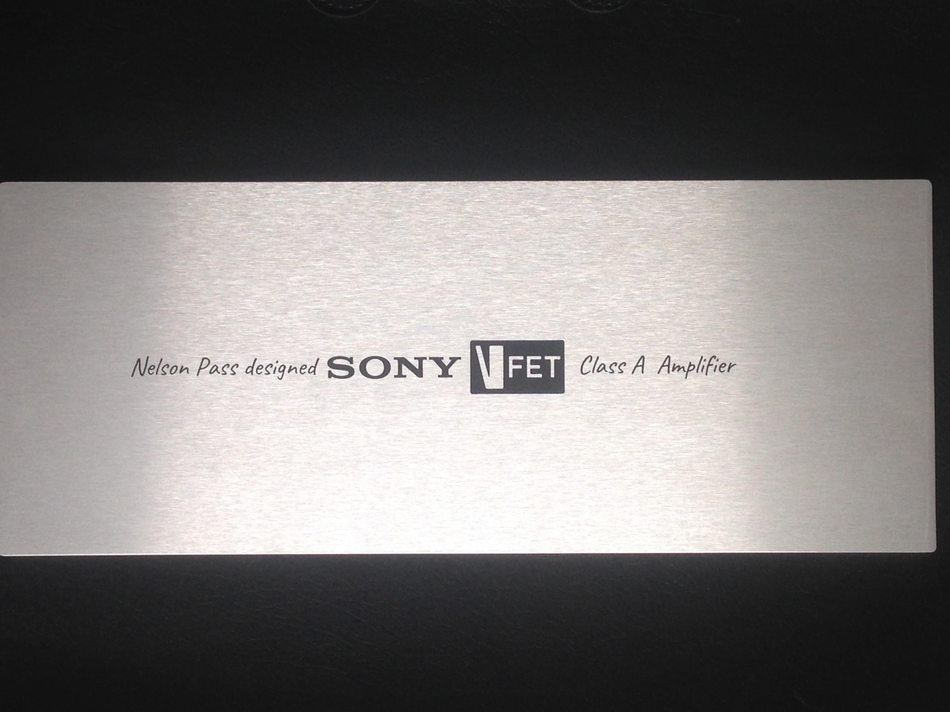

I want to thank and compliment everyone at Modushop for the excellent work customizing the faceplate of the Deluxe 4U I received today! These guys are top notch, providing much higher quality than anything I've received when trying to save a few dollars by ordering from china.
Gianluca, you're awesome! Keep up the good work!
