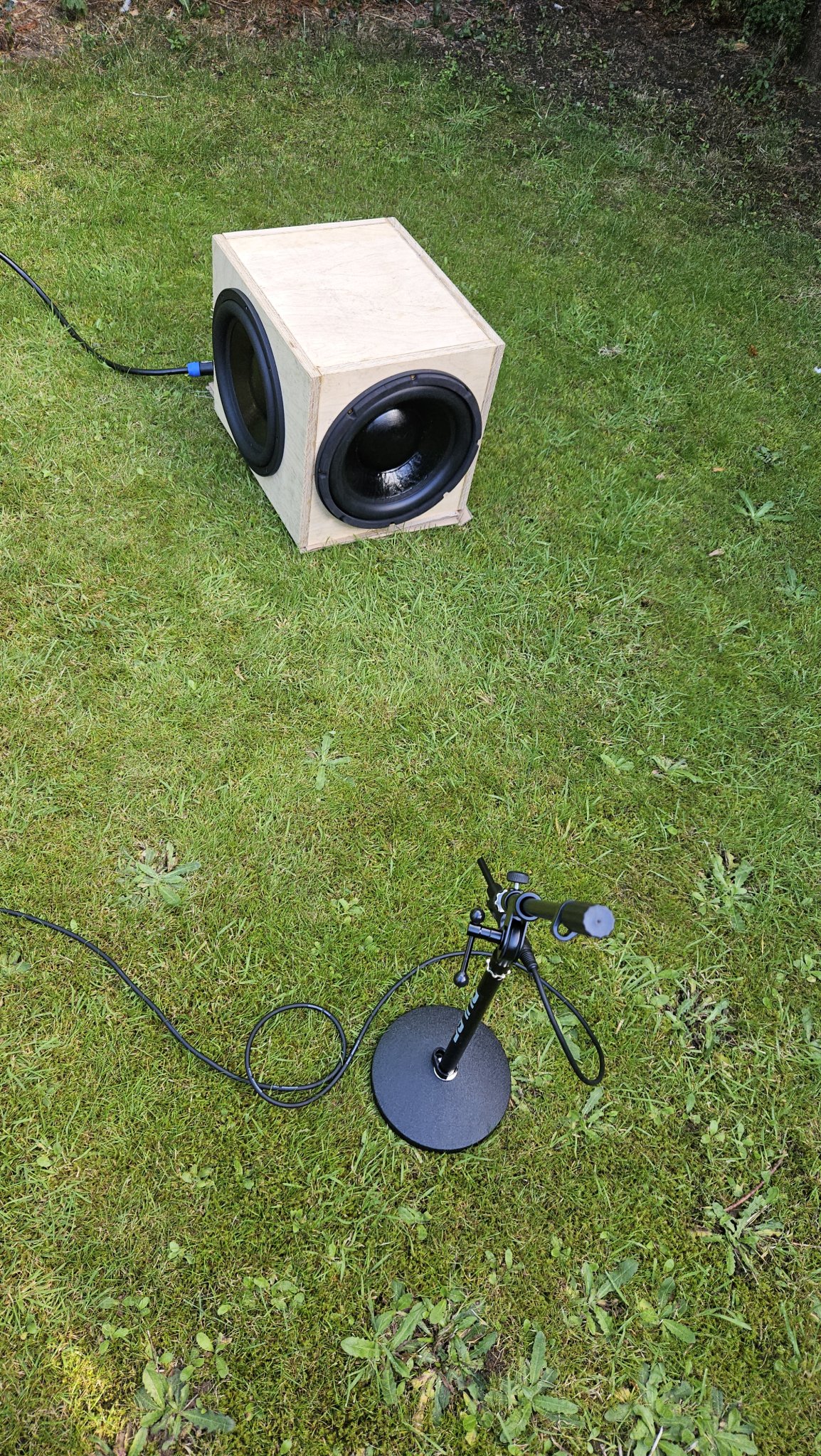

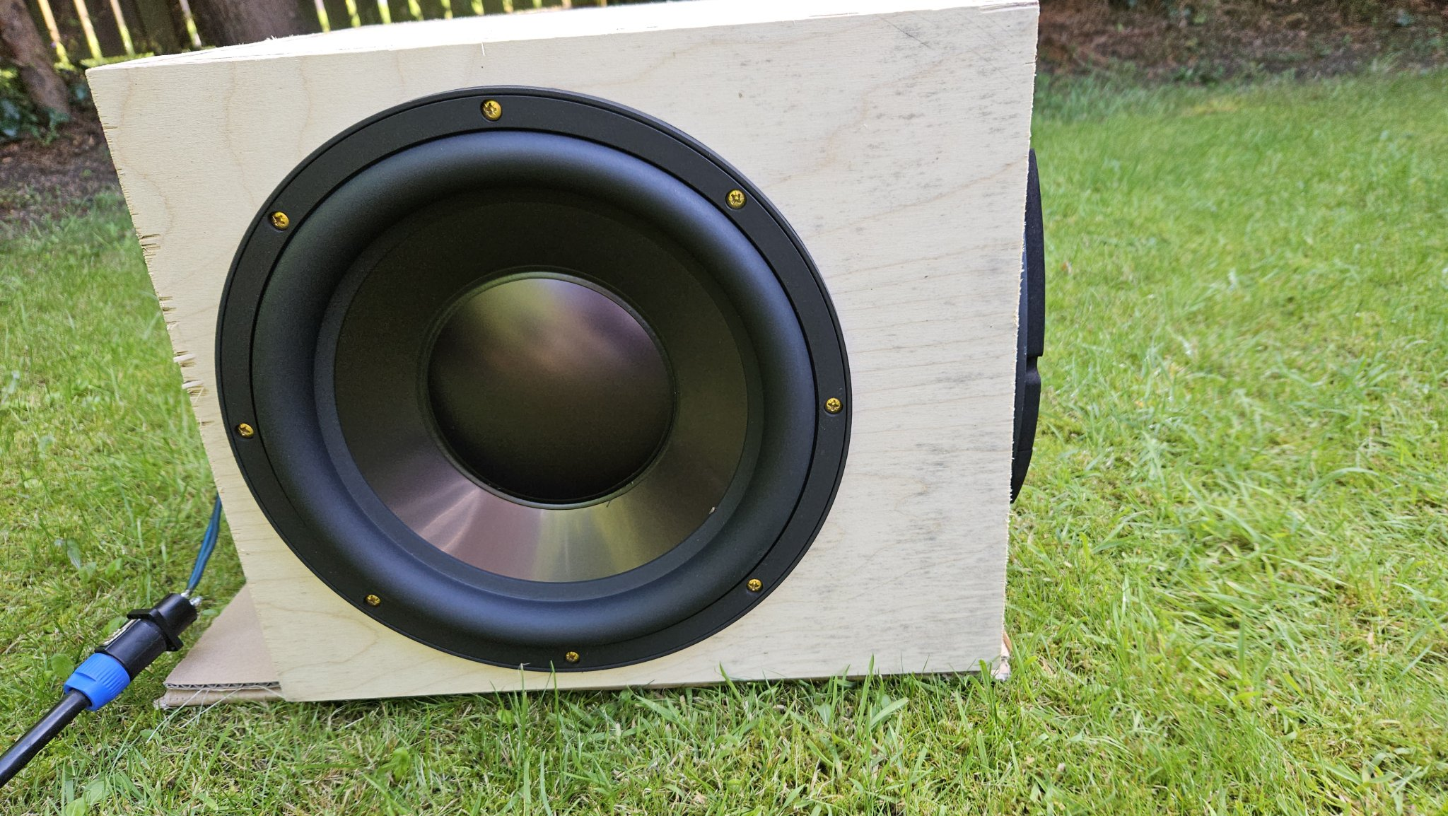

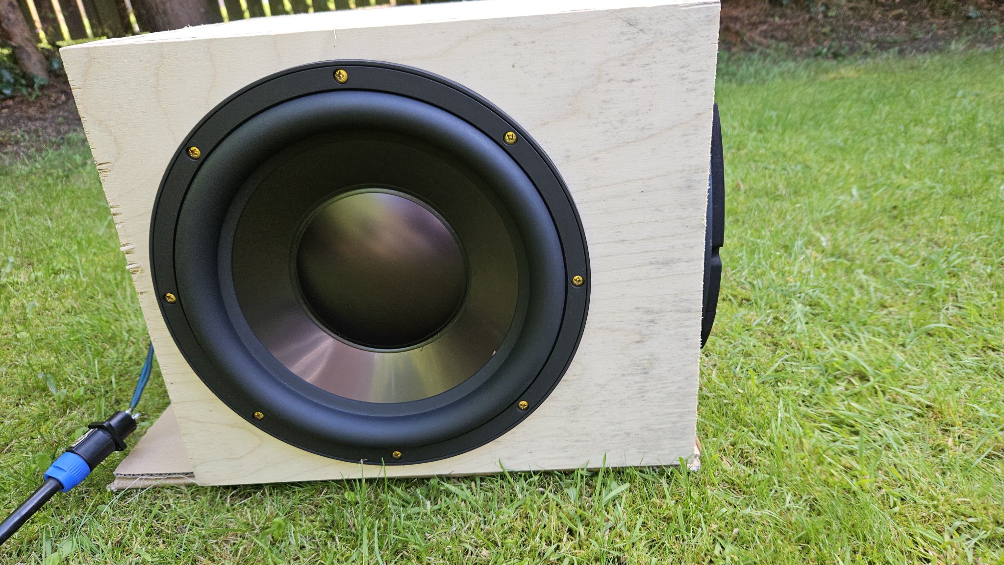

Quick update: managed to remove the last disks. Poked around until they would rattle slightly, and then knocked the basket/back of the PR against the floor a couple of times.
They've essentially filled the dustcap with some rubbery stuff, which must have been slightly tacky when they installed the washers. Seems fine now, though.
According to the impedance curves, the new highest tuning frequency is 48Hz. I put one more disk back on, and got 42Hz. Douglas Adams would be pleased.

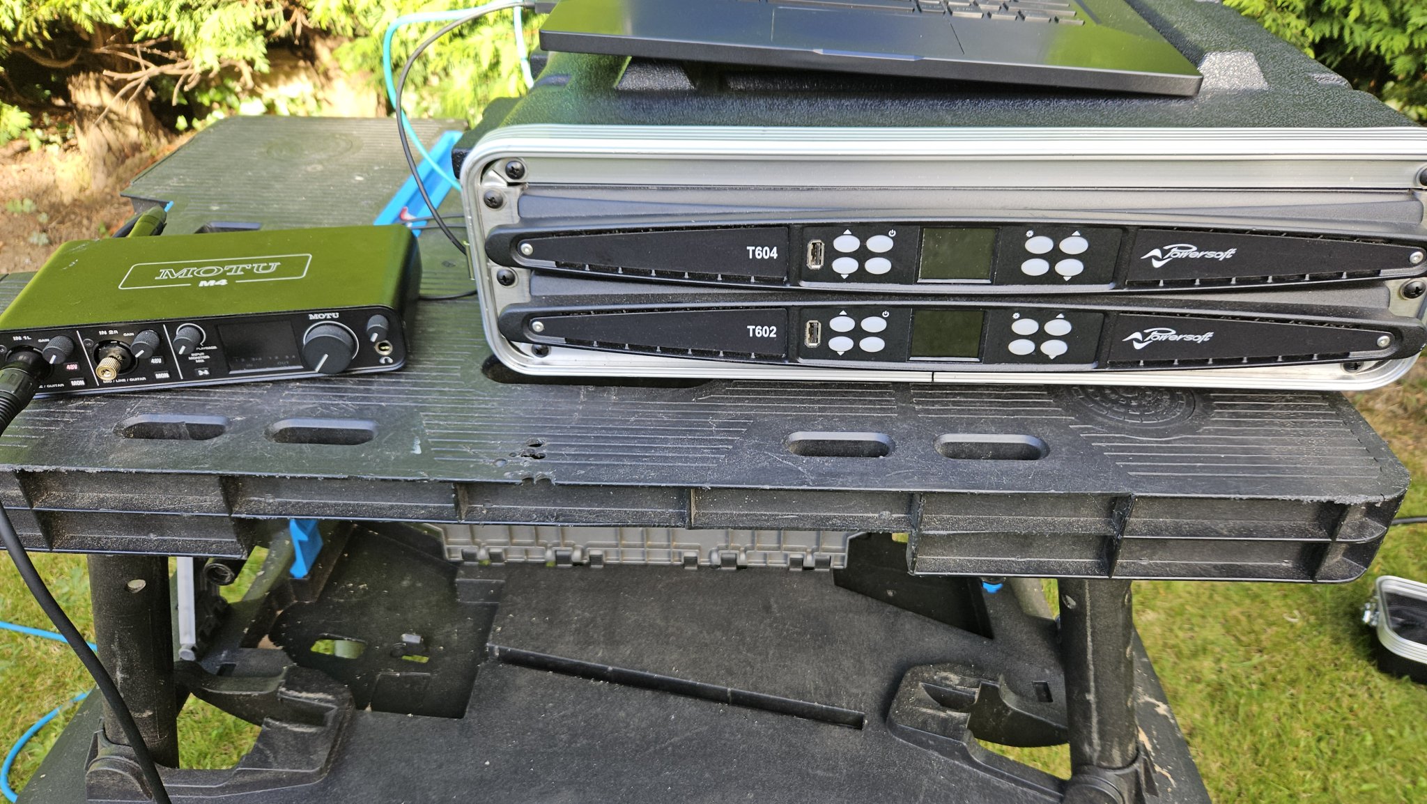

The REW file from the previous round of outdoor testing is attached.
Notes:
  • SPL is not calibrated. I had my Motu M4 interface set for minimum gain on the mic input.
  • First measurement is the impedance curve for the tuning used in the frequency response curves.
  • There seems to be a small discrepancy between impedance minima and what's measured nearfield, so that might need investigation.
  • Last couple of measurements are the 48Hz and 42Hz impedance curves mentioned above.
  • The measurements were taken outdoors, around 5m away from the nearest building.
  • The voltages are the RMS voltage measured by the Powersoft T602, reported by Armonia+.
  • I applied 24dB/oct Butterworth filters at (IIRC) 33Hz and 150Hz. There's a broad-band measurement included.
  • I did try pushing 2dB past the 101Vrms measurement, but the amplifier showed clipping and the frequency response showed broad-band compression.
  • To keep within allowed file sizes, I've just shown the last 3 measurements at -8dB, -2dB and 0dB relative to the amplifier's maximum output level. The last couple made the cabinet sound pretty unhappy.
  • The cabinet was on grass, which has been pretty wet recently.
Upon reflection, I think part of the stronger-than-expected LF slope may be because I was measuring at approx 1m from the front of the cabinet, but the PRs were approximately 1.3m away from the mic.

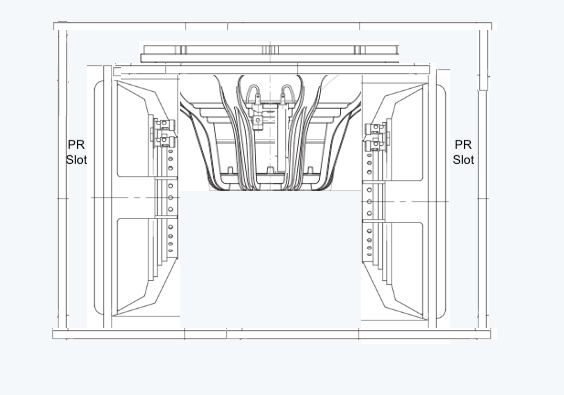

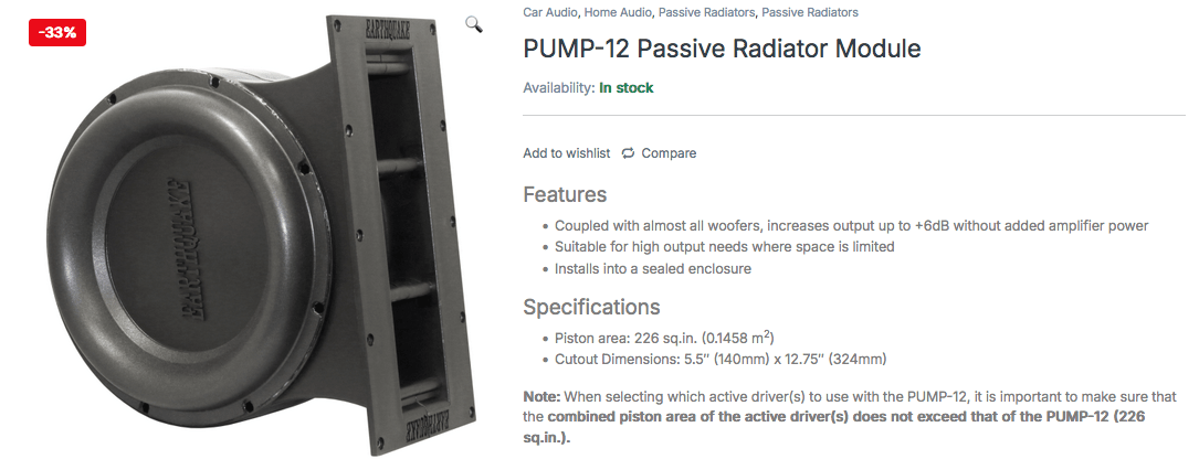

A longer-term conundrum: making this thing "tour-ready". Right now, there are 3x 12" cones, each with considerable excursion capability, open to the elements. It'd be good to find a way to reduce the likelihood of damage without increasing the cabinet volume too much. Oh, and force cancellation for the PRs is of course mandatory.
The side firing PRs may be a problem in deployments where it would be advantageous to put the subs next to a wall, and won't allow tight pack arrays to be ratchet strapped together.
The Earthquake SLAP Pump-12 Module funnels the output of a pair of PRs with ~ 4" (100mm) peak to peak excursion, twice that of of yours, though a small slot.
Slot loading your PRs would only require a single front grill, and all the output would exit the front.
This would also facilitate cardiod arrays.
And your one meter tests would be more accurate 😉
Handles could be side mounted in the PR slots.
The diagram shows the driver front mounted.
A single back access panel could allow rear mounting both PRs and the driver.
Rear mounting the driver would reduce the volume given up to the grill frame.

Art's suggestion make sense. If needed, make the cabinet a bit taller, if making it slightly wider on the front, less deep and rear mounting doesn't give you the same amount of volume, it should still be a quite easy one person carry, and you can link multiple boxes together.

Art, thanks!
I seriously looked at buying one of those Earthquake Pump modules, but decided against it: I couldn't find any documentation about cabinet size vs tuning frequency, nor did there seem to be a way of changing the tuning frequency. ie, I'd just have to buy one, put it in a box and see what I get.
I expect I'll mostly deploy these subs in 1/2/3-per-side situations, where I'll just stack them vertically. Small-format stuff, compared to your systems. I can't really think of a situation where the sideways PR output would be a huge problem, but intuitively I think having all the output from the front of the cabinet is a good thing.
Slot-loading the PRs is an option I'm considering. There are a few iterations that would work, including DIYing one of those Earthquake modules, so I'll do some sketches and figure out what's going to be the most compact overall.
An option that I quite like is similar to the ROAR layout, but with PRs instead of the folded path flanking the main driver. Benefits: extra output above 60Hz, main driver's magnet in fresh air (better than PRs acting as heatsinks), output is all at the front of the cabinet. The main drawback is the increased cabinet volume.
I'll do some sketches and work out the external cabinet volume of all the options I can think of. Then, of course, compare to a ported box. Who knows, that might win after all.
