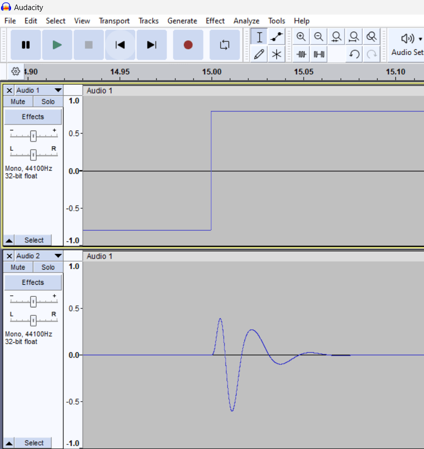

I can do that if you like, but a step response has a lot of HF components which will be filtered by the subwoofer crossover.
Attached is a quick experiment in Audacity. I generated a 1Hz square wave (top waveform) and then applied a 100Hz 24dB/oct low-pass and a 34Hz 24dB/oct high-pass, resulting in the bottom waveform.
The bottom waveform, then, is the signal that would come out of the amplifier once those filters are in place. Are you sure a step response is the correct test signal?
Chris

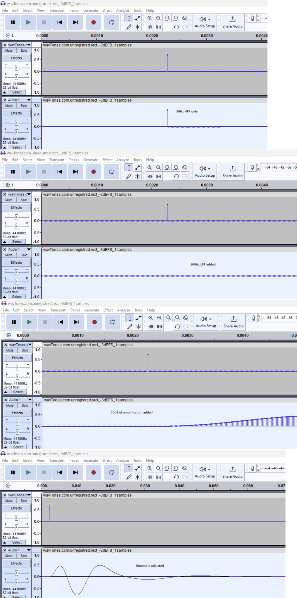

Impulse response.
Here's an impulse response given the same treatment as above. As discussed in the impulse vs swept sine debate, the former has very little LF energy since it contains all frequencies equally. ie, when it comes to an impulse response, there's as much emphasis on 10-20kHz as there is on 0Hz-10kHz. This is why I had to increase the level by 50dB(!) to make the signals visible on-screen again.
You may spot some similarities to the step response waveform posted above.
So, the waveform at the bottom is, once again, what will come out of the amplifier when it's fed with a very-high-level impulse response. Are you sure an impulse is the correct test signal?
Chris
Reactions: Crashpc
