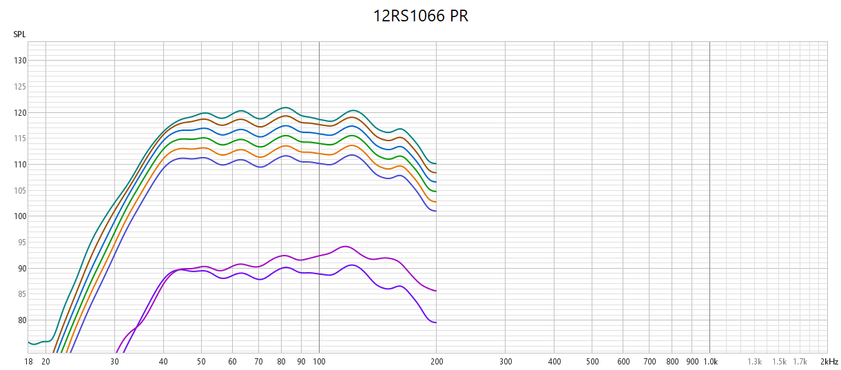

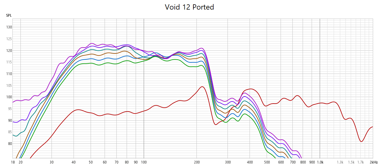

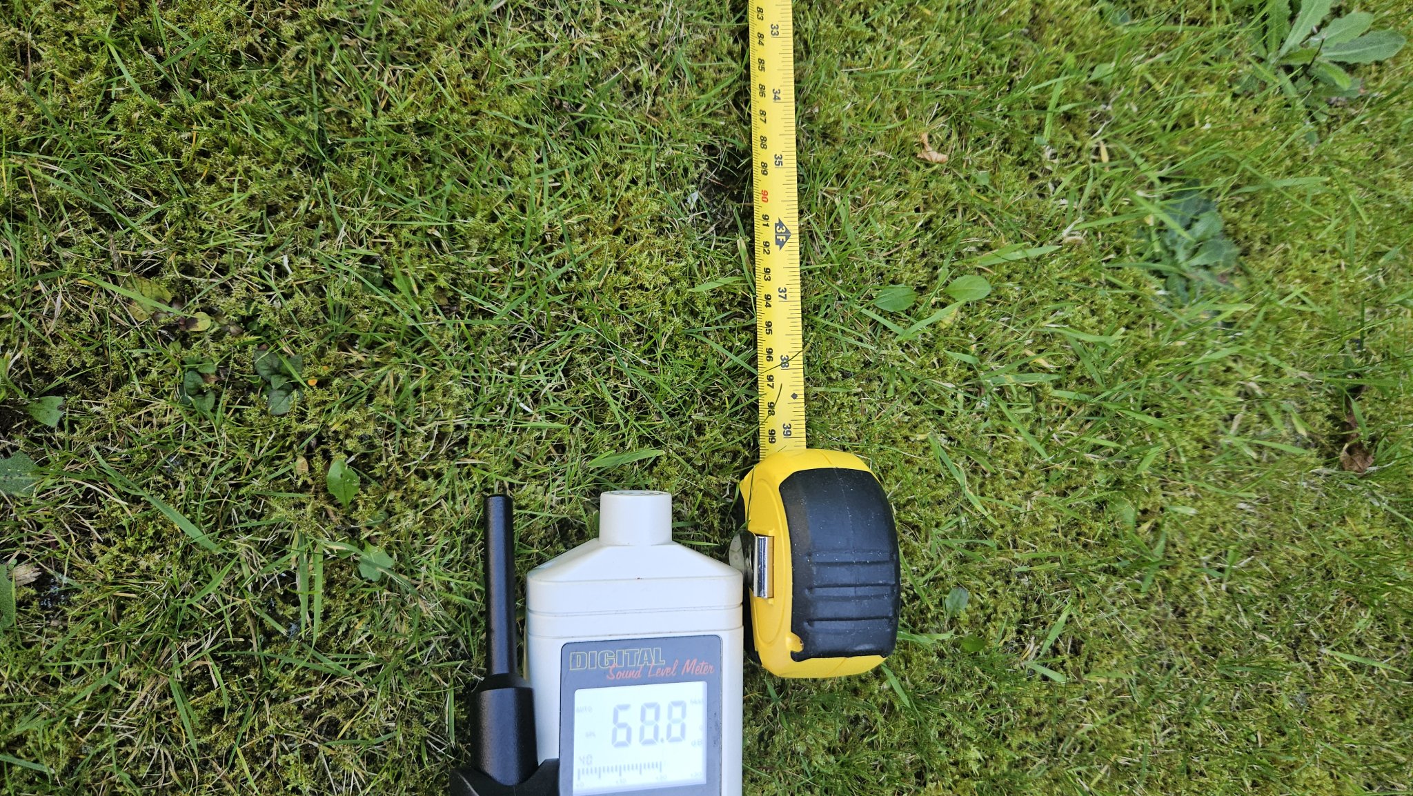

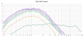

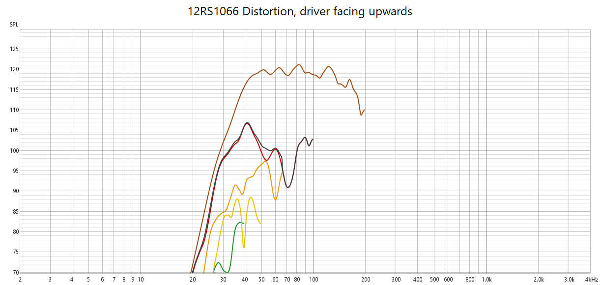

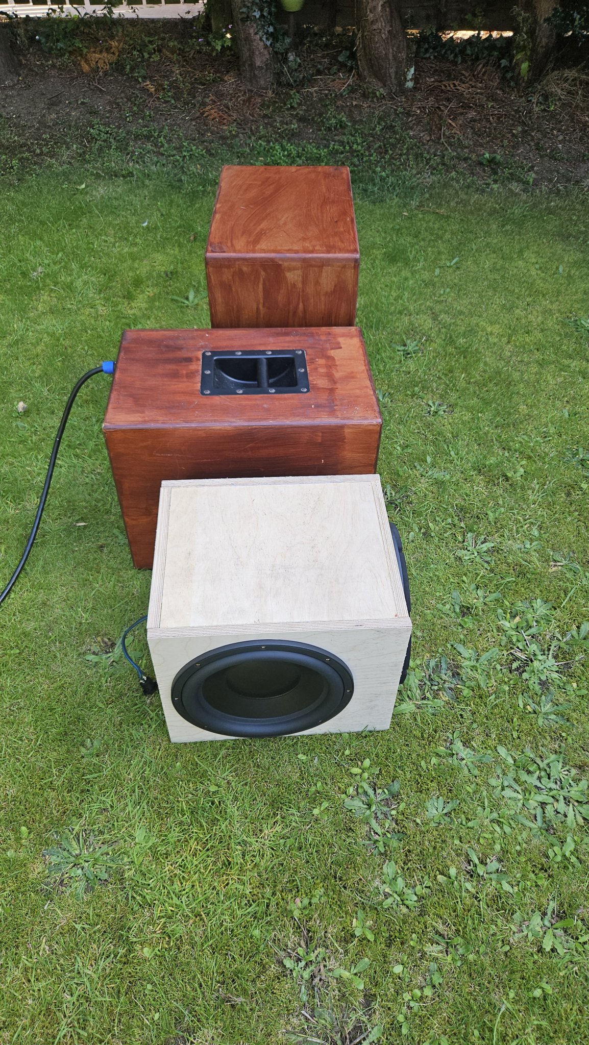

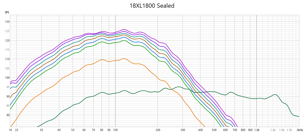

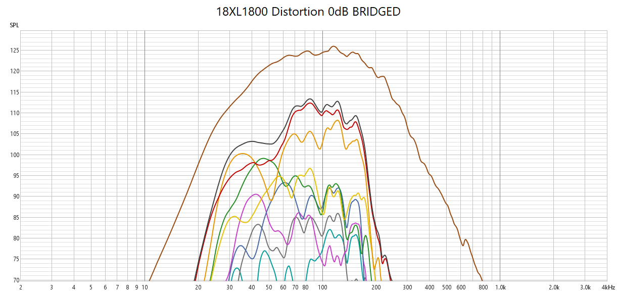

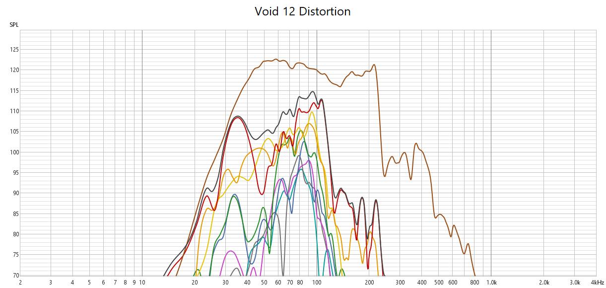

I made some loud noises in the back garden the other day. I put the measurement mic at 1m from the nearest part of each cabinet, and then used my old SPL meter to calibrate REW's levels. NB - while online reviews suggest the SPL meter is okay (ie, within a couple of dB of reality), I'd still recommend that the absolute SPL is taken with some degree of uncertainty.
The SPL graphs were measured at 2.83V (according to the Powersoft T602) and then at increasing power levels until the amplifier ran out of headroom. The amp was bridged for the 18XL1800.
NB - the T602 is rated for 1300/2500/3000w into 8/4/2ohm per channel. Bridged is 5000/6000w into 8/4ohm.

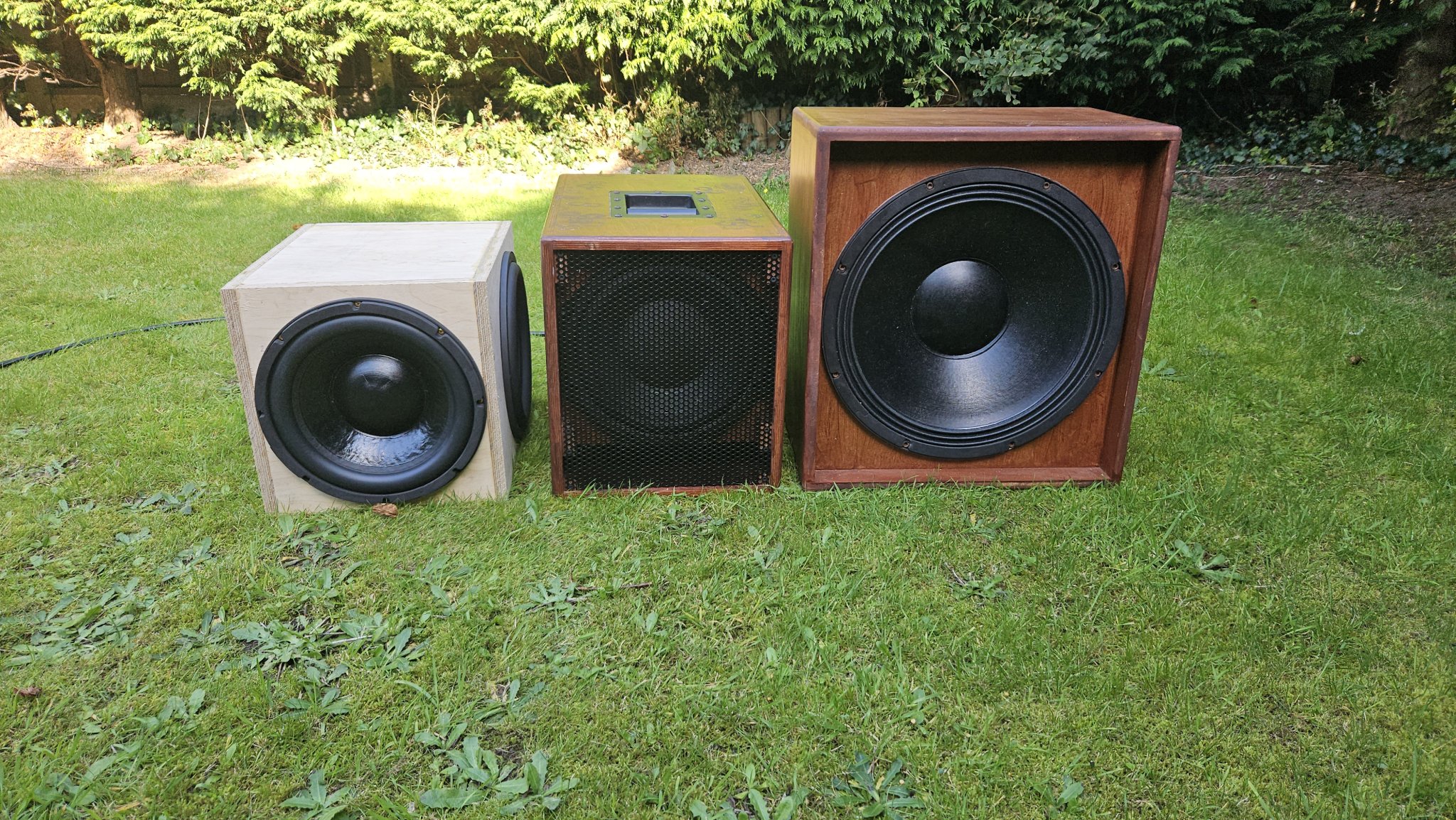

The three cabinets are:
Each SPL graph has the output at 2.83V, and then the last 10dB of output are in 2dB steps up to full power.
Notes from the measurements:
- The 12RS1066 + 2x PRs that's been documented so far

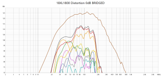

- The 18XL1800 in a sealed box which has its own thread running. As time goes on, I'm less and less convinced that these drivers in sealed boxes are useful in PA situations.
- A Void 12-600B in a 40Hz ported box. Looked like a fun driver, so I bought it off eBay and built it a cabinet a few years ago. It's not bad, all things considered, and does fine on its own for the smaller shows that I work on. This is the benchmark to beat.
- All subs had a 150Hz 24dB/octave lowpass for the high-SPL measurements. It looks like I kept that for the 12RS1066, but the other two are full-range.
- The sealed 18" didn't have a highpass filter. The 12"s did. Both around 34Hz.
- The Void driver shows weirdly high sensitivity - around 3dB higher than the other two subs. I seem to have misplaced the T/S parameters that I've measured, but it might've been a 4ohm driver.
- The 18XL1800 compresses at the top of the range. The impedance is lower there, so I suspect the motor is struggling to deal with that much current.
- The Void 12" sub is showing serious distress at full power. The frequency response shows weird things happening, and harmonic distortion is very high.
- The 12RS1066+2PR is the cleanest of the bunch at full power, but even at 40Hz, it was the quietest.

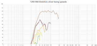

- The 12RS1066 curves show driver forwards vs driver firing upwards (ie, putting all radiators a similar distance to the mic). When the driver is pointing upwards, the response is essentially flat from 40Hz upwards.

Internal volumes?
The 12RS1066 + 2x PRs?
18XL1800 in a sealed box?
Void 12-600B in a 40Hz ported box?

The 12RS1066+2PR is 28L internal, once driver volumes have been subtracted. The Void 12" ported box is something like 50L, and the 18" is around 70L. Can't remember for sure - it's been a while since I built those, and changing my laptop has lost some of the old Hornresp records.
In terms of output density, it's still my best sub. As you've noted, though, it's not hitting 120dB@40Hz. Apologies.
Crash, thanks for the kind words. I think three PRs would be required to get everything out of the 12RS1066, but even so, it's only going to save the ~2dB of compression we're seeing at 40Hz with sine tones. Probably not an issue with real program material.
