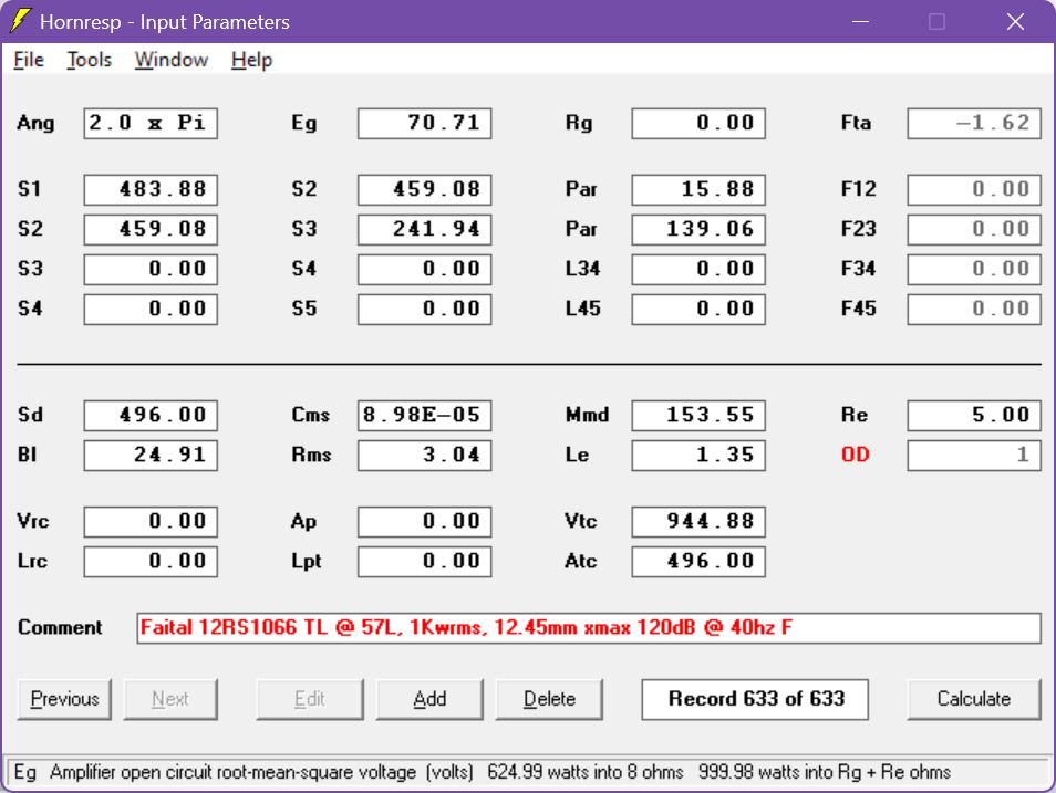

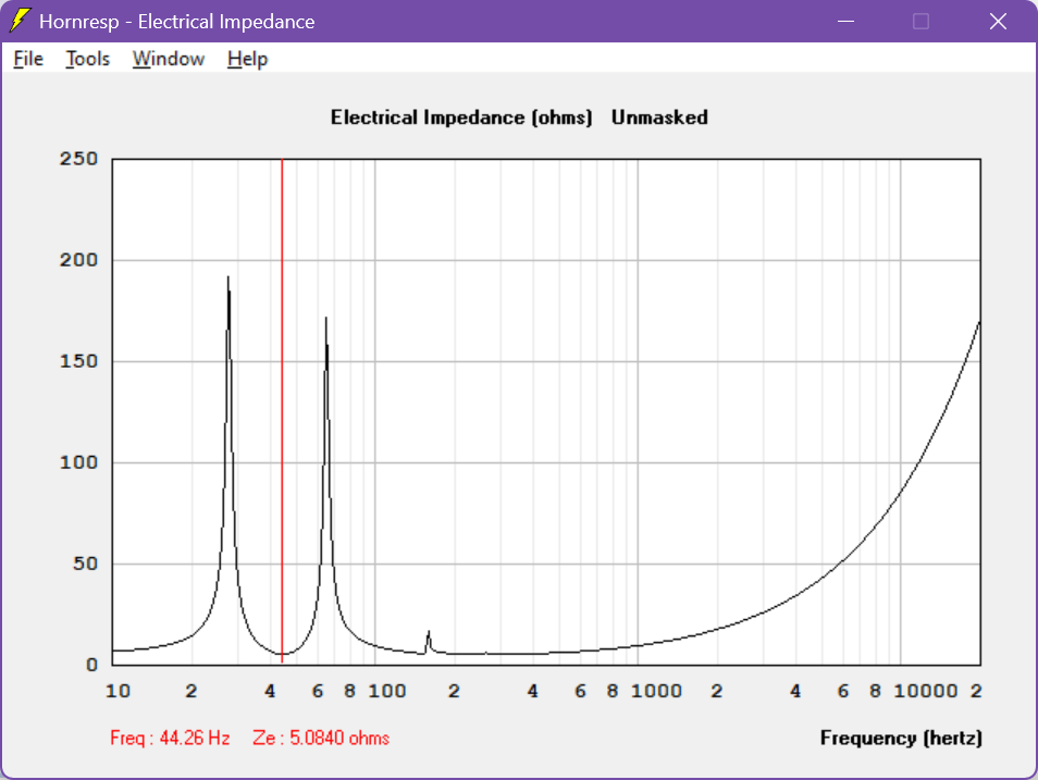

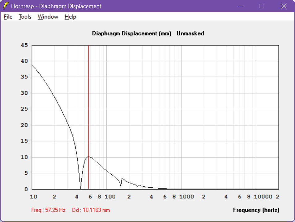

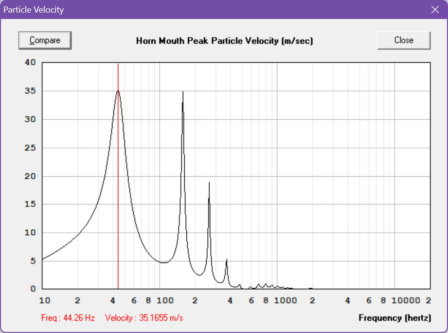

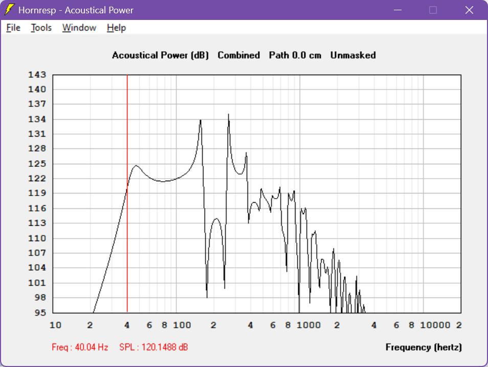

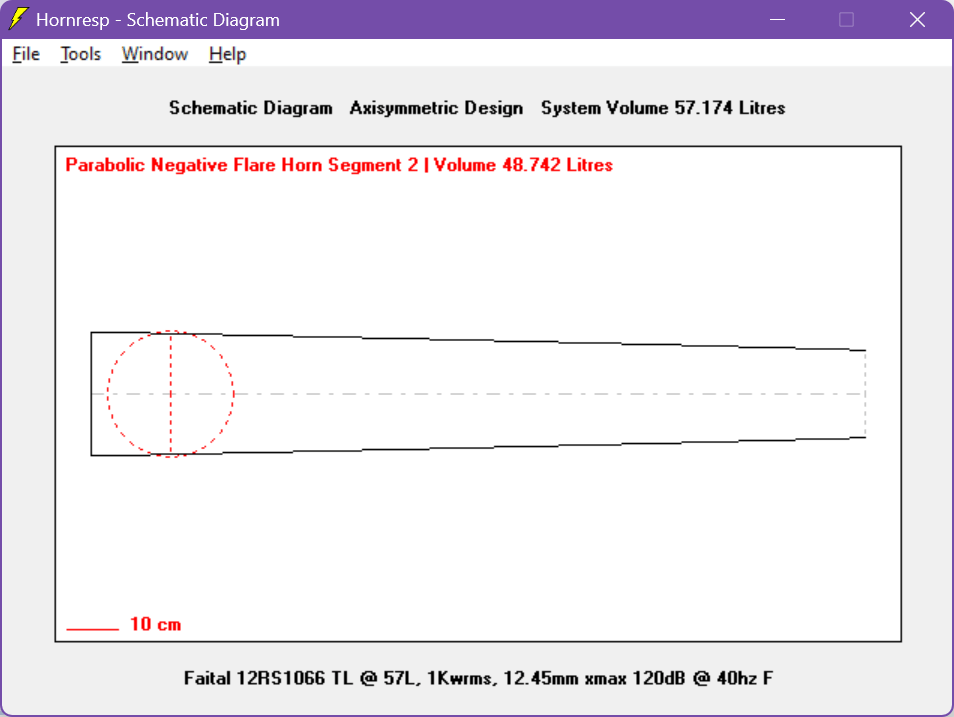

I thought 28L was unrealistic.I think your conjecture that Hornresp goes to quarter-wave behavior is correct, it requires a 54.2L box before calculating a Helmholtz frequency with an AP of 1000 and Lpt of 172 (172L total volume).
Various on-line calculators suggest much longer ports.
I did 120dB @ 40hz with a 44L TL.
