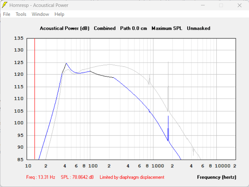

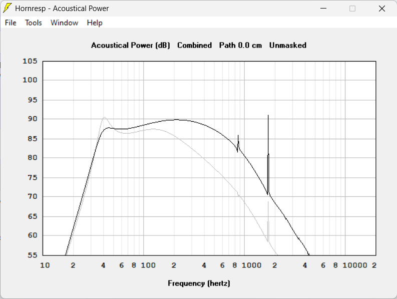

I ran the Eton MW12 through Hornresp, with interesting results: there isn't actually much difference in available SPL with the Faital 12RS1066 or the Eton driver, when driven from the Powersoft T602 amplifier.
First up, compare the voltage sensitivity - first image. This is with 2V into each driver, so the Eton MW12 is receiving 1w (2x 2ohm coils in series) while the Faital (8ohm) is around 0.5w. The voltage sensitivity matches, but the Eton is receiving more current.
Next, I used the following to compare them on Max.SPL on Hornresp:
  • Amplifier maximum output = 103V, which is the rated 1300w/ch@8ohm.
  • Driver maximum input power = 2x RMS power. 2000w for the Faital, 1800w for the Eton
  • Driver maximum excursion = rated Xmax. Faital = 12.5mm, Eton = 48mm!!
This draws a graph of the absolute loudest that driver+cabinet can go, within the constraints above. It's not the usual frequency response shape, because different limitations apply (excursion, amplifier voltage, driver power) apply at different frequencies.
On the 2nd image, the Faital is the grey line while the blue/black is the Eton.
Things to note: Below PR tuning, the Faital runs out of excursion quite quickly. There's also a small excursion-limited notch around 55Hz. Elsewhere, we're limited by the amplifier's output voltage. I'm not especially worried about the 55Hz - a couple of mm past Xmax would be fine.
The Eton is different. I included the red cursor to show that the Eton only runs into any kind of excursion problem below 15Hz. It could be run with a 20Hz HPF and be completely safe from mechanical destruction from the Powersoft amp. It will, however, have some thermal difficulties: around 40Hz, the maximum output is limited by the 1800w that we've allowed the driver to receive. NB - Eton suggest a mere 1200w "music power".
Playing around further, I notice this: in order to force the Eton to use all of its (extremely large) Xmax, you have to either use a really silly cabinet (200L tuned to 10Hz) or grossly exceed the rated input power.
If they re-did those Eton drivers with half the Xmax and the ability to use all of that excursion at sensible power inputs, they'd be on to a winner. As they are, though, there's a lot of wasted potential.

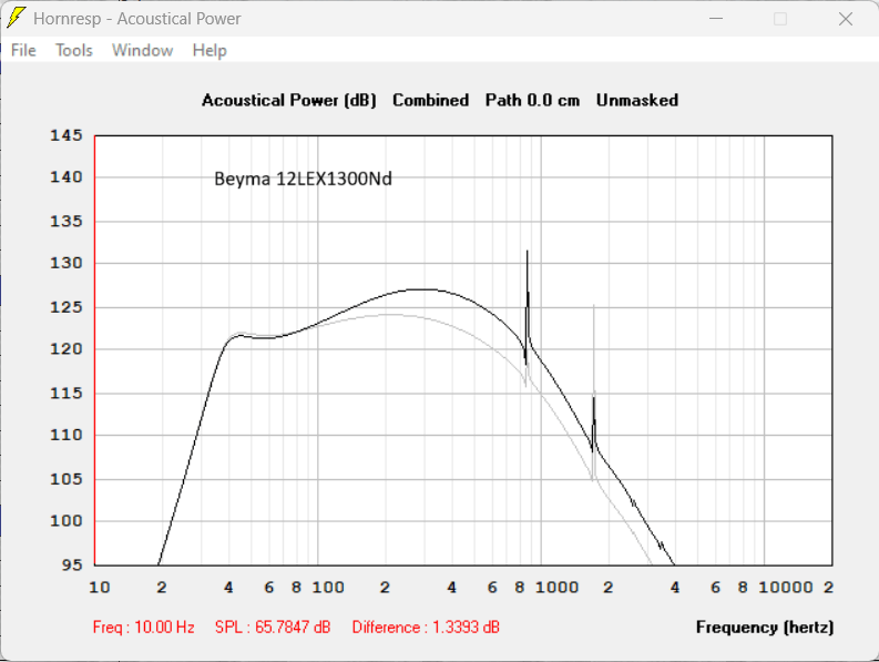

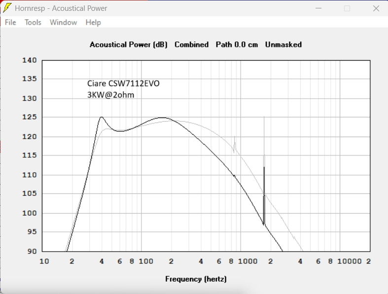

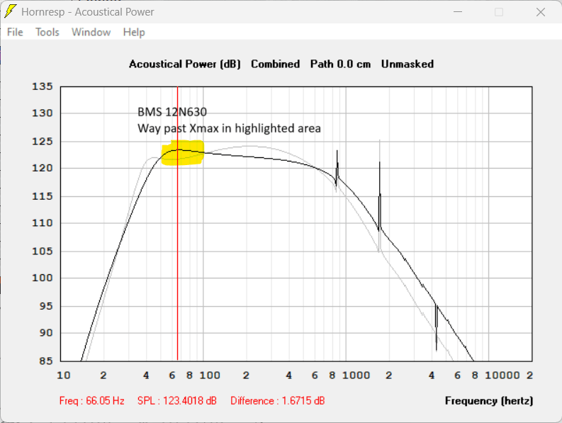

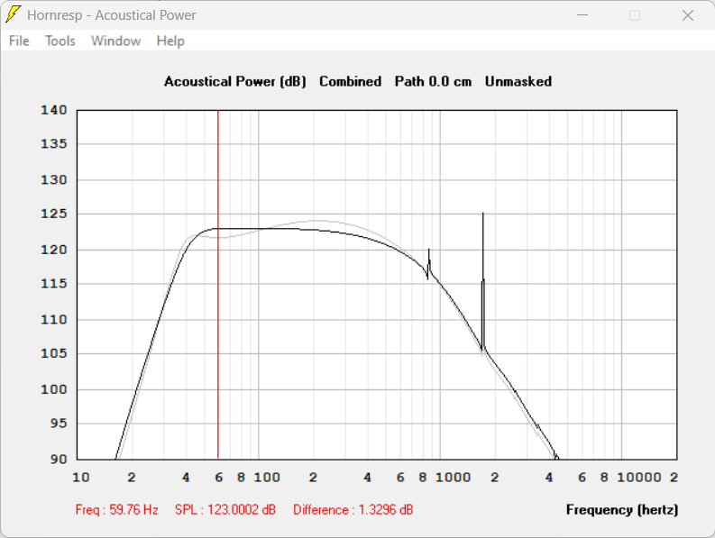

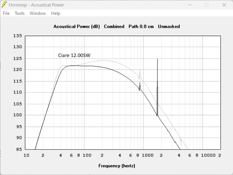

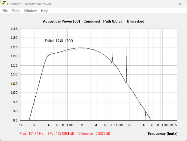

Some comparisons attached. In all cases, the grey trace is the Faital 12RS1066.
I went through a couple of websites and entered drivers I've heard of, and/or ones which looked like they'd do something interesting. I set the power input to match the T602: 1300/2500/3000w/ch into 8/4/2ohm. I'd prefer 8ohm (nominal) drivers, since it's easy to add more in parallel in a PA situation.
In order, the B&C 12FG100 has a slightly-flatter response than the 12RS1066, but the B&C rolls off slightly earlier. A reasonable alternative, but certainly not any better.
The Beyma 12LEX1300Nd is almost identical, but the Beyma has around 10% more radiating area, so uses less excursion. Rated Xmax is around 10% lower, though. 30% higher power handling than the 12RS1066.
The BMS 12N630 clearly doesn't have enough motor force for a box this small, resulting in a peak above the tuning frequency. NB - it's way past Xmax in the highlighted area.
The Ciare 12.00SW isn't bad, but loses out to the 12RS1066.
Ciare CSW7112EVO is interesting. It has 2x 1ohm voicecoils, so I simulated those in series for a 2ohm nominal load. When you EQ the 40Hz peak down a bit, the actual power input is surprisingly low across most of the range. With a 22mm Xmax, it has a lot of output potential, but (like the Eton driver in the previous post) doesn't make use of that in this cabinet. A larger cabinet tuned lower would be interesting.
The Faital 12XL1200 has slightly more cone area, equal excursion, and 40% higher power handling than the 12RS1066. There are small differences in the frequency response chart, but not enough to be concerned about IMO. It's possible that the higher power handling will mean less power compression.
If I was choosing from scratch, I'd probably go with either the Beyma 12LEX1300Nd, or the Faital 12XL1200. Both have more power handling than the 12RS1066, but neither offers significantly more displacement.
