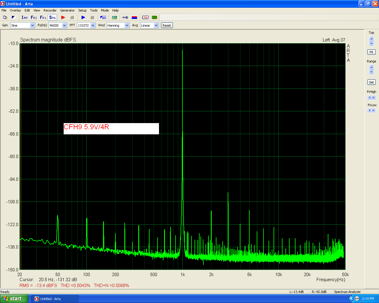

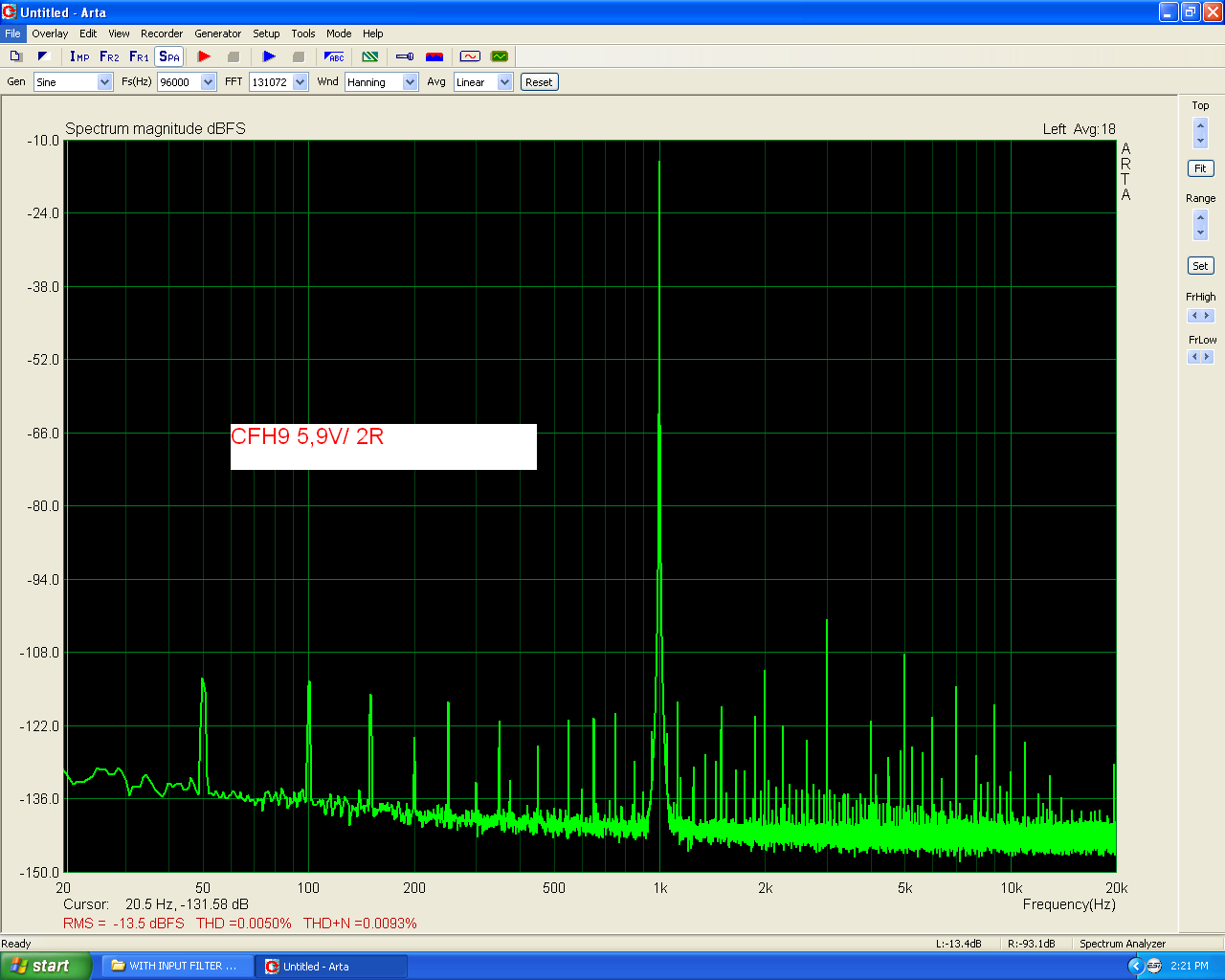

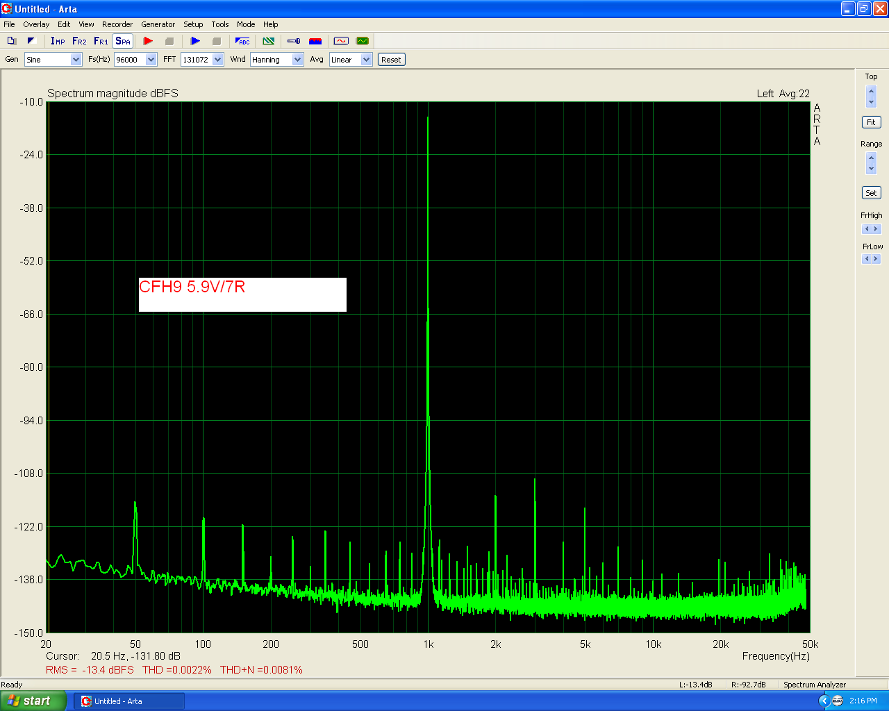

Testing the CFH9 using 7R,4R and 2R dummy load for comparison.

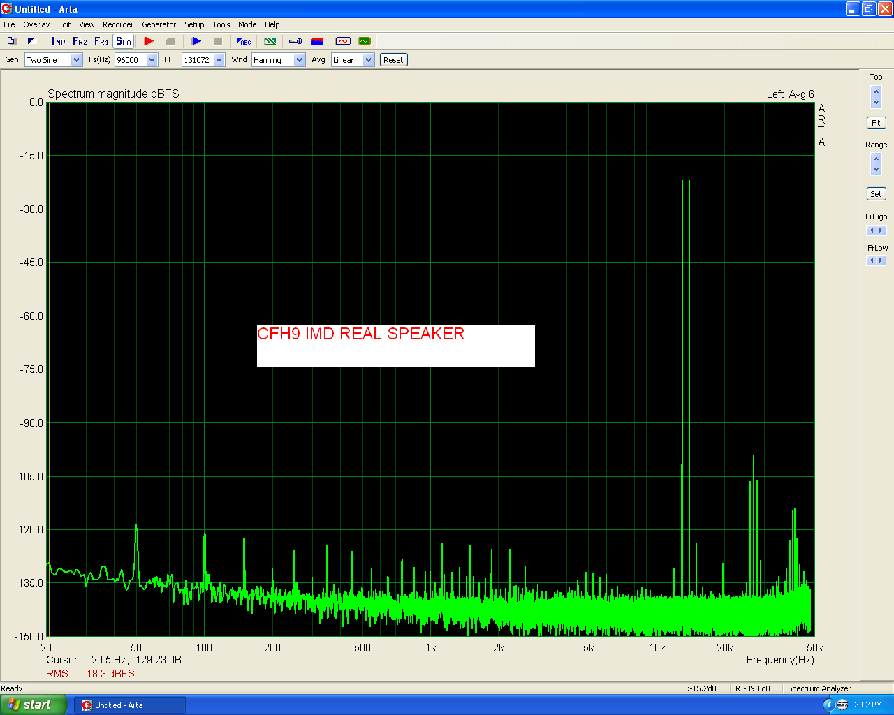

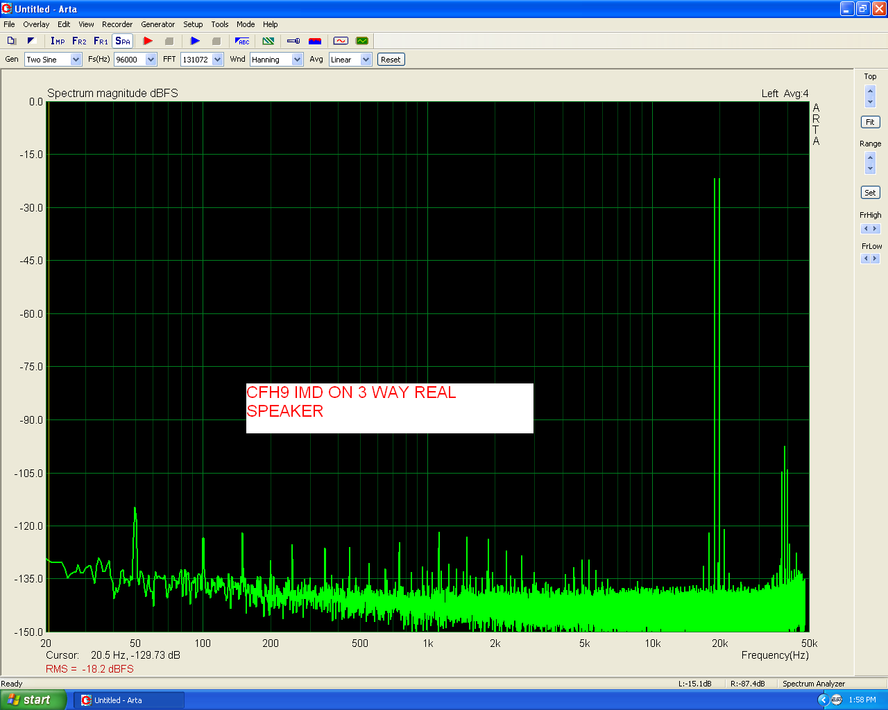

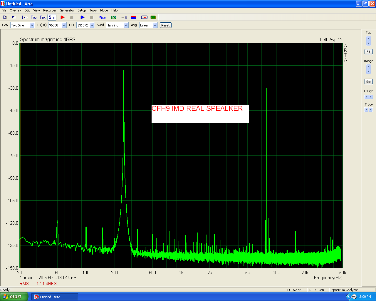

Testing CFH9 IMD using a 3way real speaker.
Thank you, Thimios for these measurements. To me, they appear excellent and I would say that if one listened to this amp the sound is very clear and transparent as 0.005% THD is indeed very low. I do not know how to interpret IMD figures are these good?

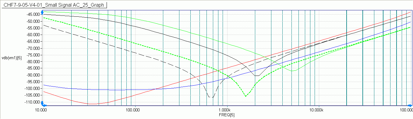

I mentioned that something was not quite right with my plots earlier. I found even the dc levels unpredictable. Then when I tried a cap multiplier it looked much worse. So something was not right ! Well after a long search, I found the problem. Some intersecting lines joined up when it was not intended and so resulted in all the problems. So you will have to trash all the earlier plots I put up. I'm putting up some new ones that seem more reasonable ! Sorry for the bother.😱

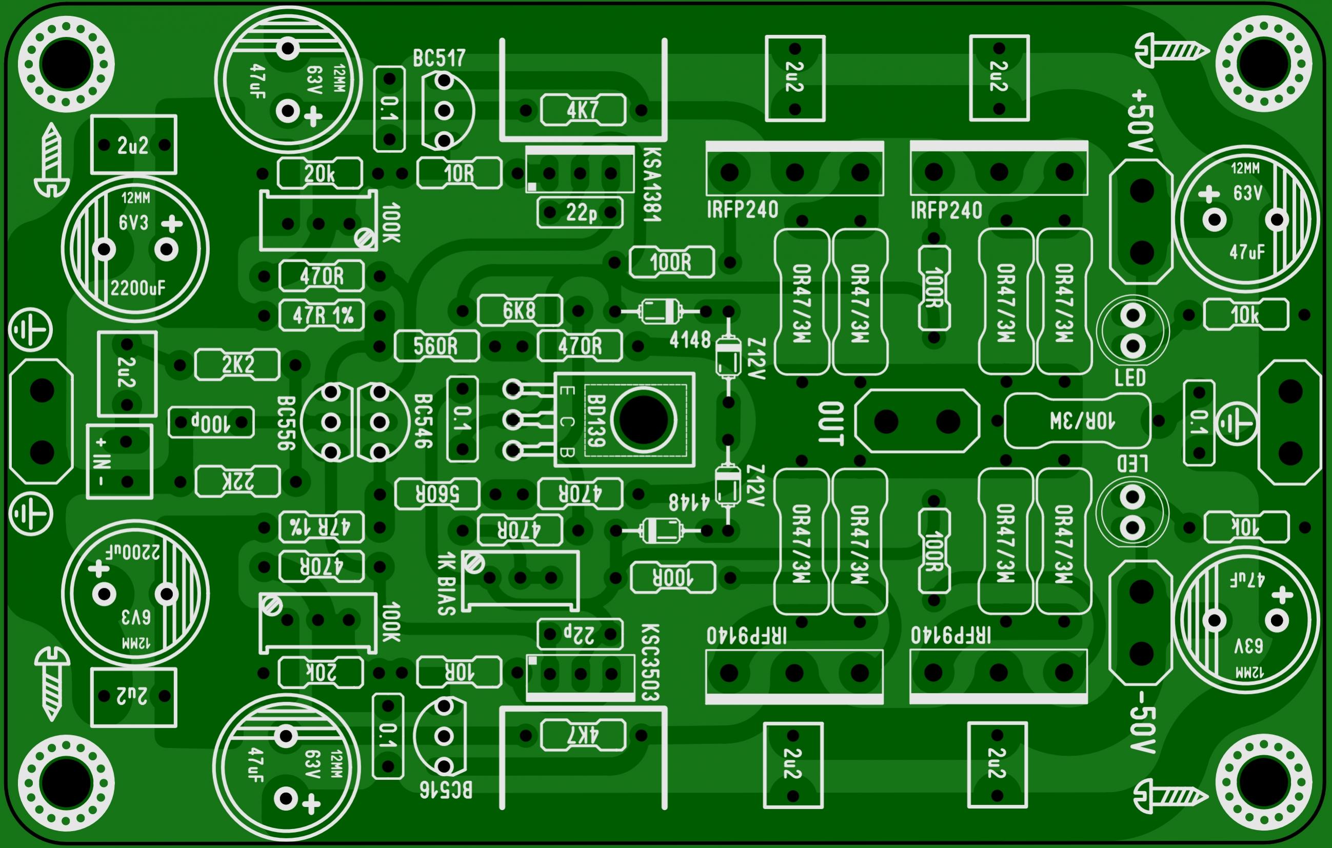

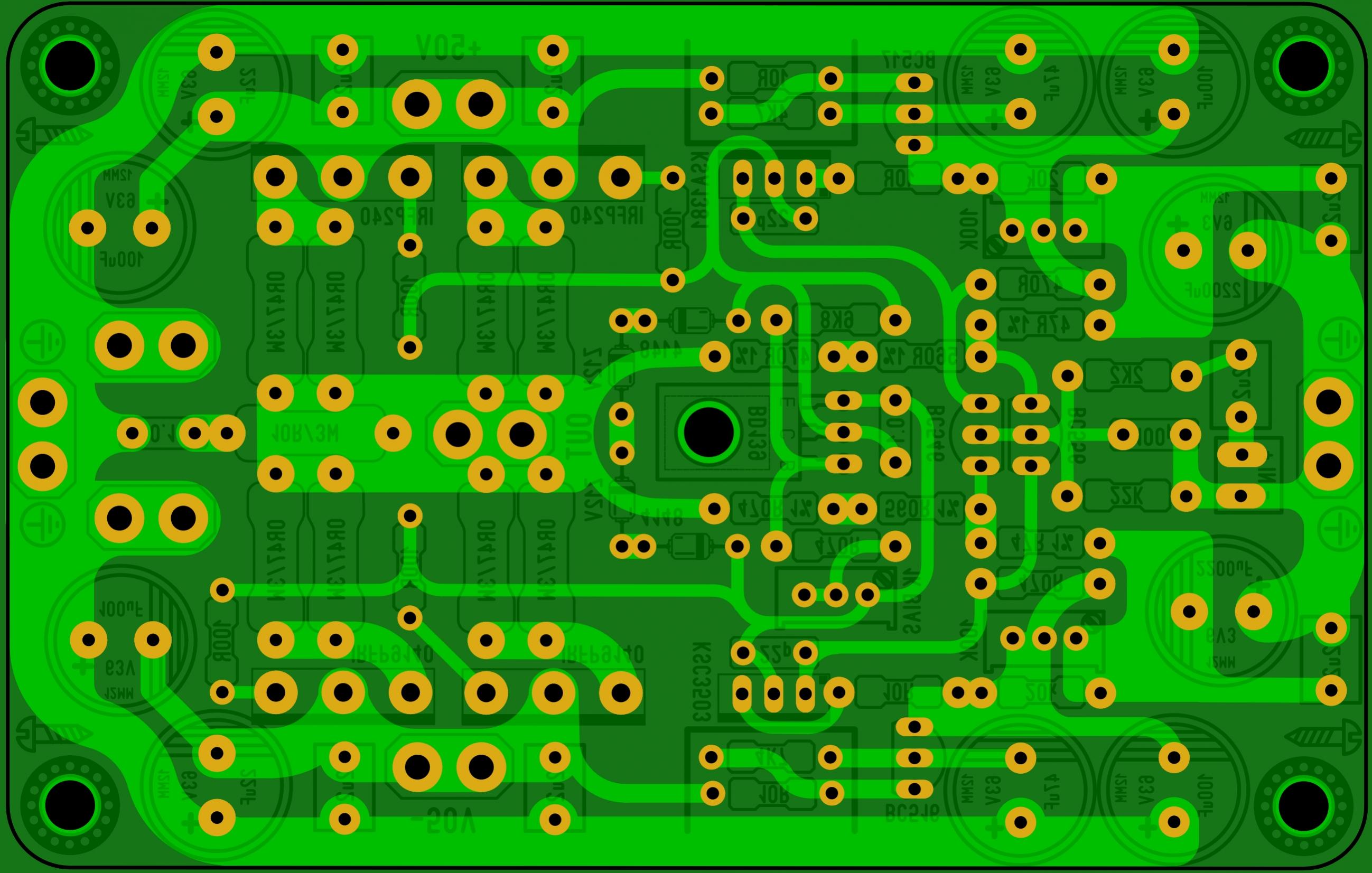

Thiago

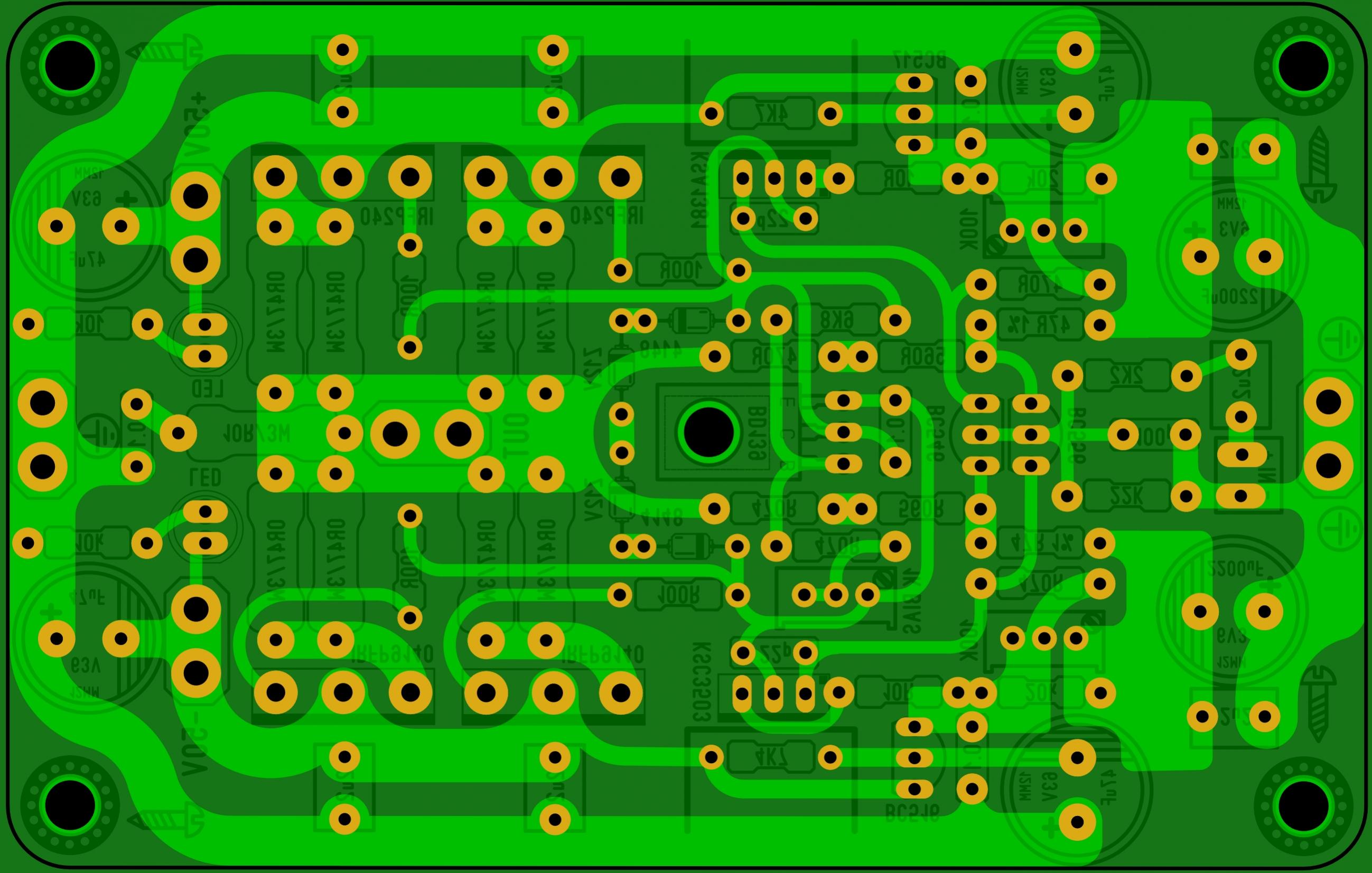

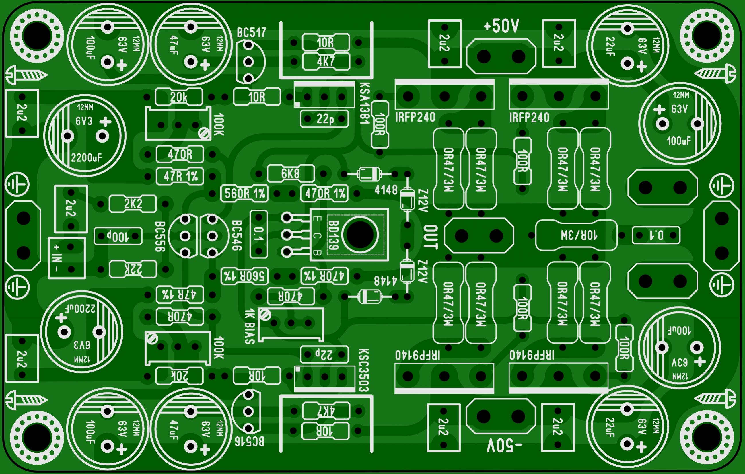

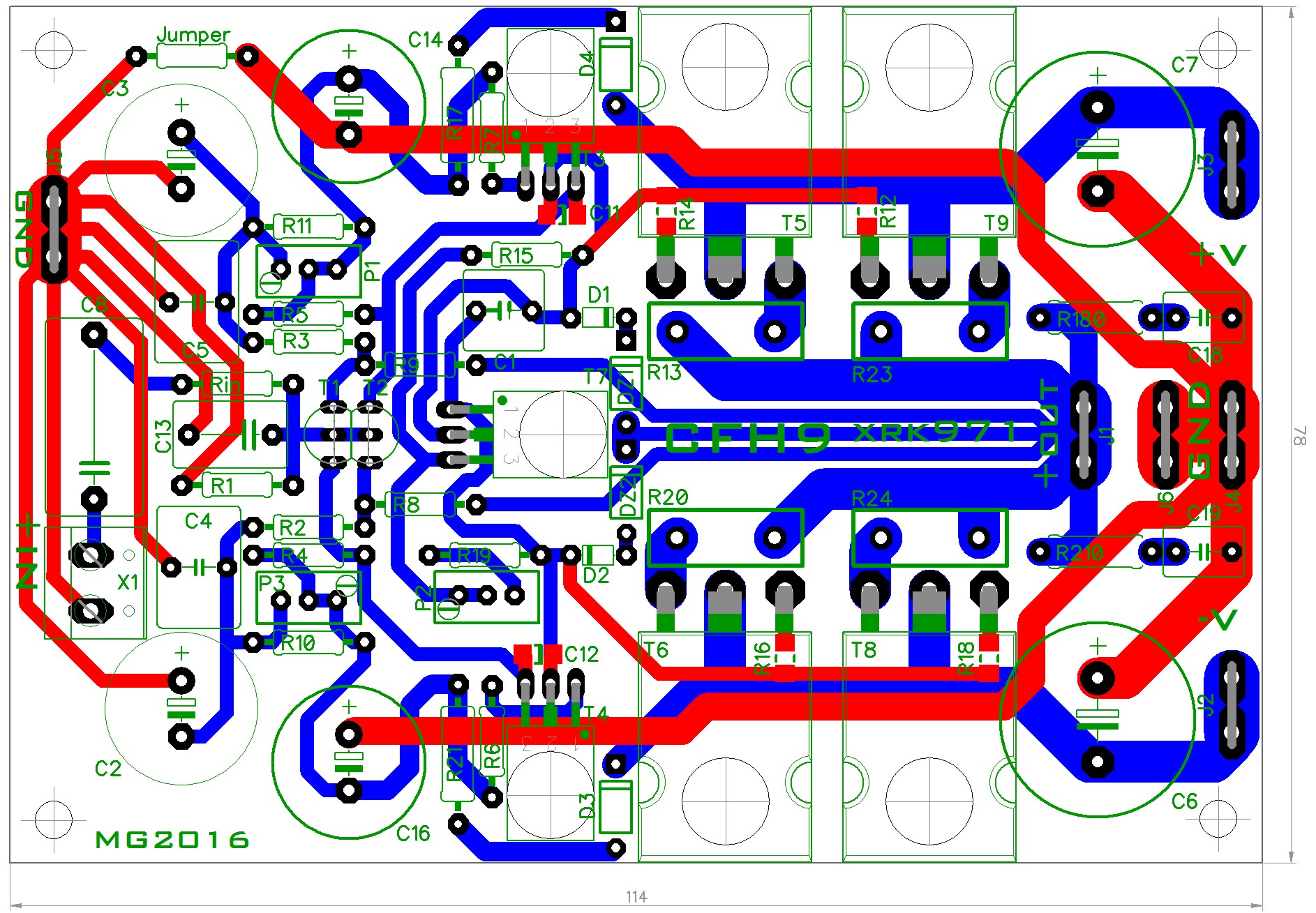

First and foremost, your layout looks great to me. I love the symmetry and the rounded traces - what layout software are you using?
Looking at the silkscreen, are the two ecaps on the left 6.3V ?
Why is are the two 47R resistors the only ones with tolerance markings (1%)?
Please mark the boards with the design name and (my pet peeve) the revision.
Thx,
Ben Franklin

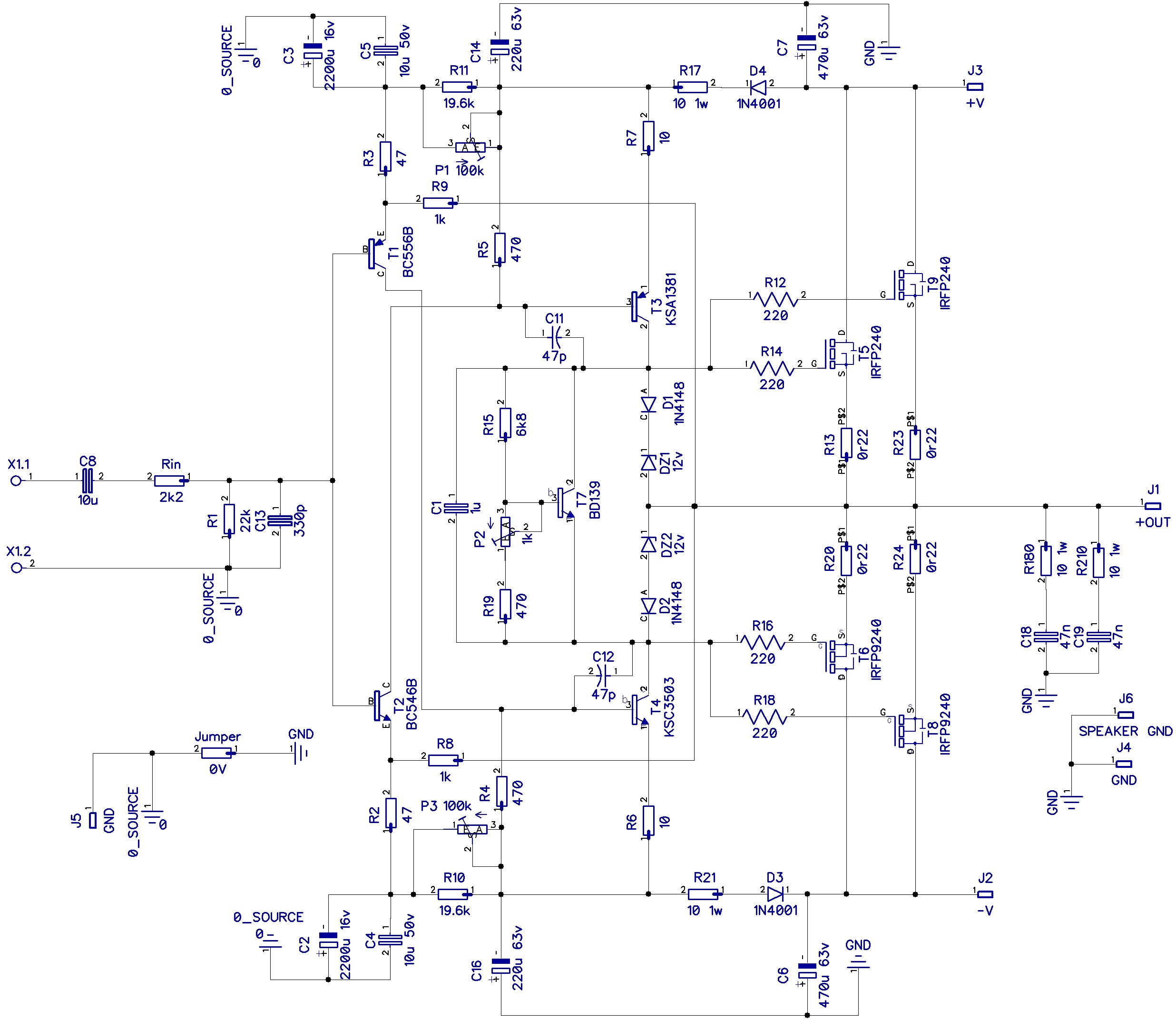

Hi thiago!
Great going! :up:
The cutoff frequency of the RC network at the bases of the darlingtons is 0.7Hz. For any frequency higher than this present in the input signal the darlington's output impedance will be too high for powering the VAS and input. That is, the VAS and input will start to electrically "see" the darlington transistors in the rails, when they absolutely should not. Adding a 100uF from the darlingtons' emitters to ground will make it invisible to the stages.
A 10R 1/4 watt resistor between the power rails and the darlingtons' collectors will help remove the sudden load on the transistors during charging of the emitter to ground 100uF capacitors at power-on.
...Looking at the silkscreen, are the two ecaps on the left 6.3V ?
Yes. They see less than 2V at any signal level so 6.3V is more than enough!
Because the amp's gain will be different in +ve slope and -ve slope resulting in increased even harmonic distortion if their values are not closely matched.
0.1% is more welcome!
Here are the corrected curves . Schematic used from post 884 ( CHF-V4).
Red curve - PSRR +ve rail with Cap Mx BC546B/56K/220uF
Blue curve -PSRR -ve rail with Cap Mx BC 556B/56K/220uF
Black with RC filter 10 ohm / 220uF
Dashed black RC with 10 ohm/ 2,200uF
Green with RC filter 10 ohm / 220uF
Dashed green RC with 10 ohm / 2,200uF
I get the following from simulation with parts as shown on the schematic in post 884
VAS about 3.15 mA ( output set at 100mA )
Input stage about 1.3 mA. Both transistors don't have identical current.
Output clipping at about 35 V pk into 8 ohms with a +/- 42 volts split supply .
Gain = 26.1 dB ( = x 20.2)
