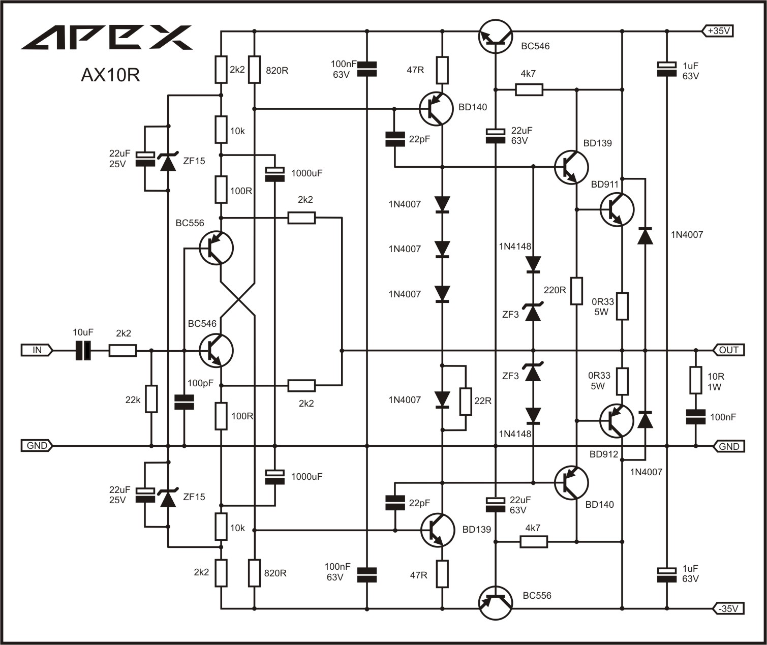

Hi Apex,
Very cool! Is that all it takes to add a cap Mx to protect the VAS and IPS? Can you show us how to size the cap and resistor? Is it basically setting the RC time constant to be well below AC line ripple of 50Hz/60Hz?
Would a BD139/140 be ok to use here or MJE350/340?
Yes BD139/140 or many others, and output can be BJT... DIY is fun you can do anything what do you want to do.
Here the cap multiplier transistors have very little voltage across them and fairly low current. So it's dissipation is very low. BC546B/556B or equivalent is sufficient . They also have higher gain than the BD series and so the 'multiplied cap' is greater. If I remember right the effective capacitance is hfe* Transistor Base capacitance !
In that case, the BC550/560's I have have even higher gain than my BC546/556.

Adding cap multiplier is really good idea, low noise LDO combined with shunt regulator is even bolder step towards better PSRR. Not to mention using advanced CCS wherever clear and constant high impedance current source/sink is needed.

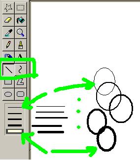

Today I discovered something... bad news, my eyes are not good, many times going back and watching some of the pictures added in this thread to rethink things.. and only now I saw those very very thin lines and ellipses in those amp pictures...
Thimios, can you please increase the line thickness, if you use Microsoft Paint program then please change according to attached picture so we with a bit older and lousy eyes can see better, it makes discussion easier when something is pointed out in pictures.

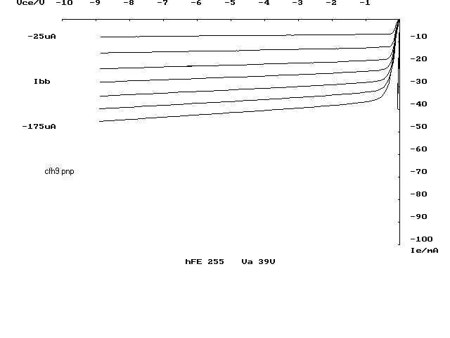

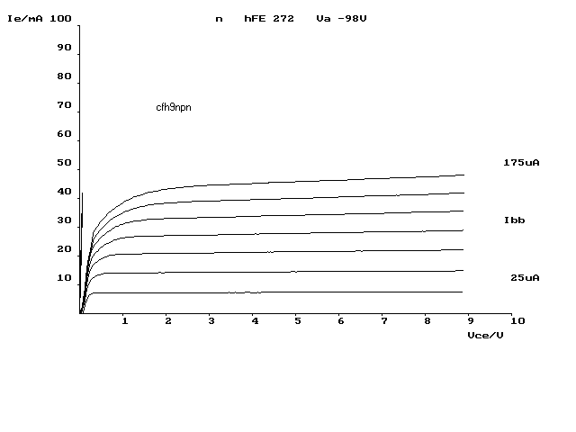

How close matched are input transistors that used in this amplifier.
You have a curve tracer? Cool!
All I can do is match Hfe.
That keeps thermal drift low when tied together but matching curves gives ultimate low HD performance.
Matching hFE is exactly what you need to do. Matching Vbe doesn't help you at all, and with transistors from the same lot that match hFE, the Vbe will probably match as well.
Using a curve tracer to match parts would be one unpleasant job. You could use that to add some extra verification if you wanted.
