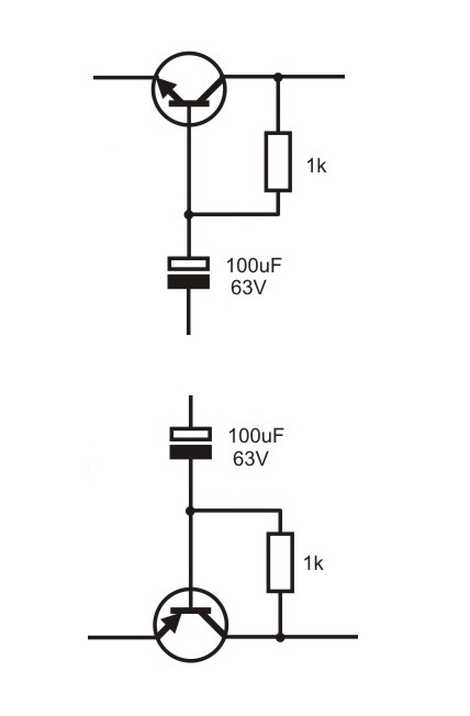

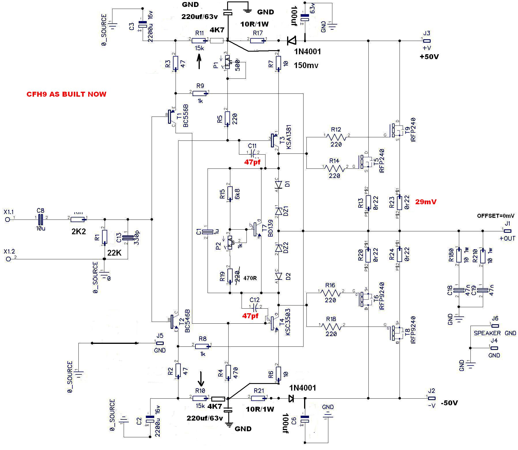

...That means, when the audio signal enters the VAS stage T3(T4), these transistors must have both base and emitter referenced to the same + and - rails, but when adding a 10R and another big electrolyte on the other end of the 10R, the VAS transistor has 2 different references with respect to the signal, this is suboptimal...
This is what was happening in the original layout. The VAS base-emitter 470R resistor was fed from the capacitor but the emitter 10R resistor connected to the dirty rail just before the filtering.
In my last attachment you can see the VAS's both emitter and base are referenced from the same points, that is the rail voltage at the supply pin of the decoupling capacitor to be added Just After the diode and the resistor (point A and B).
Also, as the signal at VAS bases are + and - referenced, I think it is even more important to keep the references steadiest and most free of hum for the VAS/input. Shorting the resistor will do the opposite.

Shaan i must mention some strange things in the vas stage. Sometimes measuring the vas current in the 10R i see that isn't stable from the start to end, sometimes i see big difference . When i had tried 22K(R10,R11) i had seen 600mV d.c offset.The resistors are for creating a CDRC filter in the PS rail to filter out more ripple before powering VAS/input. The diode is added to prevent VAS/input PS rail from sagging during loud transients.

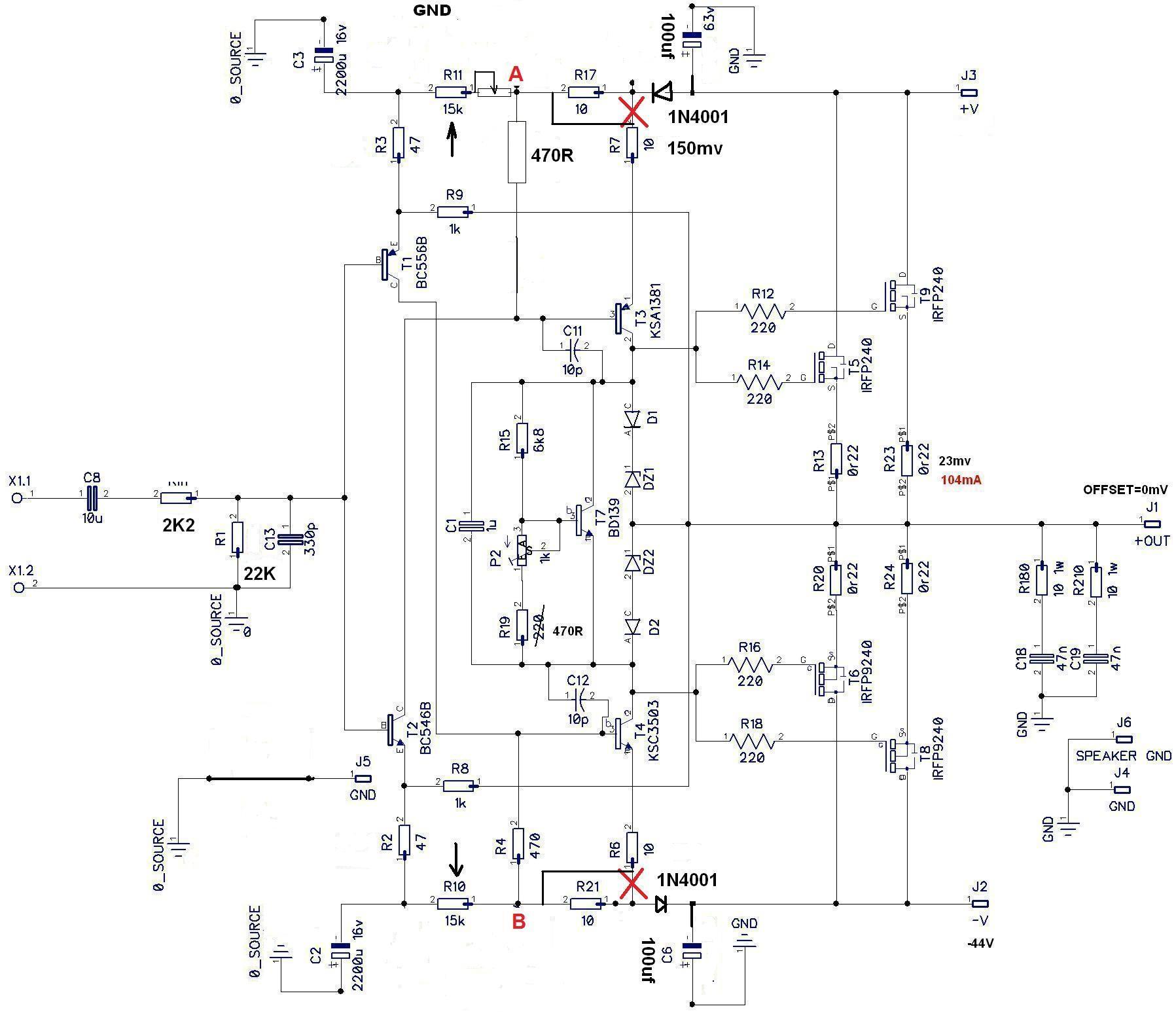

These are the three schematics in the first post that shows the right place for P1. In CFH9 PCB it would be in series with the 15K/18K resistors. I don't know why this wasn't done in the chosen schematic.

Yes indeed and I fully agree, we still need those R17(R21) 10R rails filtering resistors but moved to a location before VAS emitter and base reference points to keep it clean from OPS dirty voltage!

Current through these two resistors can't be and don't need to be perfectly equal in this amplifier for zero offset at output.

Also put a trimmer with the negative side's 15K as well for best control over offset. These trimmers will be able to fine-tune VAS bias to some extent without changing VAS emitter resistor so you get two operations in control in one mod.

Don't forget filtering electrolytes connected to point A and B, I think shaan mentioned about few posts earlier.

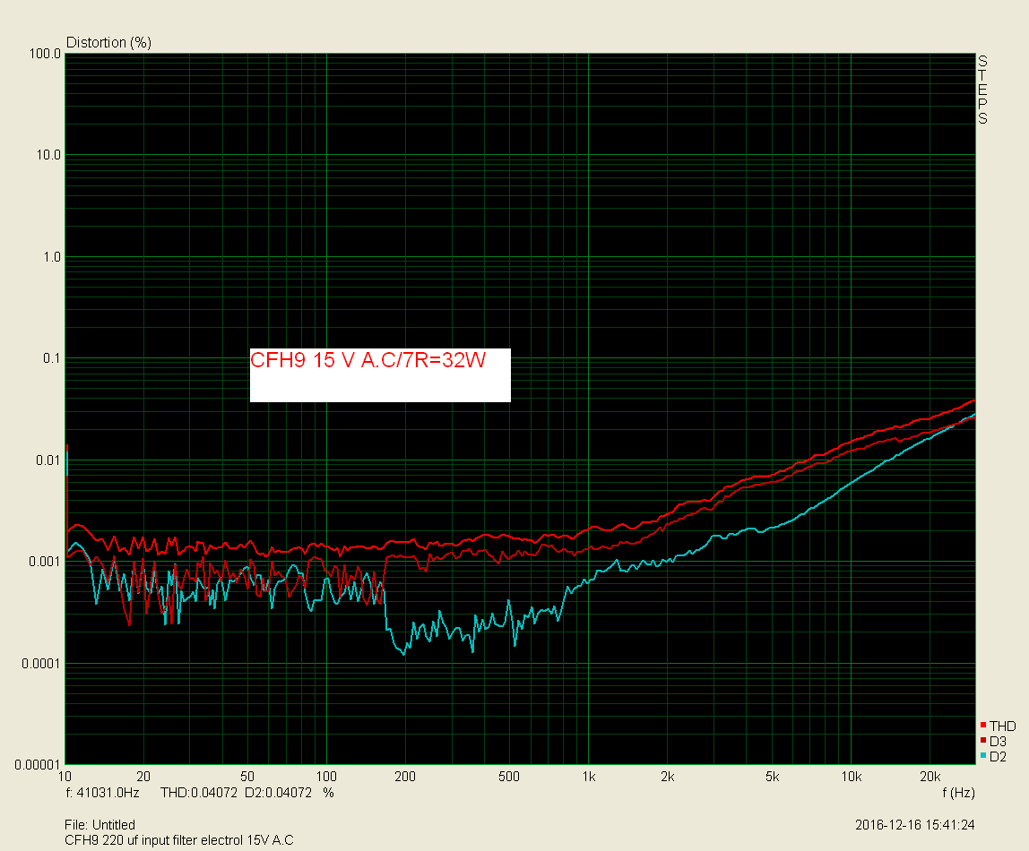

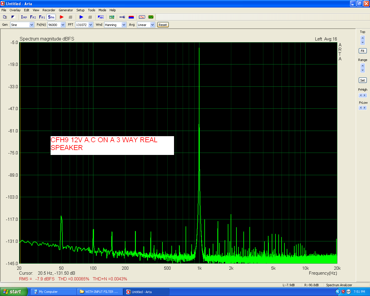

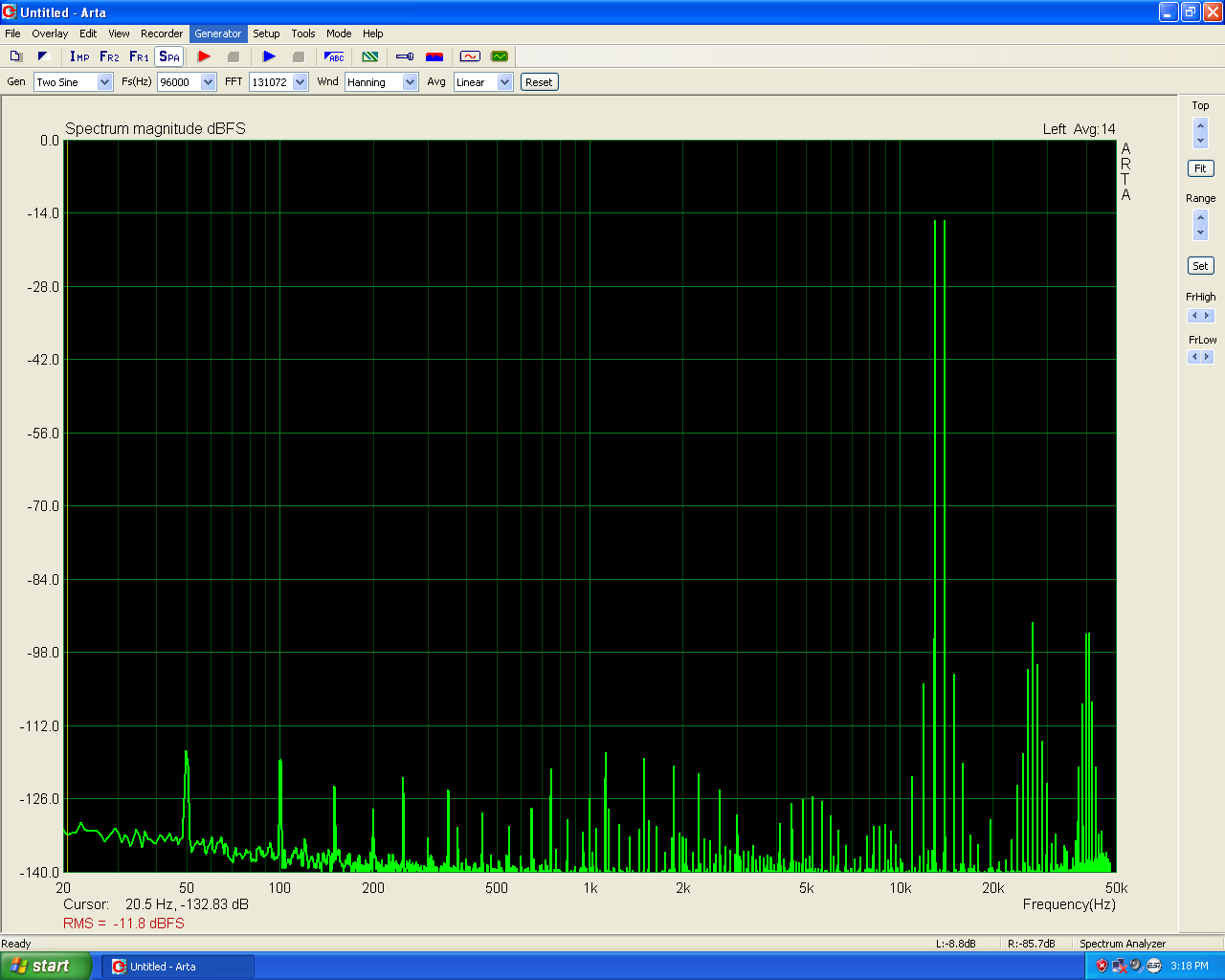

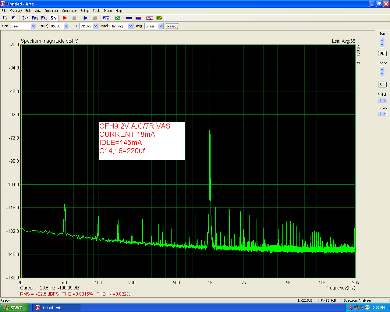

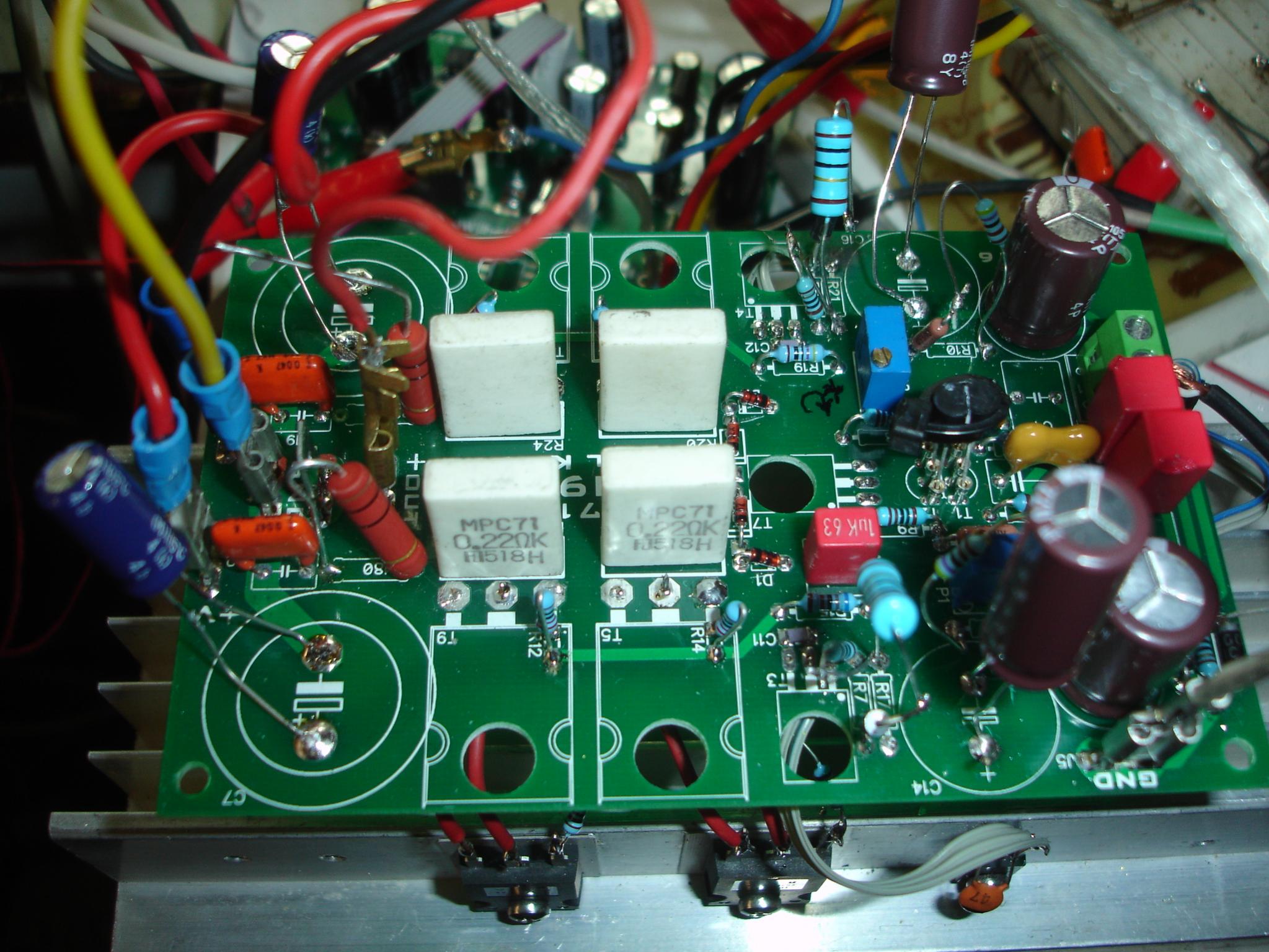

Here is the amplifier as built now.

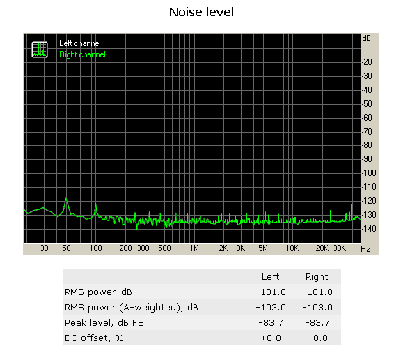

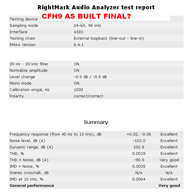

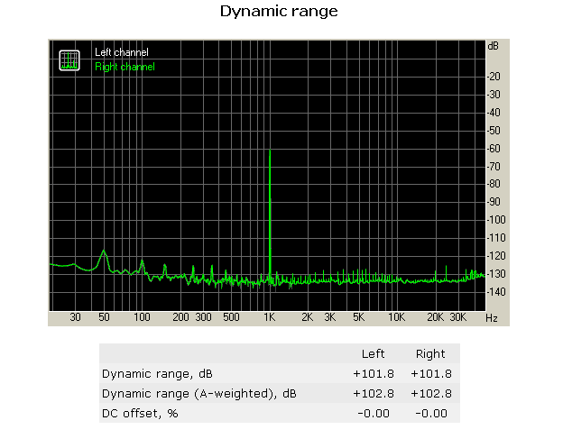

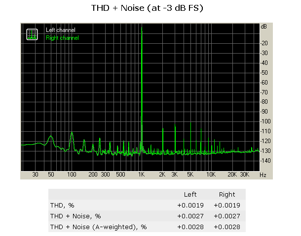

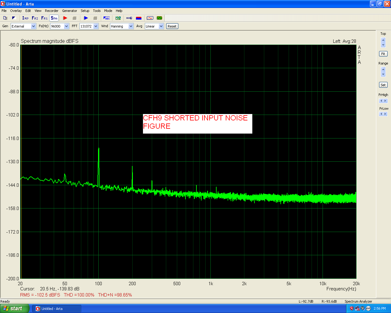

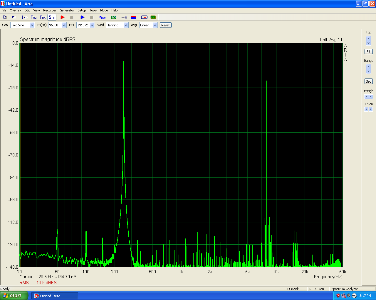

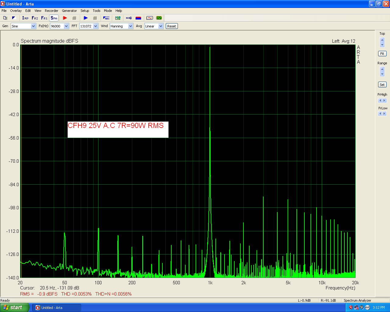

CFH9

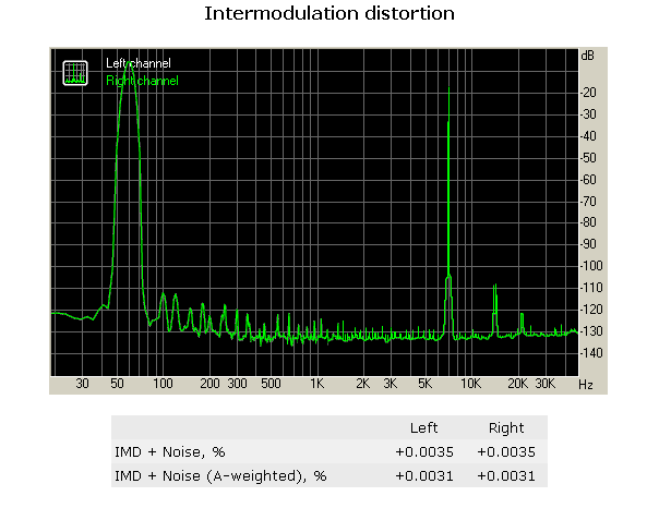

Using RMAA.
Not bad at all for a simple cheap CFA amplifier!
Using RMAA.
