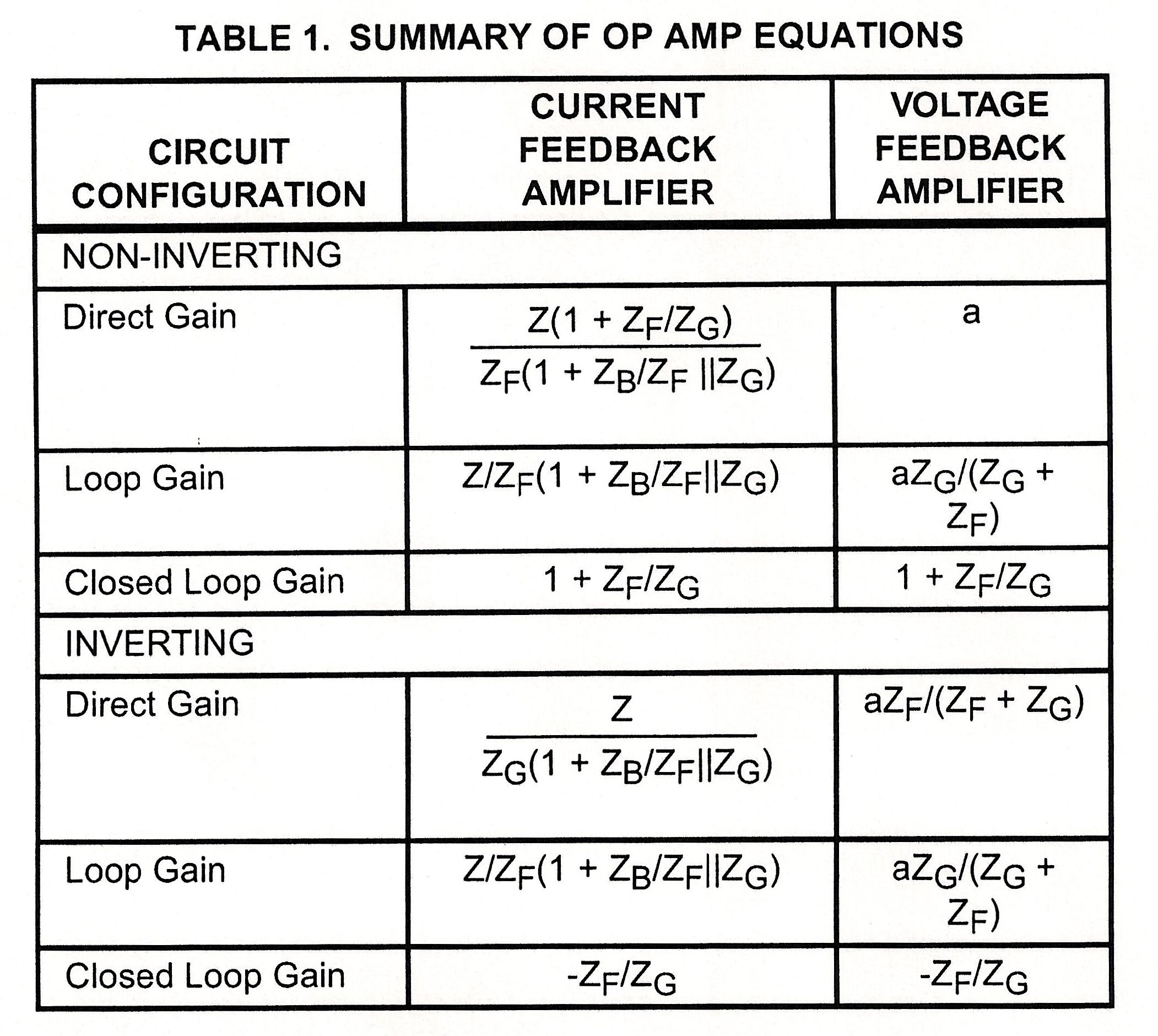

The differences can also be shown this way -->
Thx-RNMarsh
There actually is a lot written on the topic. I would suggest, instead of speculation and questions, we do some reading by true experts in the area who are designing IC CM OpAmps. You can start with some App Notes from Intersil: # 9420.
This is an excellent way to illustrate exactly my point above. In that bunch of equations, just consider a CFA with ZF>>ZG (as in any power amplifier with a gain larger than 20dB) and see what you get. Hint: nothing but exactly the VFA equations 😛.

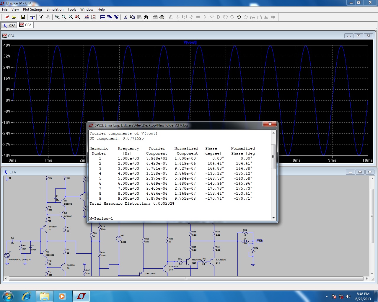

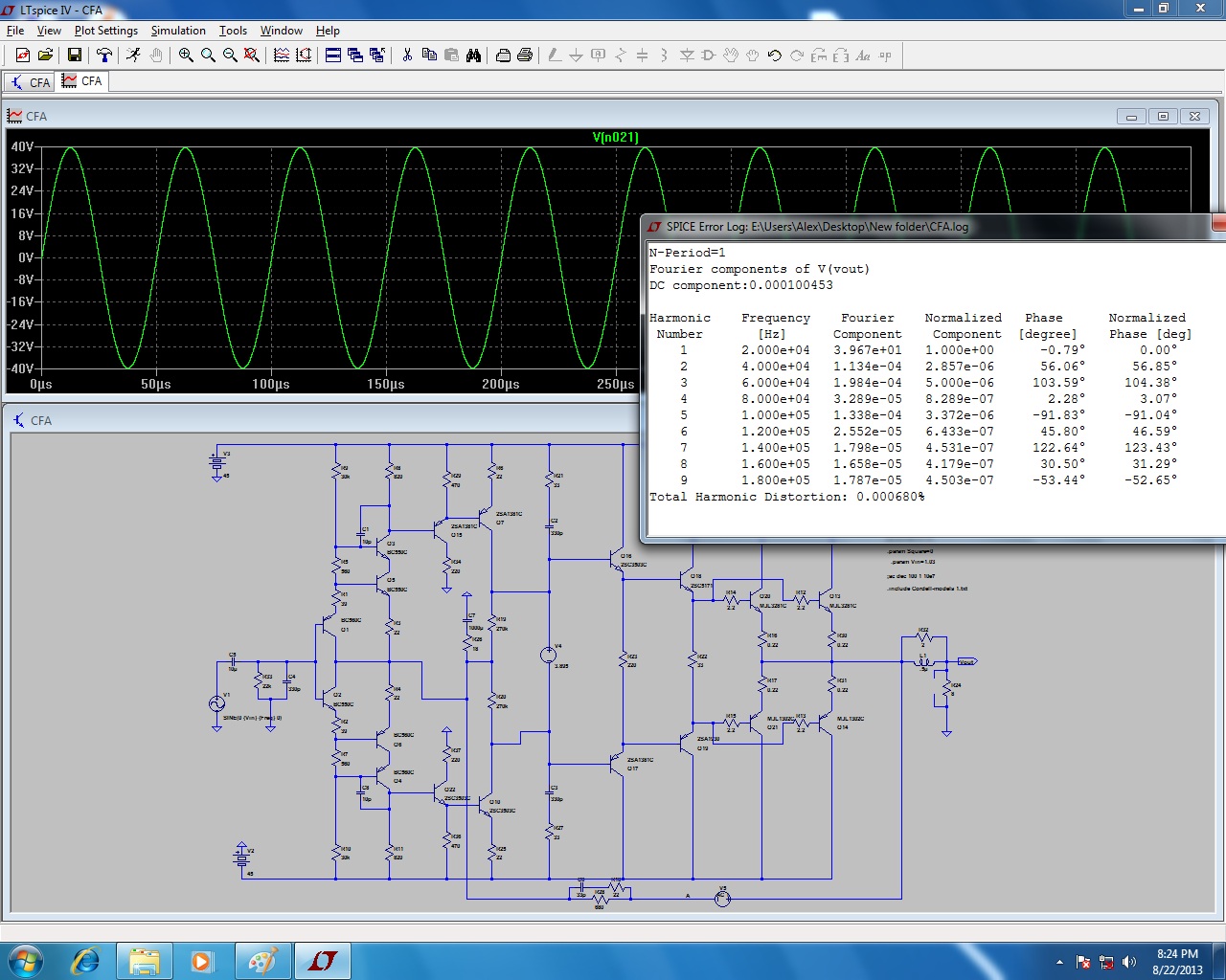

Some further proof of good performance from CFA.
Simplified schematic for now, Ill include the servo and optimize as I recall the exact details as the design is close to 20 years old. These are sim results although the real amp showed figures not far off. The cascodes can be ommited if high voltage transistors are used and THD is improved without them.
THD20 at 100W .000680%
THD1k at 100W .000202%

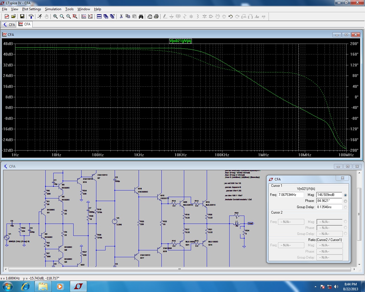

Phase margin 84 degrees
Gain margin 14 Degrees
ULGF 7 Mhz
I experimented a little with Edmonds DTMC and indeed performance is bettered but Ill only post details after confirming that the amp is stable using it.View attachment 367265
