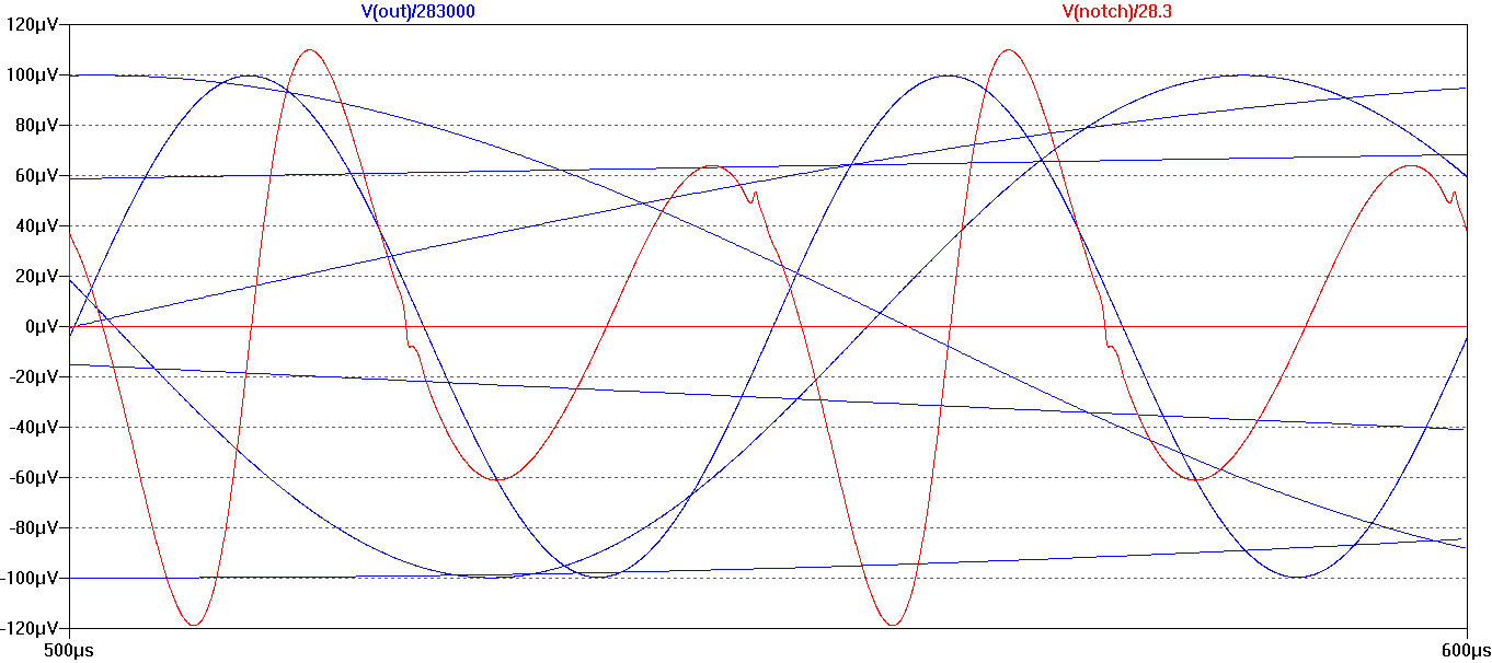

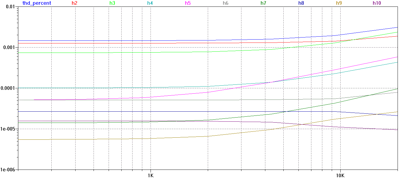

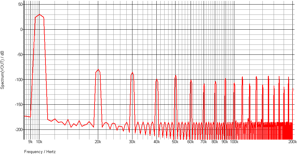

A simulated THD graph at 10Khz and +29.54dB output level ,
that is 30V , on a 8R load , output devices are biased at 78mA/pair.
Numbers are quite good with H2 being in the vicinity of -110dB
below the output level.
ULGF is 8MHz , higher than in the LTSpice sim , surely due
to use of different devices and models.

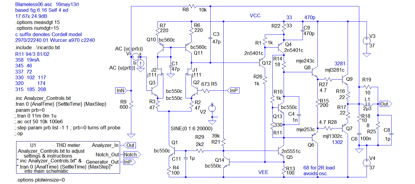

For a VFA at 50W 8R 100W 4R, the attached circuit sims at <1ppm THD up to 20kHz and is good for overload/stability/loads bla bla etc. It has 16 active devices. It's simplicity is deceptive. I've agonised over every single component over some 30+ yrs. I'm still learning new stuff about it .. most recently, from Dave Zan, about the true effect of C9 which I've yet to investigate fully.
(Most) more complex amps of similar size are far from that level. It's close enough to stuff I've burnt solder over to be confident, given the right PCB layout, decoupling & earthing .. it will have single digit PPM THD in the audio range.
IMveryHO, I don't think a more complex 50W 8R VFA is worthwhile. For 200W 8R, things are much more complicated and something like astx's 2stageef-high-performance-class-ab-power-amp-200w8r-400w4r may be required. But I've not designed or built anything of that size.

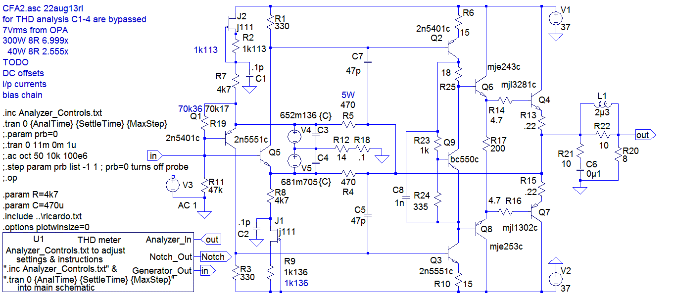

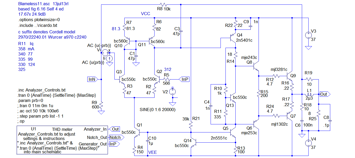

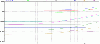

This is my CFA offering. It started of as something for Dave Zan .. then I realised that JLH had several designs of almost identical topology. LC's VSSA is also very similar.
  • I haven't used VSSA cos proper THD analysis needs EKV MOSFET models (hint hint grovel grovel Guru Cordell) The DC design is VSSA with FET CCSs on the i/p. I'm not sure how to sensibly tweak them in production .. or even for a one off.
  • V4 & 5 are just to charge C3 & 4 for the THD analyser to work easily.
  • C1 & 2 would be large in 'real life'
  • The design has very low i/p noise, basically just R12=14R if the transistors are good. But for Dave Zan's supa LN application, it should only 2.555x gain rather than 17.67x as here. R12=39R R18=110 for Dave Zan's treble amp
  • It uses 11 devices.

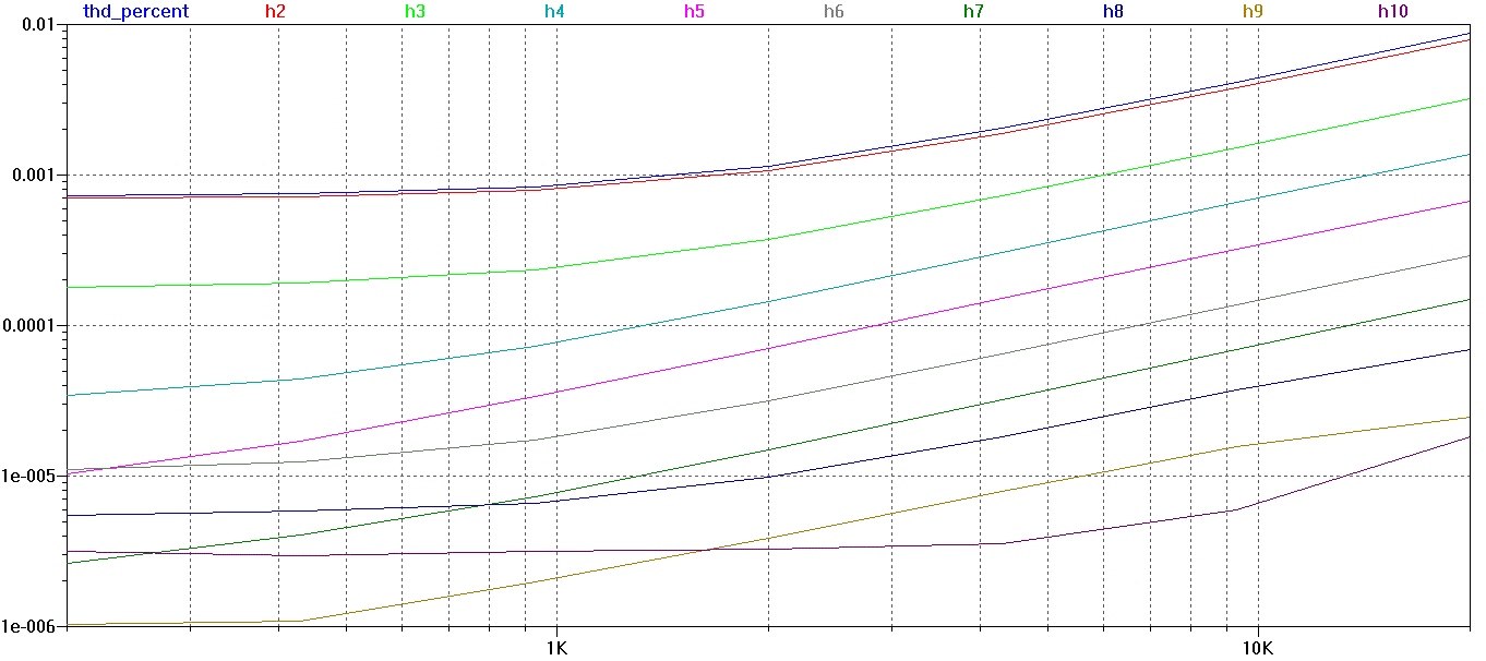

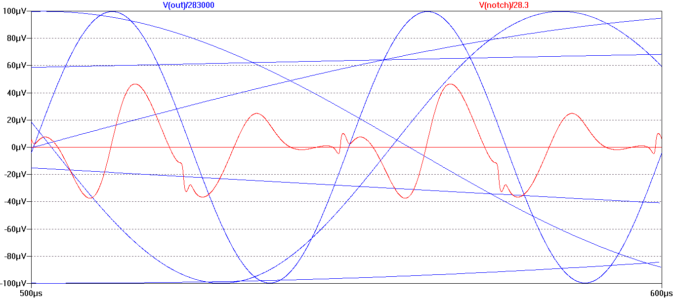

CFA2-20kHz.gif shows 2 cycles of 20kHz at a level of 0.01% THD to give some idea of scale for the red THD residual.
I've not fully looked at this in SPICE world and more importantly, have never burnt solder on anything similar.

I plead ignorance, somebody please come up with an example of commercial audio power amp having 8MHz ULGF.
7-8MHz ULGF (and in particular for a bipolar output stage) is way to high to be of any practical importance.
Agree that it seems to have no practical importance for audio amps
given that it s not like we start with considerable loop gain at the
frequencies of interest.
The good THD ratio is firstly due to the linearity of the circuit
at OLG not to its eventual speed wich is wrongly assumed by some
as being parameter that can add or be traded for more linearity.
As for commercial amps Accuphase is a proponent of these
kind of amplifiers but i have no clues about their specs
let alone a parameter as ULGF that is never speced
even for the ubiquitous VFAs.

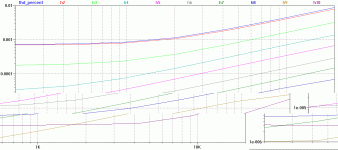

I attach the simplest VFA design which might meet the approval of this august company. It has several well known (??) THD mechanisms which are addressed in Blameless6 but I've a lot of experience, both 'real life' & sim, with it.
It uses 13 devices.
_________________
Please excuse me for posting evil VFA circuits on this thread but I feel the discussion shouldn't be about fudges to either VFAs or CFAs. Instead, they should be the best possible for a given level of complexity.
I can't claim my CFA example is the best possible but I will claim at least long familiarity with the 2 VFA designs here.
_________________
The simple VFA has about 1/2 the LF THD of the CFA but 3x more at 20kHz. It uses an extra 2 devices.
As the CFA is symmetrical, we can only add '1' extra device in the forward path if we use these extra 2 devices.
I'm hoping this thread will tell me how to best use these 2 bits but I would be disappointed if adding an extra device didn't reduce THD by at least 10dB at all frequencies.
This would give the simple CFA the lead over the simple VFA in all respects.
_________________
Lastly, though I've offered my caveats about not having burnt solder over the CFA, the real caveat is that in my previous life, I was a true Double Blind Listening Test guru (I was only a pseudo electronics/mike/speaker guru 🙂 )
I have never carried out DBLT bla bla on CFA vs VFA. But at a given level of THD performance, the limited tests I've done on (VFA) amps suggests that simpler designs sound better.
It is likely the simpler amps had better behaved overload and stability characteristics.
I share Bob Cordell's suspicion that these may be the most audible characteristics of amps rather than ppm THD.
