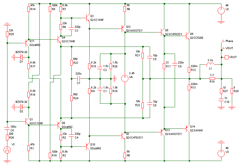

Simplified schematic for now, Ill include the servo and optimize as I recall the exact details as the design is close to 20 years old. These are sim results although the real amp showed figures not far off. The cascodes can be ommited if high voltage transistors are used and THD is improved without them.
THD20 at 100W .000680%
THD1k at 100W .000202%
Phase margin 84 degrees
Gain margin 14 Degrees
ULGF 7 Mhz
I experimented a little with Edmonds DTMC and indeed performance is bettered but Ill only post details after confirming that the amp is stable using it.View attachment 367265
It looks like the Bonsaï NX amp topology if you remove the cascode on input stage, the buffer before the VAS and one output driver.... Even the same transistors are used....

The schematics arent partial or there wouldnt be any results would there. What is not shown is a feedforward circuit that is now used with updated design.
Are you not familiar with shunt comp ??

This design uses the beta enhanced vas, same as the blameless for high loop gain.
Im not familiar with Revox amps but this is like I said a optimised but typical CFA design when it comes to audio. There is a dozen other manufacturers that have used very similar designs.
At its time no typical blameless amp could come close in performance. The use of TMC and TPC changed that but Im getting some interesting results with Edmonds DTMC which potentially evens matters again.
Bonsai has a design in the pipeline he claims has around the same performance. I have no doubt he can match it, there is nothing to it.

I ll give it a try in another simulator , here your schematic ,
not sure i drawned it correctly , as pointed by Waly it is quite
difficult to sort out the components values given the lacking
definition of the picture , i also add said Revox B750 wich date
back from the late 70s.

C1 (10m) and C7 (220ufd) are a deal killer.... all the circuits in this time/era required a large value cap(s) somewhere to stop Dc from the output. The CMA had already been published as a design concept but it could not be made in IC form until new processes allowed. So, you only had descrete designs then.
The direct-coupled design and the dc servo were conceived to eliminate this practice. Lets move forward to the present time (2013).
