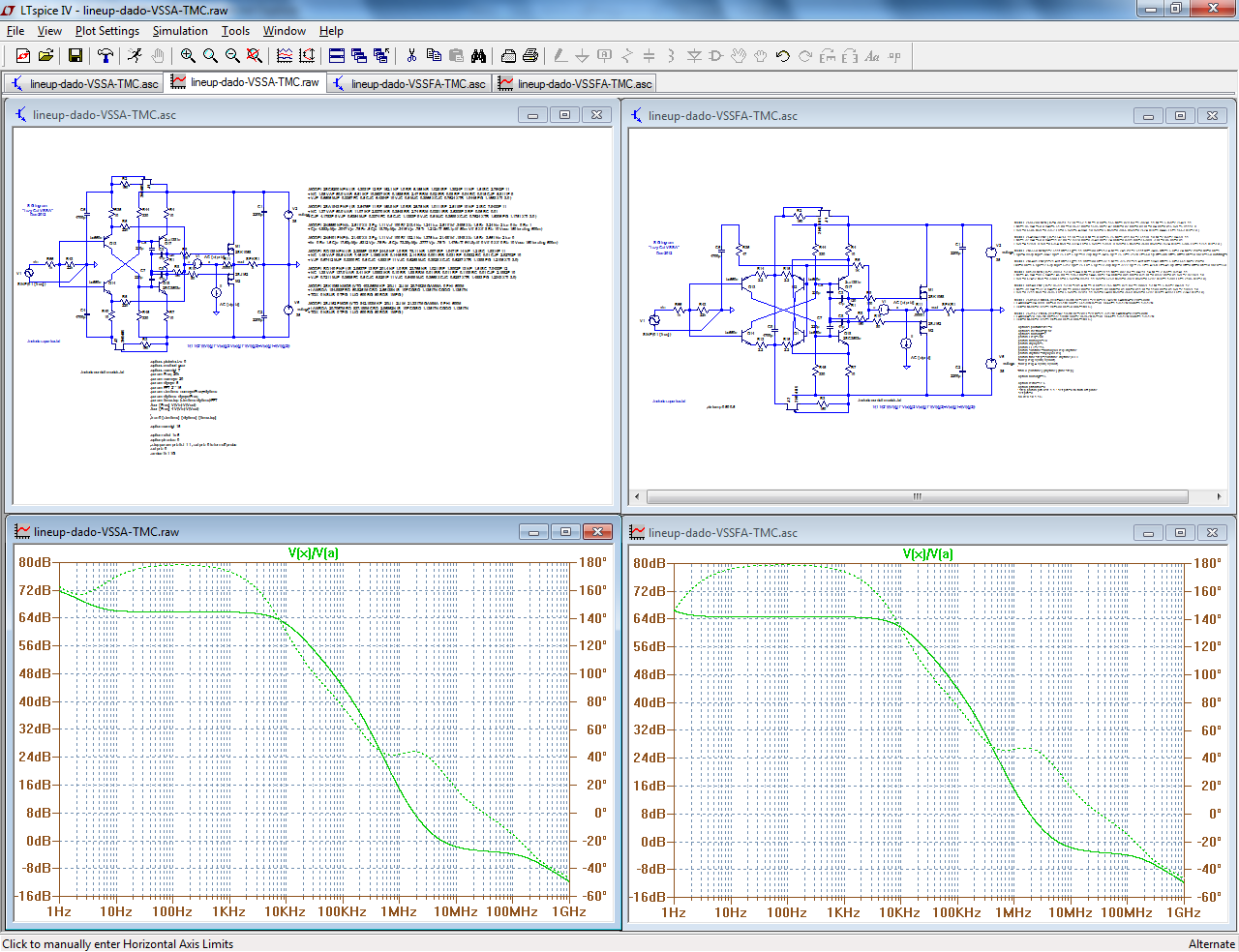

I tried my best with those sims. Everybody with minimum of knowledge knows it is impossible to make an exact mirror of a CFA to VFA (and vice versa). I tried with the few time i had (i said quick'n dirty) to bring the closest version i could, the one with the best possible results for VFA and not the contrary as i was accused (if you set the input gain equal, you cannot keep the VAS close enough, in current/gain/bandwidth and it is 10 time worse).
The two circuits can be brought quite close in caracteristics
and linearity will then be similar.
The difference will be only when trying to improve the designs ,
then the VFA version will have more room for improvement
because current mirrors can be straightfully added while
for the CFA there wont be such a simple possibility that would
be as simple to implement.

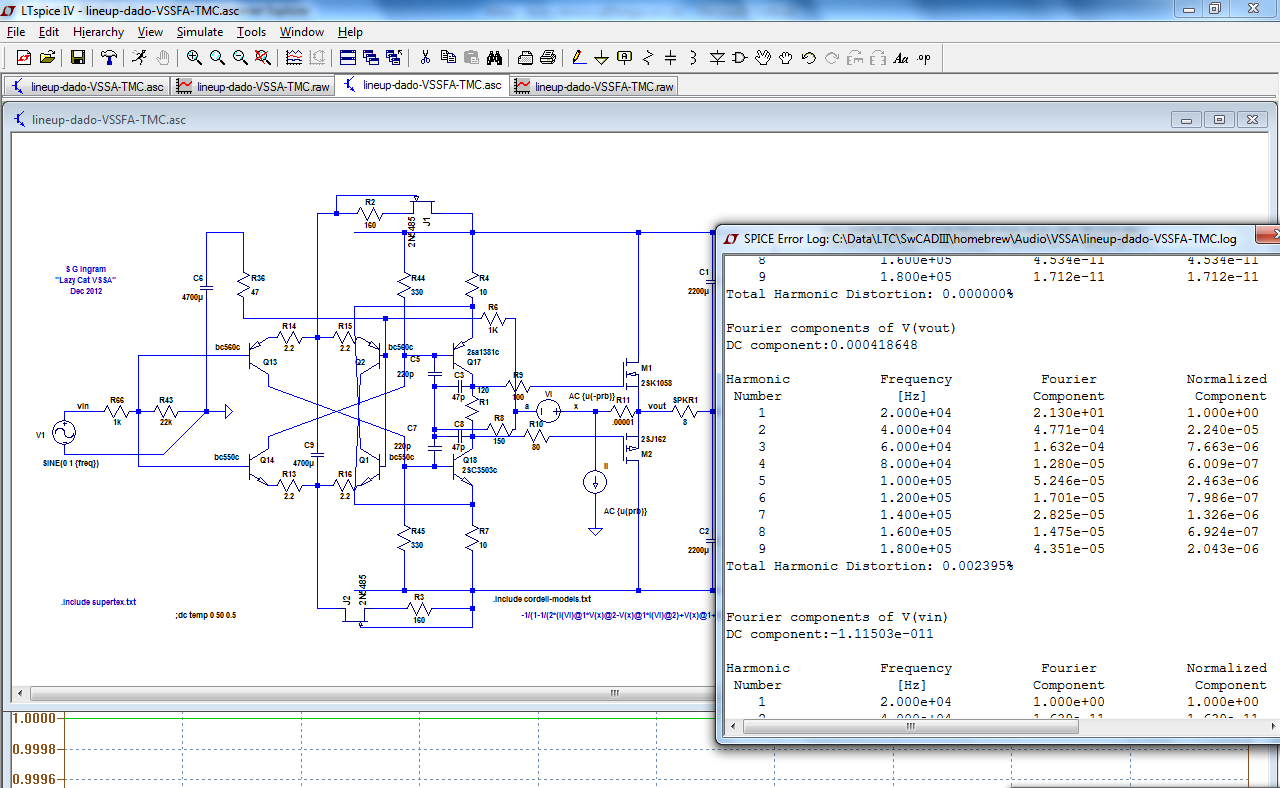

Here is a fairer comparison between the two topologies, with the key parameters like collector currents unchanged, and the main components rearranged in a VFB style.
The only important difference is the addition of the two VFB transistors.
The THD is practically unchanged, as is the OL bandwidth.
Ironically enough, the so called CFB has a marginally higher loop gain (65.7dB against 64.6dB) and a marginally lower bandwidth (9.1KHz against 9.9KHz)).
Can you believe what is indicated on the tin?
It is simply that the feedback networks have such a low value, on the same order that 1/gm, that in reality the CFB behaves as a more perfect VFB amp than the "true" VFB. Funny isn't it? It is actually a VFB in disguise.
This means that there is apparently no good reason for opting for the so-called VFB topology, since the performances are essentially identical, and that the VFB requires additional transistors.
That is of course a superficial view: in the CFB version, any mismatch in the feedback networks will translate in a huge increase in THD, which is not the case in the CFB, because there is a single network, and other components are inside the feedback loop and less sensitive.

Here is a fairer comparison between the two topologies, .
Nice one, Elvee. But, if you want to be fair, don't kill the VSSA to begin a comparison: use my VSSA CFA sim, conform to L.C. schematic:
http://www.diyaudio.com/forums/solid-state/225747-vssa-lateral-mosfet-amplifier-6.html#post3314786
This one is not at all. Too easy to kill the bandwidth of a CFA to make-it measure like a VFA 🙂
