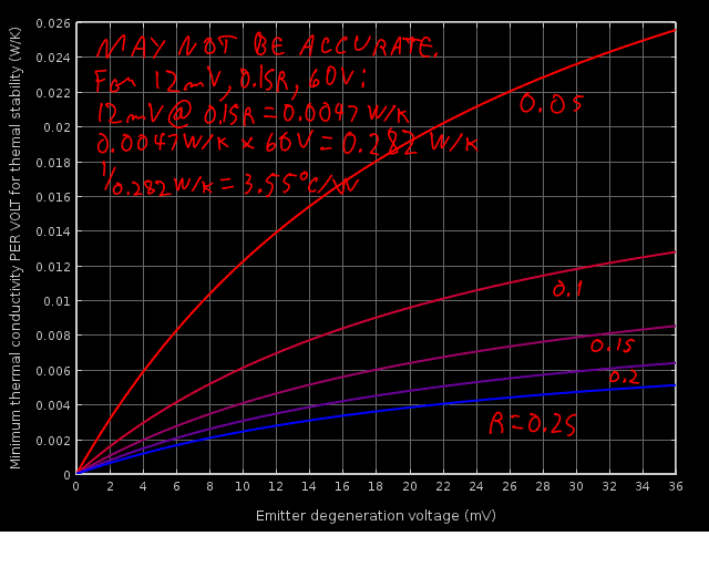

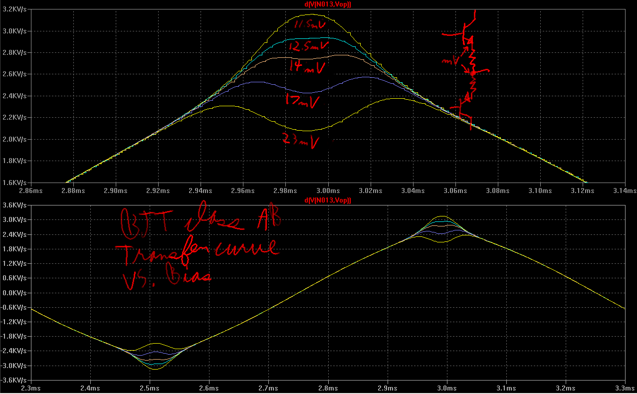

The resistor voltage matters most directly for harmonic profile. 12mV with 0.22R will have the same harmonic profile as 12mV with 0.33R, the main difference that the higher current bias will have a larger class A region and higher Ft. This is as long as the transistors are behaving mostly intrinsically. In Pavel's graphs, something seems different, because usually I see a more wiggly transition there.
At any rate, I messed up the thermal conductivity units for the last graph, so here is a new one.
Okay, I didn't understand your graph at first because you used a sweep and I just use sines.
Notice that between 7.5mV and 15mV you have curves pointing different directions. At ~12.5 mV the curves balance out to a linear region rather than convex or concave.
You should add that cause it's worth showing - only in deep Gm doubling is there another bias point where the first watt is this linear AFAIK.

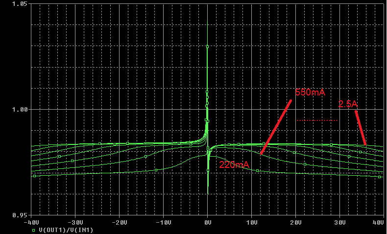

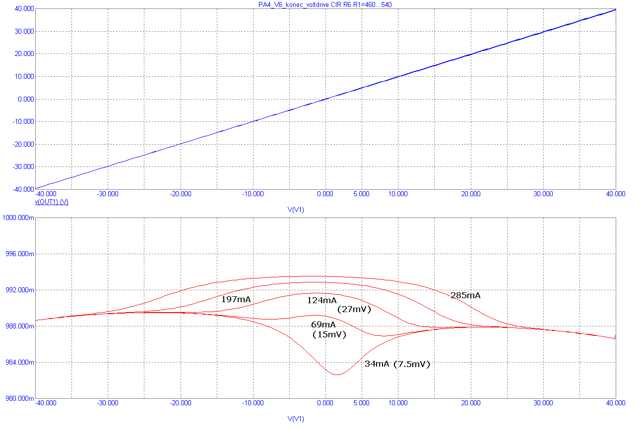

Output stage (MJL1302/3281) + driver only, 4 pairs of output devices, transfer function vs. idle current. Re = 0.22
- Simulation, right?
- RE, RB, BF in the models?
- Load?
- yes
- 0.00127227, 11.988, 139.247
- 8
RB=12 ohm adds 0.1-0.2 ohm to the equivalent RE, depending on BF(IC). No wonder the optimal bias current is so low. I don't think 12 ohm is anywhere close to reality. My MJE1302 model has RB=3.3ohm.

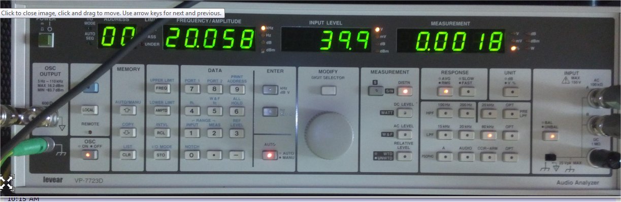

Member ASTX , with his 20K$ analyzer (below 2) ... shows my blameless at the same
20K thd as I simulate it (his is VERY similar). So , I don't think we are too far
off.

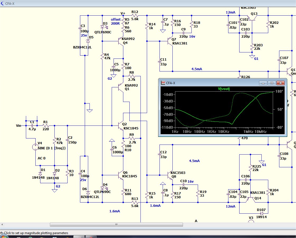

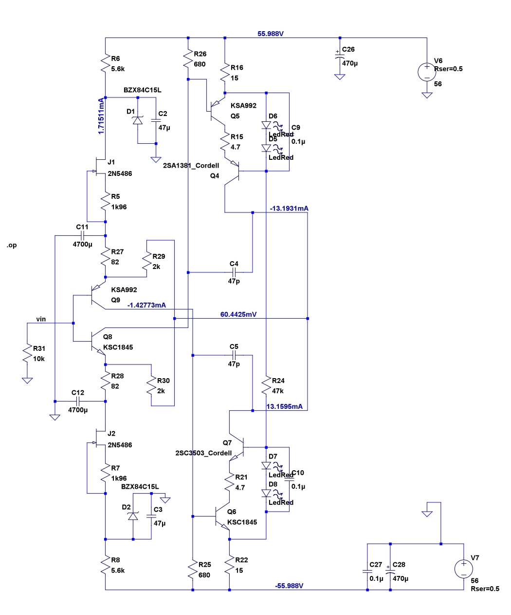

PS - Bimo ... how do you run a CFA IPS in isolation ? The VAS would not have the
current to develop the feedback without the OPS ... ?

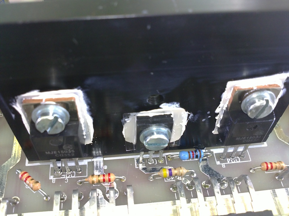

In my TT amp I fixed Vbe transistor on the same heath sink with the drivers, and TT diodes take care of output transistors, result, very small thermal drift.
BR Damir
by the way REs are 0,16 ohm
OS
I just want to measure DC operating point when I try my design. If I am sure the DC operating point is correct, then I connect the IPS and OPS. After that I connect the output to oscilloscope to see any indication of oscillation or not. Then I am connecting the dummy load and signal generator.

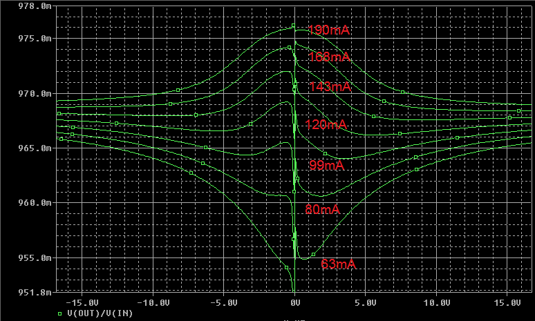

Another of my ignorant question here. Is the chart that Waly just posted indicative of the crossover distortion that I read about here going from class A to class AB? Is this where we are crossing over the X axis and see the swing in direction?
That is a very good question.
When the OPS is under biased (relative to the Oliver optimum point), the OPS gain curve looks like a valley. That's an indication that the switching distortions are dominant.
When the OPS is over biased (relative to the Oliver optimum point), thed OPS gain curve looks like a ridge. That's an indication that the Gm doubling distortions are dominant.
Based on a gain curve visual derivative (the valley slopes seem more abrupt compared to the ridge slopes), we can estimate that the switching distortions will be much richer in high order distortions, one more good reason for the usual practice to slightly over bias the OPS.
Now, what's happening if we further increase the OPS bias? Take a look at the attachment. The ridge flattens out,that is, the gm doubling distortions are decreasing when we advance towards Class A. Ignore the center discontinuities that's a simulation artifact due to close to 0/0 numerical indeterminations.
So, when starting from Class B (zero bias) and advancing towards Class A, the OPS distortions are initially high and rich in high harmonics, they decrease toward the Oliver optimum Class AB bias point, they increase again over the Oliver optimum Class AB bias point, then they decrease again, in Class A, theoretically down to zero (at infinite bias current).
Is this what you are using ?
I see you use Jfet CCS's , and run the Cascode "HOT" .
I forgot the french designer ... but he also used the "magic" 4.7R between
active and cascode....
aaaah .. google found it - Memory Distortion Philosophies - Part 5 : Circuits, continued
"brainwashing the VAS" funny !
He never envisioned this for a CFA.
Does it "sing" ??
