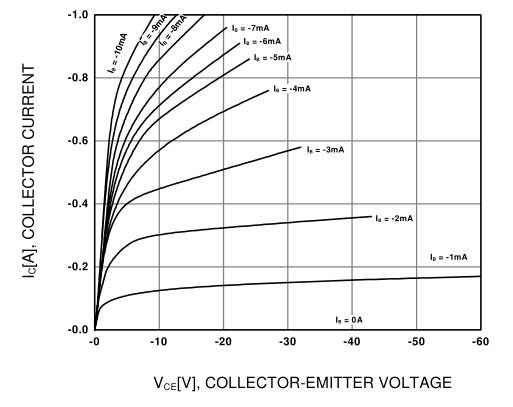

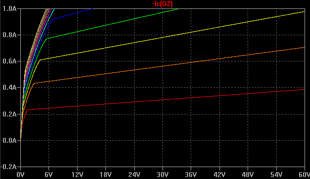

Here is a page on quasi-sat modeling:
Using the BJT Quasi-Saturation Model
There are a few models in my lib that have the GAMMA and Qco parameters. The KSA1220A/C2690A models have them, and the 1220A model shows a curved Early voltage. The THAT BJT models have these parameters as well. They don't look anything like the datasheet curves though.
