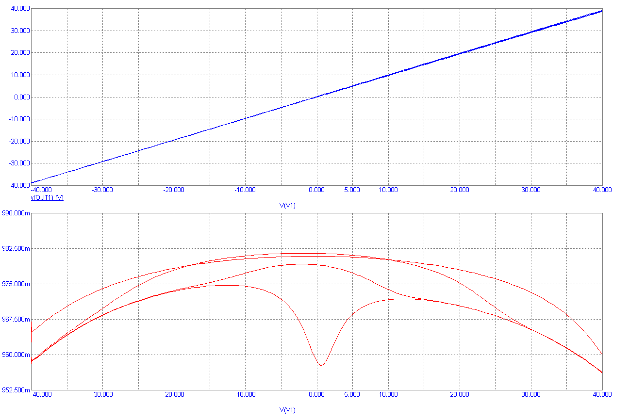

Output stage (MJL1302/3281) + driver only, 4 pairs of output devices, transfer function vs. idle current. Re = 0.22

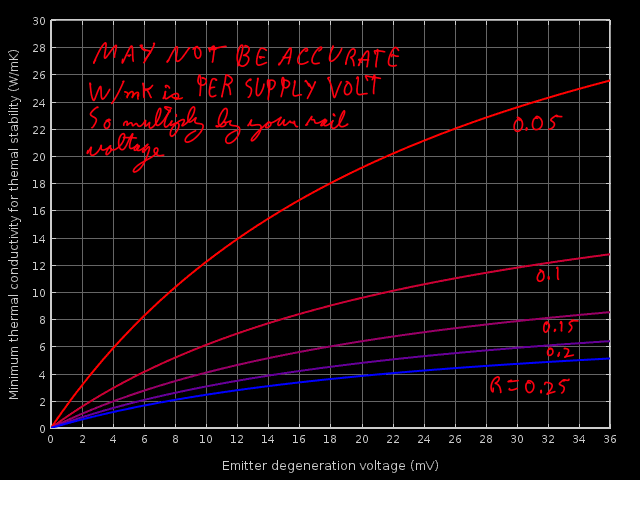

I made an interesting graph. It shows the minimum W/mK (per supply volt) junction-heatsink conductance at which BJTs will experience differential thermal runaway, or current hogging.
So say you have a dual paralleled EF with 0.15R emitter resistors biased at 12mV, and a supply of 60V. We see about 4.7W/mK (per volt) where the .15R line and 12mV intersect. So 60V * 4.7W/mK = 282W/mK. Converting conductivity to resistance, this comes to 3.55R thermal resistance between a transistor and the heatsink. You probably want at most 1/5 of this.
This may seem a bit awkward but it was the best way I could find to represent the data with the least assumptions. The assumptions I DID make are:
1: Vbe tempco = 2.2mV/C
2: Hfe tempco negligible.
3: Degen voltage up no larger than 36mV.
Bob's MJL models seem to have 1.7mV/C tempco, so #1 may be conservative. The severity of #2 is worse with lower degeneration voltage.
Paralleled outputs are so susceptible to differential thermal runaway because the Vbe multiplier is blind to differential thermal errors. So the Vbe multiplier cannot compensate for differential thermal stability. If you had thermal compensation applied to each output transistor, this wouldn't be a problem. As JC said, if you only have one output pair, you can get away with much lower emitter resistors. If you have thermal compensation for each individual transistor, and the factory Vbe spread wasn't too high, you could probably do the same with paralleled outputs.
This also brings up a problem with the idea of having a discrete driver for each output. The drivers themselves in this case will add to the differential thermal runaway.
It is also useful to have this information for TO92 and TO220 size transistors where they would be highly paralleled, as in a low-noise circuit, or paralleled output drivers.
My interest with lowering emitter resistors is to allow the 13mV bias point without sacrificing Ft with low bias. The 13mV bias point could have the same first-watt THD as a GM-doubled bias point, but they would have odd order harmonics of the opposite polarity. For this reason I suspect the low bias point may sound better and be more economical.
