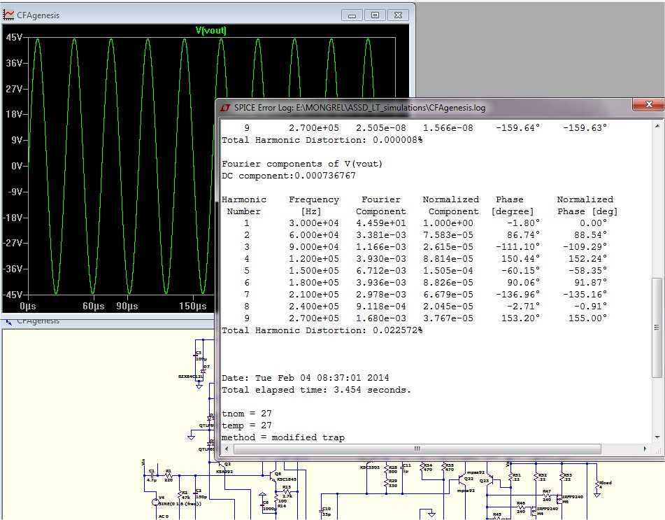

I got very different results of the simulation
http://s019.radikal.ru/i622/1402/27/1be25c526daa.png
best regards
Petr
