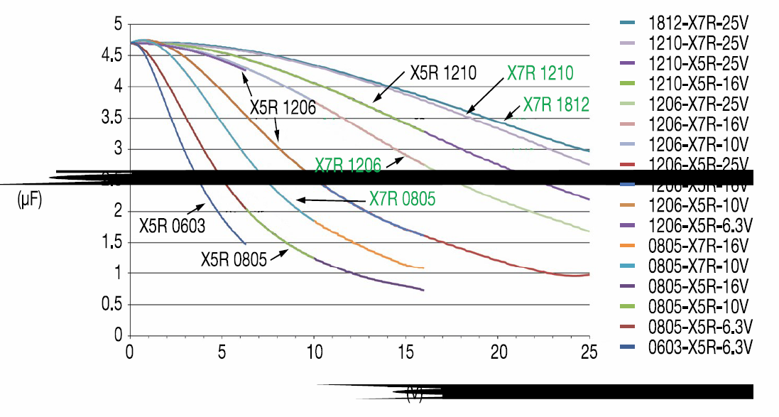

While we are on the subject of decoupling, have read that you need to take into account the DC bias with ceramic caps. This can apparently result in quite a large reduction in the capacitance. Have I understood this correctly? Also, does this apply to film caps as well? Have tried to research the answer but failed so far.
Yes .... and it depends on many things.
Yes for class II capacitors, no for class I capacitors (such as NP0, a.k.a. C0G). At work we once had a 10 uF, 6.3 V X5R capacitor that turned out to have a capacitance of only 4 uF, because there was 3.3 V across it.
Class I capacitors are actually pretty good capacitors, but they are only available in small values.
Class II capacitors are available in large values, but they are temperature dependent, nonlinear, have a relatively low Q and quite some dielectric absorption. X7R is bad, X5R is even worse, Y5V and Z5U are again worse. Mind you, when you only use them for supply decoupling, low Q is an advantage and I can't think of any reason why dielectric absorption would be a disadvantage.
