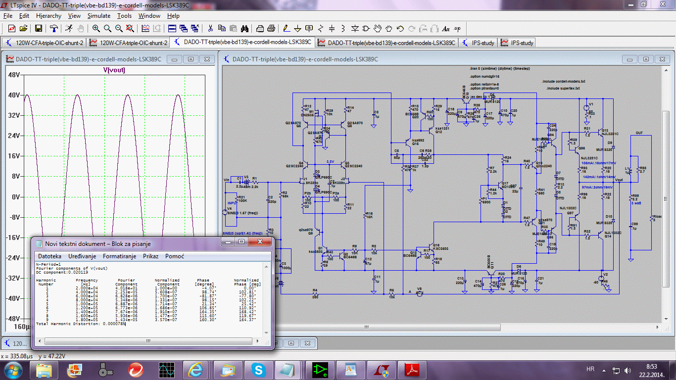

It's not the only one, my TT amp simulate THD20k 0.78ppm at 100 W/8 ohm and 1.36 ppm at 200 W/4 ohm. I don't have real world confirmation, it's playing but never measured THD.

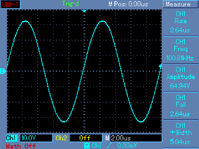

I do not know such a horrible thing like 20kHz power bandwidth, these days. Attached please find easily achieved 65Vpp/100kHz at power amplifier output.
