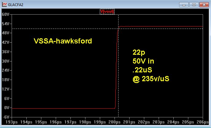

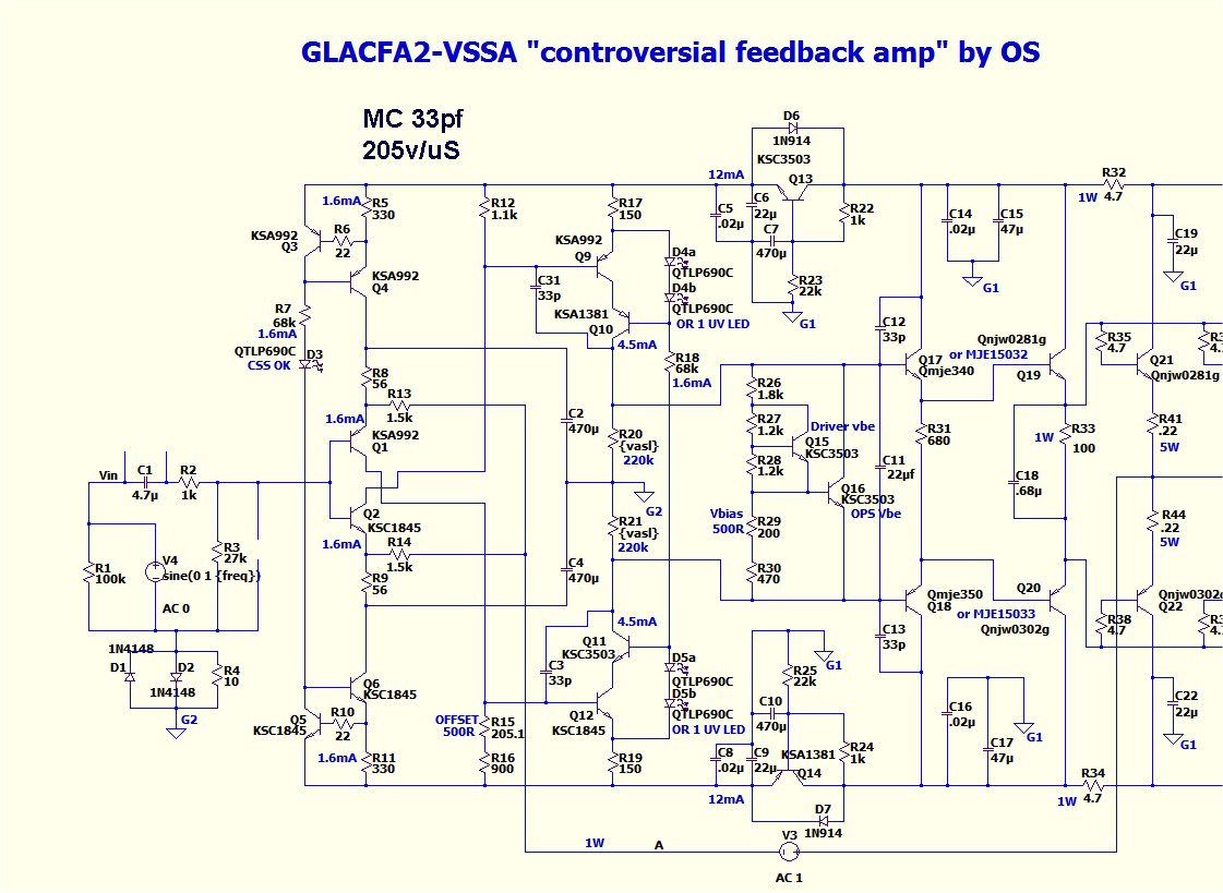

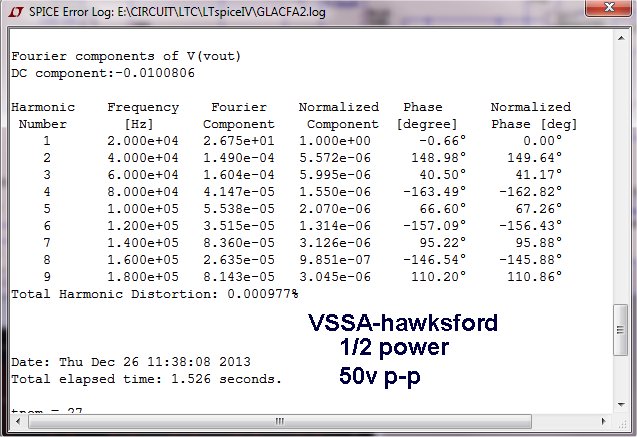

VSSA - Hawksford
Another contender for the "rumble" ....
Also a solid performer , lose the bloody diamond - get slightly
lower distortion.
But .... while being fast , not quite as fast as the "slewmaster" (NX-hawksford).
It compensates nearly as easily with simple MC. On
this round of simulations , I COULD NOT run without
compensation this time with the hawksford.
I saw why on my bode plot - the hawksford has its own pole (5-6mhz) , as it
is a local FB loop in itself.
In conclusion ... it's all compromise ,much better performance - slightly
harder to compensate.
Next - cascode the VSSA and/or add a mirror to the hawksford.
PS - also , I'm still reading hawksford's papers - I will attempt to
"tune" the cascode itself.
OS

Now you have one of my test circuits, apart from the housekeeping and servo..🙂
I am now from your inspiration trying to get a robust servo working by injecting offset into the hawksford cascode, one problem seems to be the fact that the LED diodes i have used are too steep in the characteristics, so you need a lot of current to move it the needed amount.
With lower values in the feedback network you can improve the slew-rate. I use 22 ohme and 1mF to GND
Nothing I do to the VSSA can make for 400-500v/uS.
Except....drive the input pair "direct". The diamond is
the key , it drives the CF pair "direct" in the NX and
buffers that pair from the higher impedance input.
So , the diamond (NX) makes for speed + a Hi imp. input.
:nod: Excellent design decision , Bonsai !!
PS - I would build vssa-hawksford as well - could we
really tell the difference between 200 or 400v/us or
9 and 11 ppm - audibly ?
OS
Yes , lowering Fb network R increased slew to 300+ v/us .
But , changed UG/phase margin. Increased MC to 47-56p to
regain my desired stability ... which , in turn "slowed" me down , again.
Also from the real world design standpoint ... that's a lot more current
passing through those caps to ultimately end up in the "clean star" 🙁 .
Buffering the CF pair still seems superior.
OS
