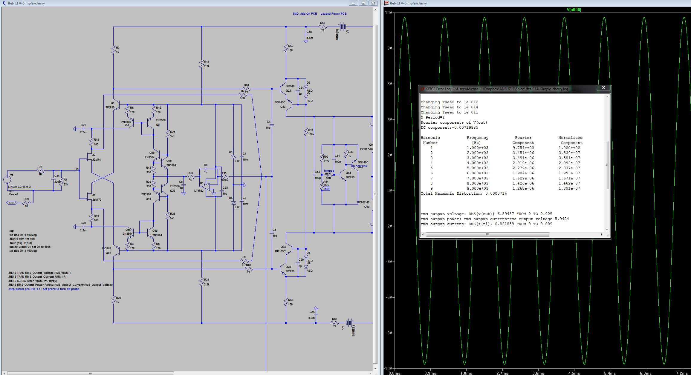

1.2mhz to 1.5 mhz is the VFA upper limit !
These alien CFA's play by different rules.
4.7mhz is where I can get 640V/us(10p). Slight overshoot at this plot.
Absolutely overkill , 47p gives 2.5mhz 250v/us .. this will be the
design target.
PS - Every thing I have ever simulated with KSA992/Ksc1845 - Ksa1381/ksc3503
has almost perfectly been realized in the real build. oscilloscope readings/DMM readings ...
I WOULD NOT waste my time designing a PCB for a "dud" ...

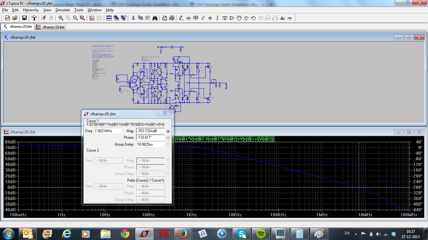

I am sorry about be misleading. (Ok not entirely). 😱
The bandwidth of 1.2MHz is when it is designed without output inductor.
🙂😀 With an inductor - 7MHz. 47degrees phase margin.

Those devices is not a problem, or any small signal devices for that matter. I can easily get to 10MHz. with those devices.
The real problem lays in the output stage. It is just not fast enough. With an fT of 30 - 40MHz it starts to get a serious problem.
I am trying to find a solution for this at the moment.
I will let you now. Have to dig up some old sims.🙂
How do OPS mosfets compare in speed?
-RNM
They are better, but my experience is that they oscillate very easy with to small gate resistor.
Exicon should have something like 100 - 200R. -> -3dB around 700KHz - 1.5MHz for the mosfet itself.
I really need to retest them.

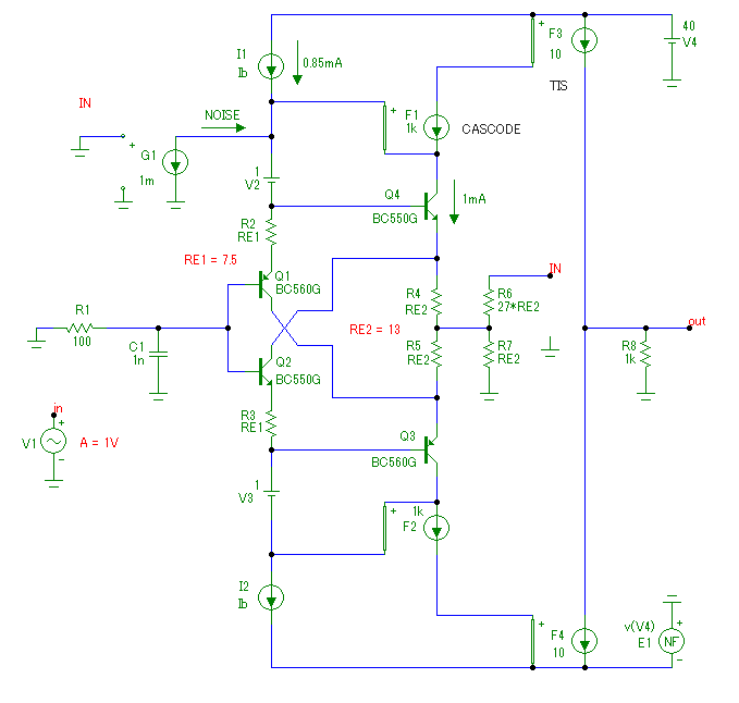

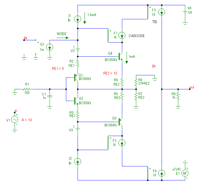

Instead of quibbling about the definition of CFA and VFA amps, let's see how we can improve a CFA input stage. We know already that for lowest distortion RE = 0.5/gm = 0.5 VT / Ic or 13mV / Ic at room temperature (and ignoring bulk resistances for a moment). A weak point of a so called 'CFA' input stage is the not so good PSRR and the susceptibility of noise from the current sources (CCS) which are needed to bias the input stage. The PSRR can be improved by using cascodes, while the impact of CCS noise can be reduced by using a diamond configuration and proper choices of the emitter resistors. As far as I can see, this is only possible if the collectors of the first transistor pair are connected either to the emitters of the second transistor pair (fig.1) or to the feedback node (fig.2). If the collectors are tied the to supply rails, it is not possible to cancel out the CCS noise.
Of course one could calculate analytically the proper values of the emitter resistors, but as I am lazy, I used my simulator to figure it out, though it's an iterative process.
In the example below, Ic of the output trannies (Q3 & Q4) were set to 1mA. So for lowest distortion RE2 should be: 0.5 * VT / Ic = 13 Ohms. Check this as shown in fig.1.
By means of a VCCS G1 an AC current -representing the noise- has been injected (see fig.2). Adjust RE1 (and keep Ic =1mA by also adjusting Ib of the CCSes I1 and I2) for the lowest output signal. With RE1 = 5 Ohms the output signal was about 50dB lower compared to a circuit where the collectors of Q1 and Q2 were tied to the supply rails. If the collectors are connected as shown in fig.1, RE1 should be 7.5 Ohms.
In this simulation perfectly matched trannies were used. So in real life the CCS noise reduction will be less impressive. Also notice that the optimal resistor values should not only be adjusted for the emitter bulk resistance but also depend on VT, being a function of temperature.
Cheers, E.
Cheers, E.

Good engineering, Edmond (as habit ;-)
Any impact on the input stage by the add of the cascode (slew rate, pole etc.)?
JFET CFA
There's no problem in adding J-fets to the Front-end, but you need a cascode as they otherwise would see too much voltage. Here it's fixed at 12 V, but it could also be made as a Hawksford. I chose the simple and included the cascode as a part of the 12 V supply for servo op-amp and current source for the input-pair.
Distortion is even a factor 10 lower
