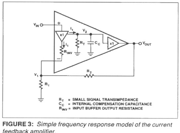

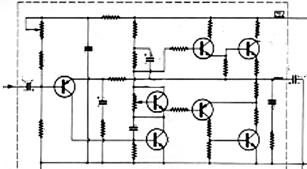

And explain-me where this (attachment1, "early solid state amplifier") do not fulfill that (attachment2) ?:

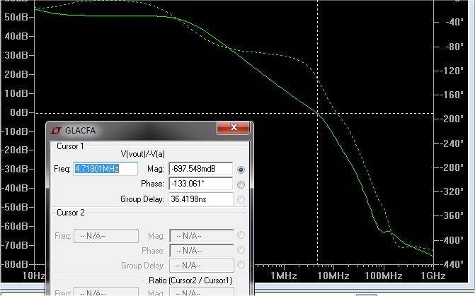

Is this real life or sim OS?
I do not get past 1.2MHz in real life. Only if i lower VAS gain!
1.2mhz to 1.5 mhz is the VFA upper limit !
These alien CFA's play by different rules.
4.7mhz is where I can get 640V/us(10p). Slight overshoot at this plot.
Absolutely overkill , 47p gives 2.5mhz 250v/us .. this will be the
design target.
PS - Every thing I have ever simulated with KSA992/Ksc1845 - Ksa1381/ksc3503
has almost perfectly been realized in the real build. oscilloscope readings/DMM readings ...
I WOULD NOT waste my time designing a PCB for a "dud" ...

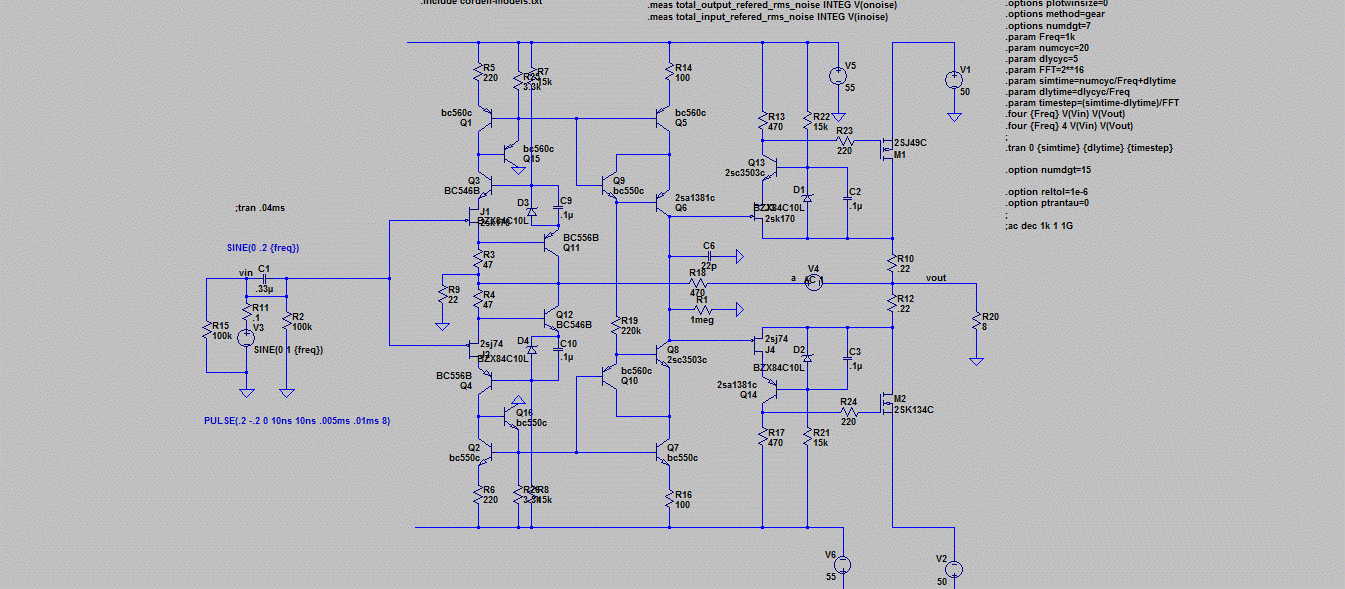

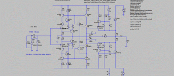

CFA Topology
I am not sure did I presented this amp here already, but this one I simulated some time ago.
BR Damir
This is a CFA. And, Bonsi's is a CFA. Its really pretty easy to know a CFA by its topology --> We have shown it early on here.....
Again... This is the topology for a CFA:
View attachment CFA Topology.pdf
Other topologies are something else and don't behave exactly as this topology does.
Thx-RNMarsh

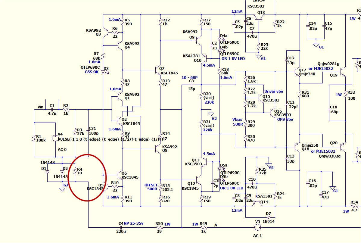

Hawksford "tweak"
Here's how I got the NX to run with 0-5pf.
The idea came from hawksford's papers.
(below). real simple.
2 more caps .... .68uF works as well .
My feedback question is circled in the attachment , as well.
OS
