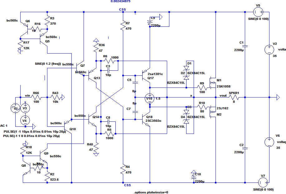

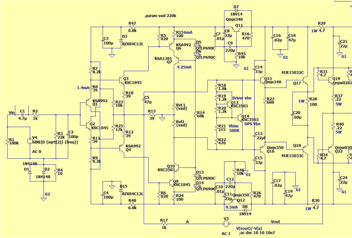

I must agree , after simulating "the cats" CFA to death , I went
back to the drawing board.
The NX by itself has better linearity/lower thd , no filthy caps. But ... real bad
PSRR - fixed that.
Then I tried to figure out if it really was a CFA.
....That's why I bypassed it on the first round.
It behaves exactly like the VSSA , I can run it with NO compensation (small
oscillation) - can not do this with ANY of my 100's of VFA simulations.
I ended up combining the diamond/CFA (I AM convinced - it is !) with a
Hawksford cascode (my already tested luxman) and the HK triple.
This thing "SCREAMS" .... low PSRR , high slew , cool running front end ,
100k perfect square waves. The perfect combo , I glad I took my time and did
not get sidetracked by the controversy.
I also have the same VFA equivalent sim (the real luxman) for comparison .
OS

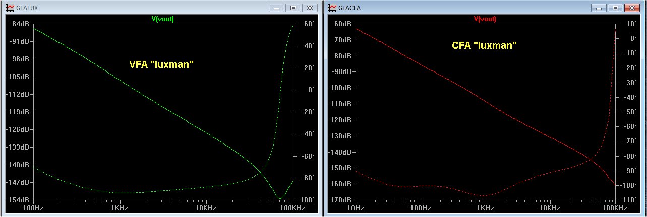

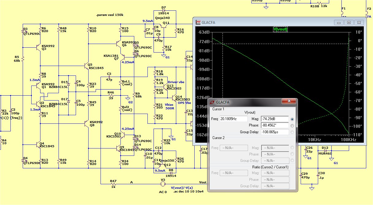

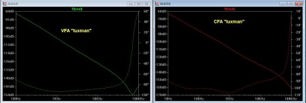

All the "frills"
(first attachment for reference) - my "LUX" (VFA) versus an "NX" (CFA)
JUST multipliers ...
OK , last "whack" at this.
Cap multipliers on the VAS/front end , diamond with regulation +
CCS's. (2nd attachment - +schema)
This iteration of the amp lowered THD to .0006% THD20 , nearly "badger/TMC" level. I also gained 6 more db at 20HZ PSRR.
So , your right , Bob .... even with far fewer components vs. performance ,
one needs far more support (multipliers/regulators) for the front end
to even approach VFA PSRR.
When I build this - DUAL MONO is the only way.
I am pleased .... by far the best performance without "compensation tricks" 😀.
PS - to all those simulation "doubters" - I have built and am listening to
most of the "modules" (CCS's /multipliers/OPS/VAS's) in the simulation...
they really work !!
OS
