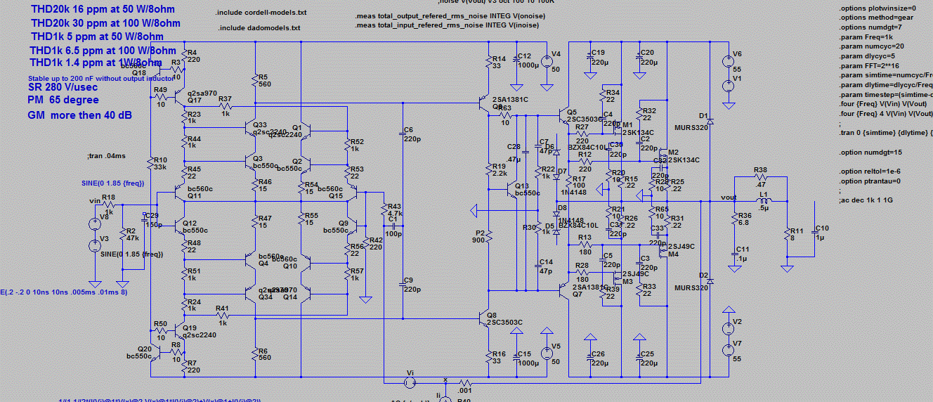

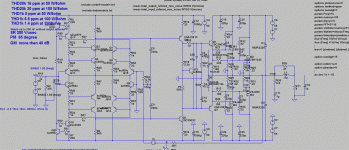

CFA-VFA
Marry Christmas to all CFA and VFA fans!

Edmond, have you seen Richard post #2900, second attachment?
Hi Damir,
I've seen it, but it still doesn't make me happy. Admittedly, as an op-amp it is a useful configuration, fast and a high Z inverting input. But for a power amp it is a waste of trannies, because we have lots of power to feed a low Z inverting input. IOW, we don't need this additional diamond buffer. You could make better use of these six additional trannies, for example a CMCL for the two TISes.
Cheers, E.

Hi Damir,
Cheers, E.
Hi Edmond,
I agree with you, but small trannies are so cheap, specially those in simulator.
BR Damir
PS. sometime trannies are cheaper then high power resistor needed in CFA feedback circuit.
I agree with Edmond, A Diamond buffer is not sonically invisible, I have evaluated several buffers by inserting them into the chain as a replacement for a RCA-RCA joint. It's clear to me that it robs the music for some life clarity and focus. (I know this is not very scientific and can be debated) but for me personally, my ears are good enough to guide my selections
So having two diamond buffer in one amplifier, one for the input and one for the feedback can't be beneficial compared a simpler circuit that can be built without.
...having two diamond buffer in one amplifier, one for the input and one for the feedback can't be beneficial compared a simpler circuit that can be built without.
I agree on the two points. The second, for me, is the most important. We can believe most of the evils of a circuit in the open loop can be canceled by feedback, but anything (and even resistance's imperfections) in the feedback loop have a huge influence, reduced by nothing.
Compared to a CFA, the LTP of a VFA adds an active device in the feedback loop. may-be this is the only thing witch makes a difference.
A diamond buffer there ? Oh, my God !
