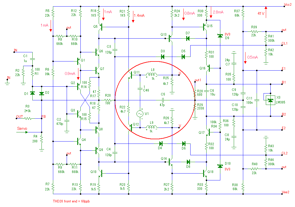

Have been using the CMCL (MCP version) in some prototypes along with experimenting with your DTMC. Both ideas work well.
Does the CMCL loop itself require any specific compensation? My skills in loop analysis are not quite up to the job yet, to answer that question independently...
Paul
Hi Paul,

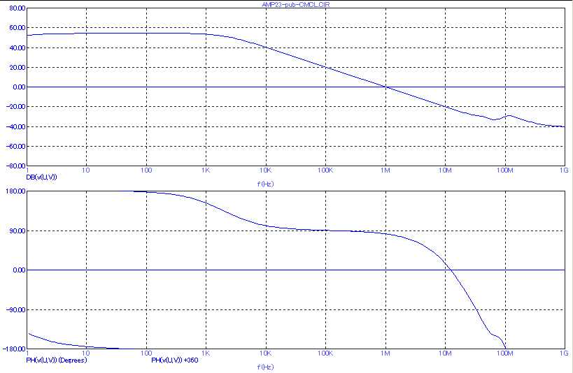

Also a CMCL needs definitely compensation, as with most loops. But that doesn't mean you always need extra components. In case of the MCP amp, the caps C3 and C4 serve a dual purpose: compensation of the global FB loop AND compensation of the common mode control loop (CMCL). As for the latter, this is achieved by a capacitive shunt between the base of Q13 respectively Q14, consisting of C3 and C4 in series (=60pF). Without these caps, the CMCL would be unstable.
Checking the loop response is quite simple, at least if you accept some minor inaccuracies*.
Just insert V1, C46, L8 & L9 (see 1st pic) and observe the response of V(u,v) / V(v1).
The 2nd pic shows the response. PM = 82 degrees (@1MHz) and GM = 22dB (@12MHz).
Cheers, E.
* You can do it this way because the impedance between node U and V is much lower then between the bases of Q11 and Q12.

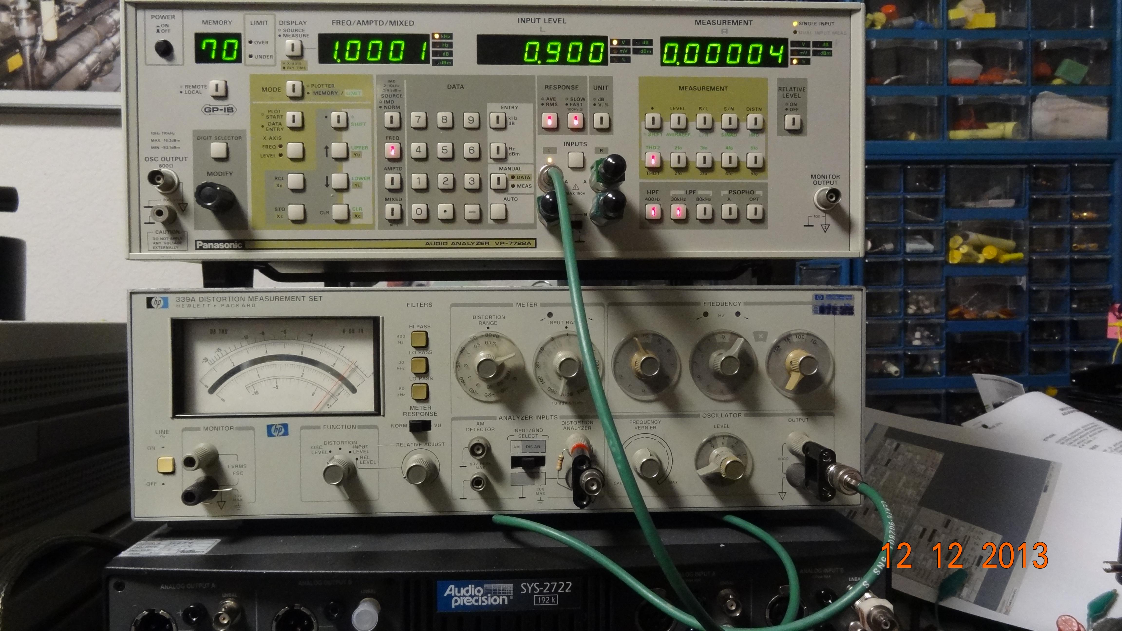

Here is an HP oscillator/generator source that was spec'ed at .0018% THD+N. With some tweaking it can do much better.... this is thru several opamps, caps and other parts selection and retuning. It can be used to test amps etc and only cost about 100-200 USD used. The down side is -- To tune it and accurately know the distortion levels requires either a ShibaSoku AD725D analyzer or an A-Precision 2722, though. Slightly higher cost: About $60K USD, new for both. However, you can copy process and then tune for best null. Even if you cant measure the generator's THD/N accurately, it will be below -100dB after the mods.
Click on picture and zoom in -- Using a Panasonic Industrial AP-7722A
Thx-RNMarsh

Hi Edmond,
Thank you for taking the time to help. You don't know how useful this information is to me.
Have just tried your loop analysis method in LTSpice and the results are pretty much identical to the attachment.
The information you have given also explains why my first prototype was unstable. This was because I decided to split the DTMC compensation network into two separate networks thus not having the capacitive shunt connection between Q13 and Q14 bases. At the time didn't understand the concept of having TIS fighting issues due to component tolerances in the compensation network.
