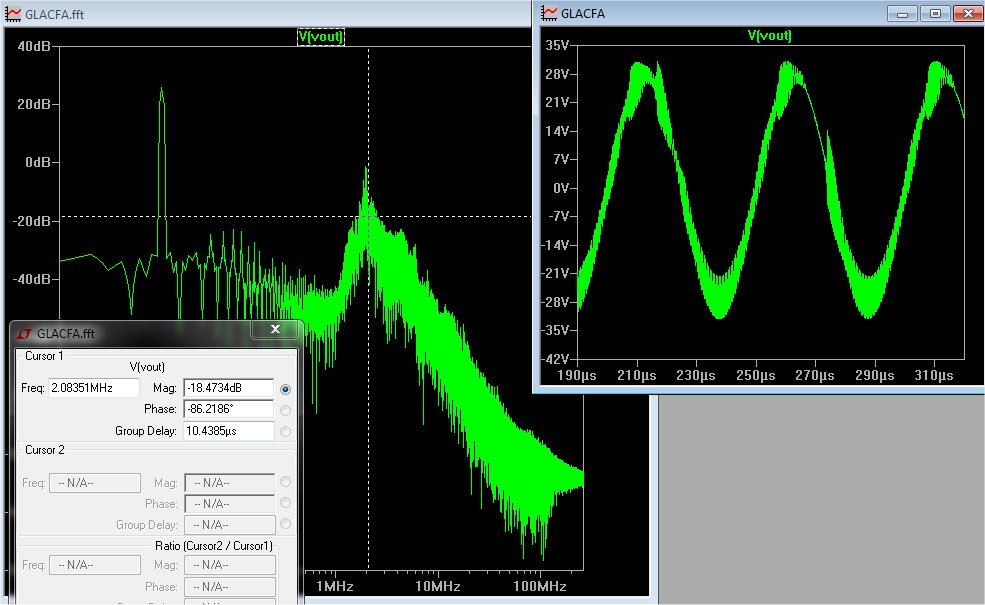

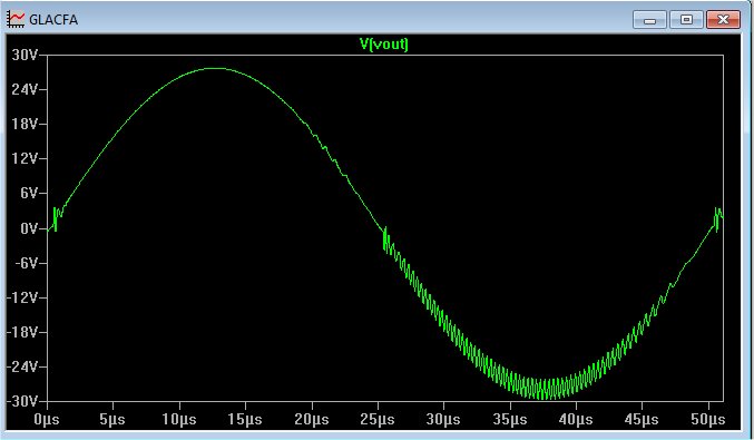

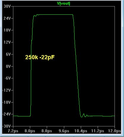

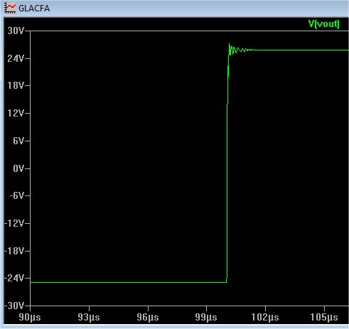

The limit ....
WAY out of the realm of any VFA ...
A damped ringing at 10pF (below 1) , UG at 5mhz - slewed 50v in .1us.
1/4 MHZ ! squarewave with ring (below 2) .. still stable.
33 or 47pF was more managable , UG at 2-3mhz. Much more stable than
any VFA at that freq.
Below 3 - perfect 100K SW -4R

I'm still amazed that an amp with a single compensation capacitor can
have .0005% THD20 ,almost 300v/us slew and a UG of 3mhz
and still work ! (It beats the tmc blameless easily).
OS

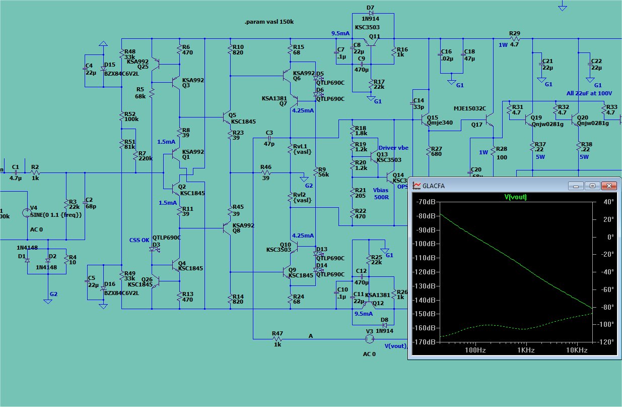

(below 1/2)... I am on line with a standard VFA in the PSRR department.
I tweaked the multiplier and used a "real" CCS.
Just 1 question ??? You use offset adjustment taken from the zener
regulators applied to NFB on the NX. It worked .... but OEM's mostly use "input side" offset compensation.
Why did you choose this method ?
PS- I separated the offset regulators from the diamond.
Of the 3 options (input , FB , or servo) which would be best ?
All else on my circuit is either acceptable or exceptional. 🙂
OS

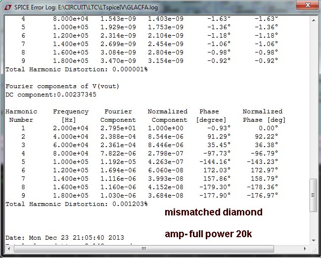

got it ..
Just one "stinking" cap ...
How I did it (below ).
I did make THD go up ... OMG 😱 - from .0006 to .001x% (below 2) 🙄 .
Mismatched a zetex with a fairchild on the diamond - offset
is .2mv (better than the 992/1845).
Thinks I gotz it.. 🙂
PS - I pulled out my VSSA sim , added a couple diodes - used FB just like
the NX. Techniques are interchangable between both circuits.
Q5/Q8 are the dedicated level shifters/CF and the diamond is a very high impedance buffer .
NX is a "hybrid" , a VERY good one...(behaves like CF and VF) 😀.
