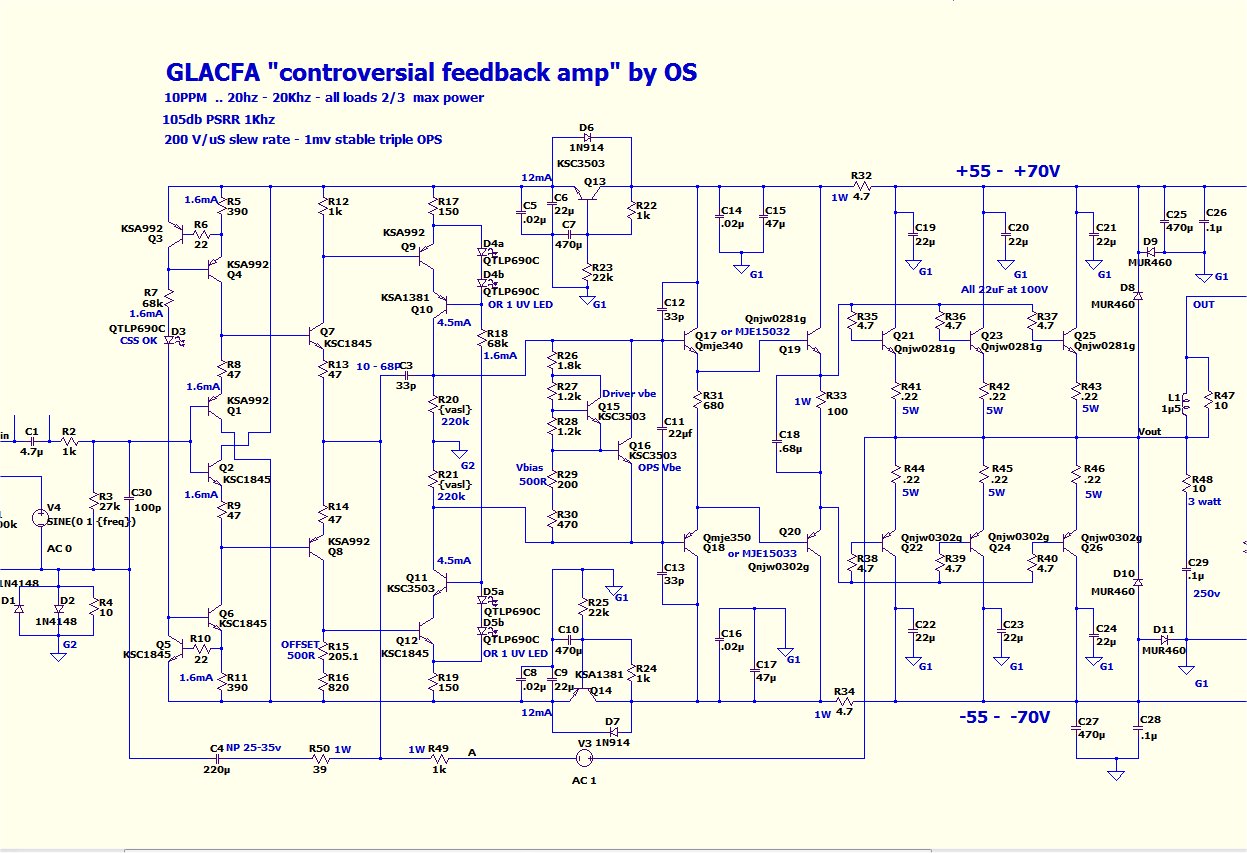

Controversial feedback amp... "slewmaster" !
It's done (done right).

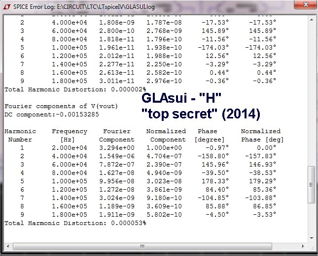

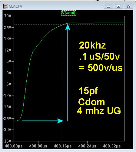

I was able to get 1/2K(500V/uS) out of this thing (below 1) !
Do we really need that ? I "slowed it down" slightly for DIY.
Mouser has 41K- ksc1845F/ 35K- ksa992F in stock @ $.21c.
No hard to find parts for this thing !
Used MJE340/350 for VAS , still ...400V/us 10ppm THD20.
Outputs can be any popular BJT OP device / drivers the same. Vbe
should be ksc3503 (high Hfe)for best thermal tracking.
EXTREMELY tolerant of mediocre components/(models).
Only way to get unstable is to omit compensation entirely.
ABSOLUTELY the best amp I've simulated.
- PSRR is -105db @1 Khz (-78db at 20hz).
- <15PPM up to 50Khz.
- 200V/uS or better .. easy, any Cdom !
- Low offset with wide adjustment. (no precision matching required)
- Capable of VERY high input impedance.
- Cool running/low current input stage/VAS.
Schema and .ASC/text below as well.
PS - UV led's for cascode are 3.1V vF - perfect !
Merry Christmas , OS

Hey OS, are you coming up with a board layout for us to try? great design btw....
finally theory and practice has a chance to meet....😀

As I have stated , my CFA is the acclaimed harmon/kardon 680 OPS ,
a Luxman M120a VAS (modified) and the "spirit" of the NX.
They go very well together. The Hawksford cascode (with its local FB)
doubles the speed of the CFA.
The hawksford gives error free VAS performance by cancelling Ibc/Ibe error
currents within the cascode. You need an EF3 - I built the Hawksford/Luxman with EF2 and
it was engaging at normal volume ... but degraded with high levels.
Driving the Hawksford with a symmetrical front end is ideal , as using a
standard LTP(VFA) involves level shifting and other "dirty" asymmetrical "tricks".
This led me to find the simpler method of trimming offset. Luxman just
trims bias on the negative Hawksford semi. This will not affect the overall
symmetry of the amp, as the offset is created by Hfe/gender differences
between the active devices to begin with. Nothing in the signal path , like
with trimming the input or NFB with a DC value !
By "simming" the NX "to death" ,I found both the diamond and the 2nd stage have gain.
OLG can be increased by changing Re of either. You also can
manipulate the 2 gains independently to make this amp do other "tricks". 😀

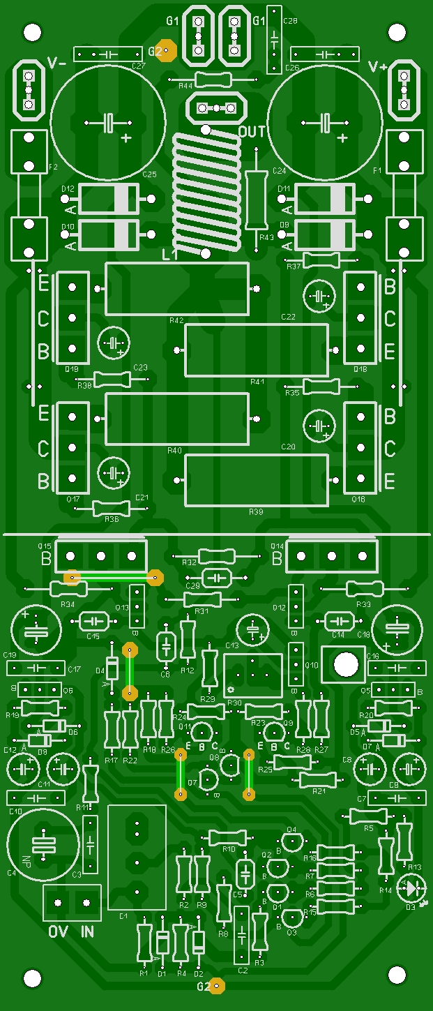

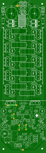

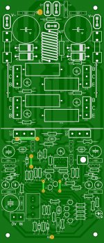

Your question of the board layout is timely. (below) is my "universal"
triple. I can add any "front end" I wish to it. Rail busses AND 2 , 3 or
5 pair options. 🙂
Whether there is any interest or not ... I will build the 3 pair version
"slewmaster"
OS

OStripper:
Extremely well engineered, and reflects your mastery of design. You toy with the circuits and make them dance to your music, pun intended.
What is the max number of output devices the 70 volts and drivers will handle? What will that output be into both 4 and 8 ohms.
This is a great Christmas present you have made to the DIYAUDIO community.
Merry Christmas and continued blessing for the New Year to you and ALL here.

Silent night , holy night 😉 I turned the music off.
Thank you .. sir.
To answer your questions ....
If you use mje15032/33 or 2sa1837/2sc4793 (h/k uses these in the 680) ,
3 pairs are ideal ... like the "Badger".
3 pairs at 70V rails can really fill a normal living room with
breathtaking dynamics or just plain TOO LOUD !!
For my 5 pair board ... you could even do 10 pairs with NJWxxxx drivers
it could do subwoofer duty (very large subs) and 2 R loads.
3 pair would be 150W/8R (4R - lower rails)with 300+W peaks (easy).
5 pair would be 250W/8R... 400W/4R - 700w peaks.

H/K 680 OPS (3 pair )as a 75mm x 125mm main card ,
75mm square "daughtercard" for VFA/CFA "front end".
