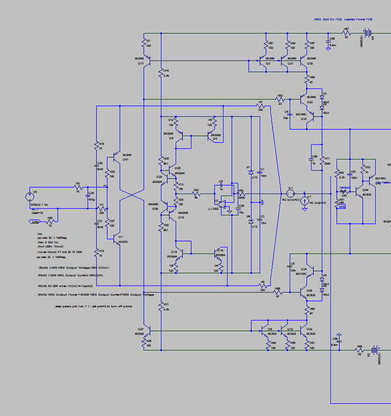

Here's the frontend/housekeeping I am currently working with It Has now been playing for more than 2 years. I have tried it with several different OPS. from laterals to triples.

The second one looks like the H bridge CFA config. Great because you get hi-z inputs on both + and - Inputs. I simmed this a few months ago. Very low distortion and extremely high SR. Looks similar to the structure discussed in the ADI app note that I based my sims on.

Buf634 is, dual bias mode, protections, and bandwidth adjustment. I am using it at my last schematic.

I fail to hear much difference between dual and triple EF. (but this may also be a little cluttered as there also was some alteration to the PS)
I would like to work a little on the OPS that RNMarsh showed An interesting Diamond.
