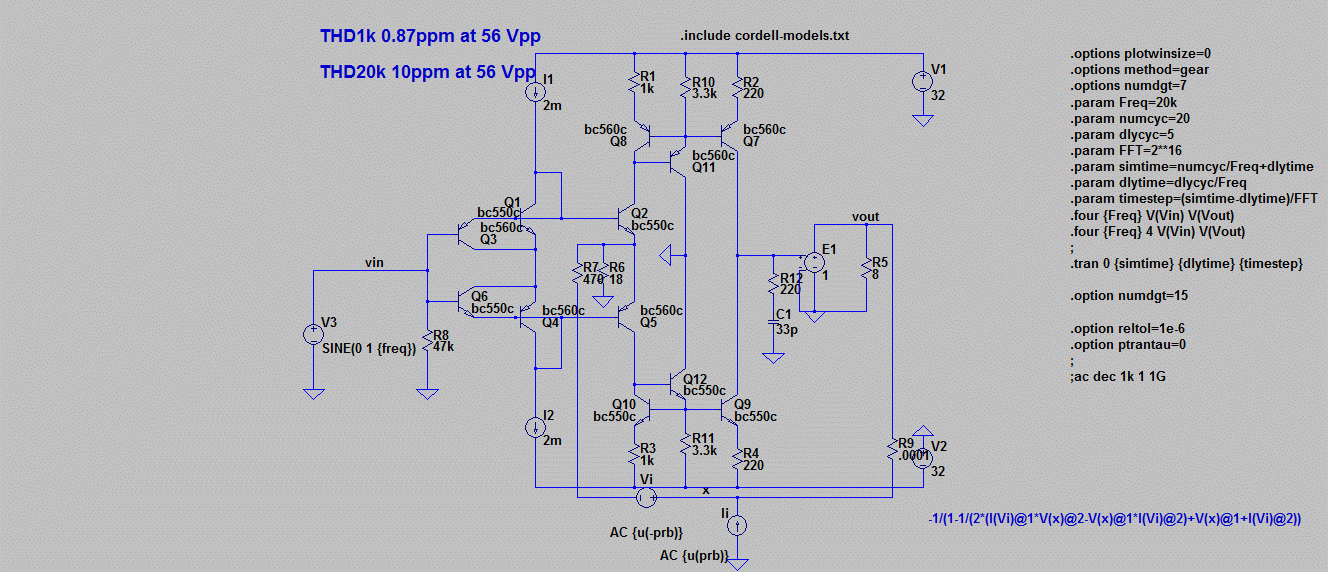

Hi Andrew,
Here is another link to the schematic. As you can see, it is not just a standard VFA, rather a VFA with some 'current on demands' properties, that is, to a certain extent. This has been accomplished by means of a cross coupling resistor (and capacitor), see pic below.
Indeed, there are a lot of clamping diodes, which protect the TIS against deep saturation. But what has this to do with a 'huge OLG'? I think they are needed because the IPS is capable of delivering pretty large currents (according to Stochino <= 18mA).
Cheers, E.
The CoD adds only circa 15% more SR over and above the standard MC (250 V/us to the claimed 300 V/us).
Pretty pedestrian given the additional circuit complexity in my view and thus I classify it as a dominant pole compensated VFA.
Diamond input buffer or not --- if any circuit does not fundamentally look like this --- it is not a CFA. Strictly speaking. Everything seems to get simplified or dumbed down.... so now we have anything with feedback of any kind to an emitter/source as a CFA.
Just to stay clear. There is a difference. When we go to simplify this further..... down to a minimalist circuit, we could end up with something else. But that can also be pretty good with care.
Thx-RNMarsh

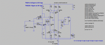

This is an attempt to have real CFA. Richard is this finally real CFA?
BR Damir

By Bonsai -OS, the leach is a VFA.
With all due respect , I am fully aware of what the leach is (and isn't).
My simulation had the same even order cancellation and behaved electrically
similar to the the leach.
My point was that it performed far better with the same parts. Leading to
the fact that some other factor was involved (the method of FB).
I suppose I'll have to wait until Y'all decide on WHAT a CFA is before I take
a "whack" at it. I'm patient - go to it ...guys !
OS

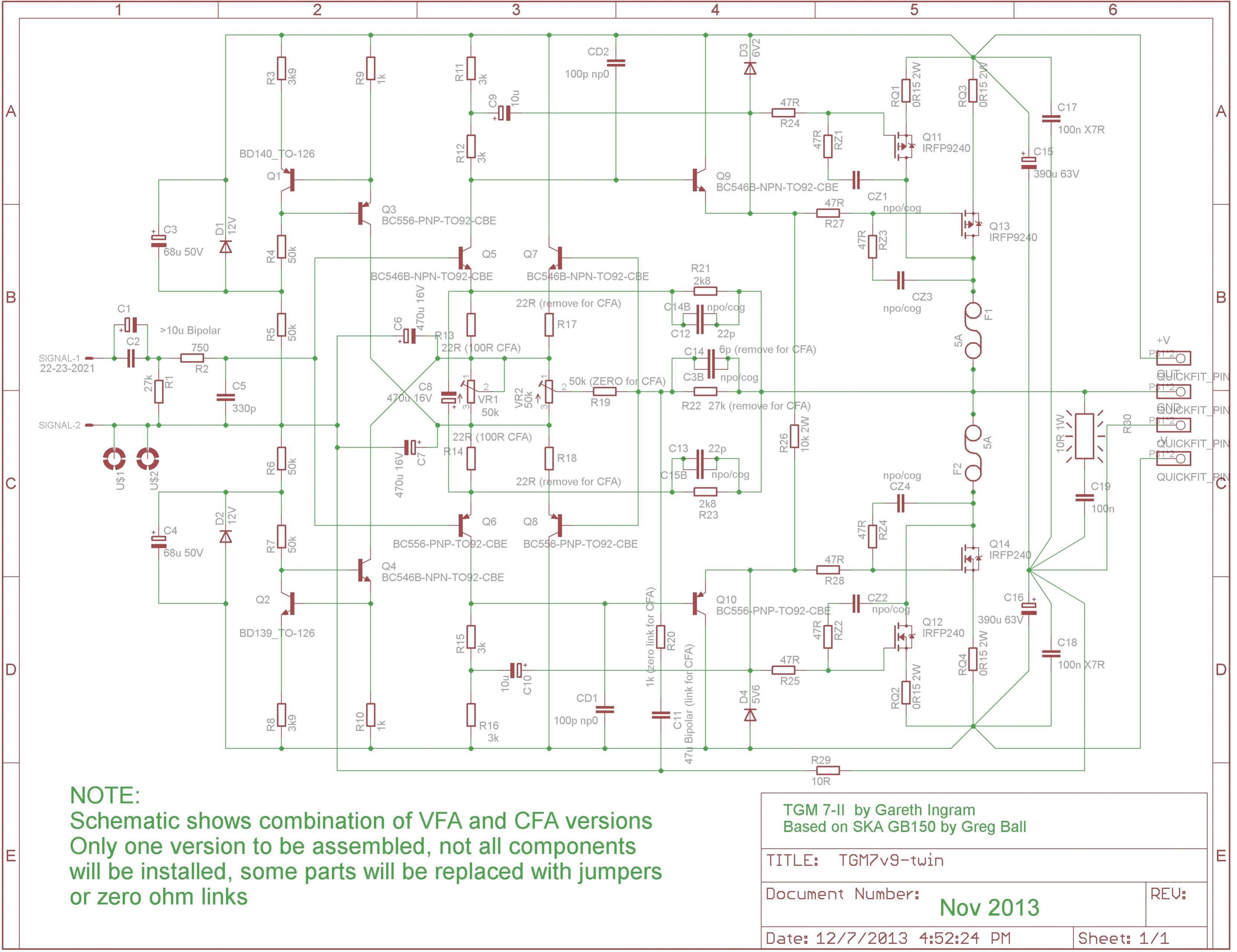

An example of both 'types' of feedback - in one amplifier - on one pcb.
It can be built with dual LTP at the front end, or with dual singleton at the front end.
In the case of the LTP input, there is a single feedback loop of high impedance to the bases of the LTP feedback devices.
In the case of the singleton input, there are two feedback loops of low impedance to the emitters of the singleton devices.
Pretty much everything else remains unchanged.

Hi Krisfr,
This is a unique design, you can't put a cap multi or any kind of RC filter on the power rails to the front end. If built in CFA mode it will need a clean power supply, simple as that.
I'm not proposing this design for you fella's - I bow before OS when it comes to design and build of amplifiers. My TGM7 project is just for my own enjoyment - assuming it works!

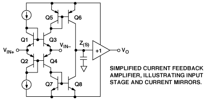

Dadod -- Yes, it is real CFA.
Add your CCS, cascoding, improved mirror/conveyors and I/O buffers to taste.
If you add some R's to eliminate early voltage you get this:
View attachment CFA perhaps..pdf
Beginning to look familiar?
My design of the late 70's which was published in 1980. It has slowly become the new audio design standard since then.
I got a phone call while working at LLNL from Comlinear design engineer when my circuit was published in TAA. he asked a lot of questions on why I did this and that etc because he was working on similar design. later, in 1982 the patent came out on the CFA and in 1989 the first monolithic CFA was produced (EL2020). The addition of the current-mirror and the diamond buffer on the I/O was the CFA shown. BTW - R.Baker from MIT described his 'diamond' buffer in an IEEE paper in 1963.
If you look at the diamond buffer and reverse all the e-c's you get the amp I described in 1980.... maybe call it a diamond amp topology.
My question to everyone is this -- is it also a CFA? 🙂
