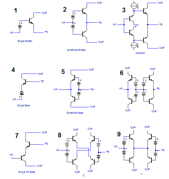

This approach is still trying to use imprecise labels to divide varied topologies into two categories. Of course it become convenient to affix labels, then to affix a way of approaching the design and analysis. But when we also try to claim one is better than the other we create confusion and argument. It's no different in politics - polarization around concepts that are used to divide people into two camps - which doesn't help. The history of this thread surely shows that there is a fundamental problem with the idea that amplifiers can be divided between these two camps and that one is better than the other.
My suggestion was to focus on the topology without calling it VFA or CFA. Compare the LTP with the Singleton, for example (and their symmetric counterparts). Is an LTP a Singleton where the feedback loop has been buffered with an emitter follower ?
OK so figure 1 is a CFA and figure 7 is a VFA 😀
It's a bit clearer with these two figures, how you add an EF buffer to figure 1 and you get yourself a Rush cascode like figure 7. In both cases you could design a low impedance feedback loop. You can not use a high impedance feedback loop with figure 1 because the input impedance of the emitter is too low.
The emitter of the error amplifier in either figure 1 or 7 doesn't 'know' if there's a low impedance feedback loop or a high impedance loop with an EF buffer. But the EF buffer will introduce additional phase delay and non-linearity. And as Bonsai points out, the EF buffer will not deliver higher current with higher signal levels whereas a low impedance feedback loop can.

OS, the leach is a VFA.
The 2 tests:-
1. The LTP's are fed from current sources so the peak current into the TIS is limited to the LTP current. In a CFA, the peak current is determined by the feedback resistor value.
2. If you plot the closed loop response and change the gain (say from 20 dB to 50 dB) you will see the - 3dB bandwidth reduce as the gain increases (I assume you are looking at the leach with MC here). This is a MC comp'd VFA obeying the constant gain bandwidth constraint caused by dominant pole compensation.
2 of the three pointers for VFA are met
1. Both the inv and non-inv inputs are high impedance ~ voltage feedback
2. 2 gain stages (LTP and VAS)
(3rd pointer: in classic CFA, the gain stage is in the form of a transadmittance amplifier - i.e. current mirror. but, CFA with TIS is also possible)
