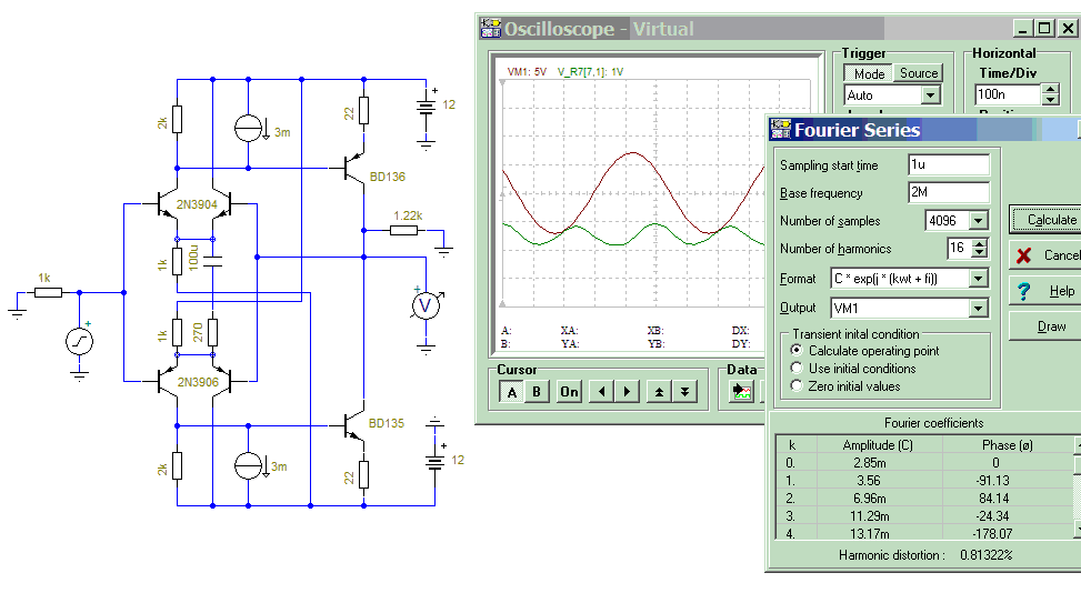

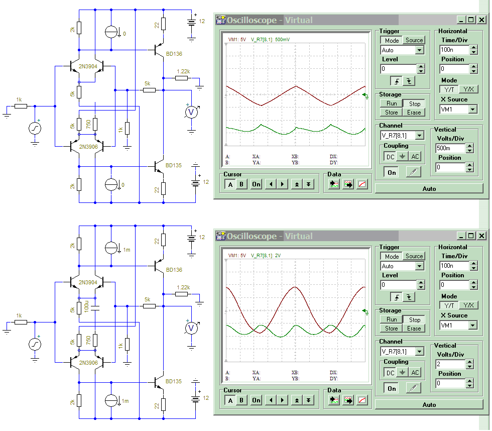

Pay attention to the output stage. Taken separately output stage distortion is less than the output stage with error corrector Hawksford

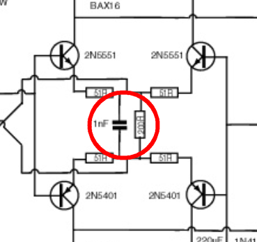

Hi Andrew,
Here is another link to the schematic. As you can see, it is not just a standard VFA, rather a VFA with some 'current on demands' properties, that is, to a certain extent. This has been accomplished by means of a cross coupling resistor (and capacitor), see pic below.

Could you, please show the schematic, not the link to the dangerous page
Yes, that 200ohm and 1nF (for HF) makes it able to do current on demand and the current sources turn the input stage to get higher gain than only H configuration.
[/URL]
best regards
Petr
