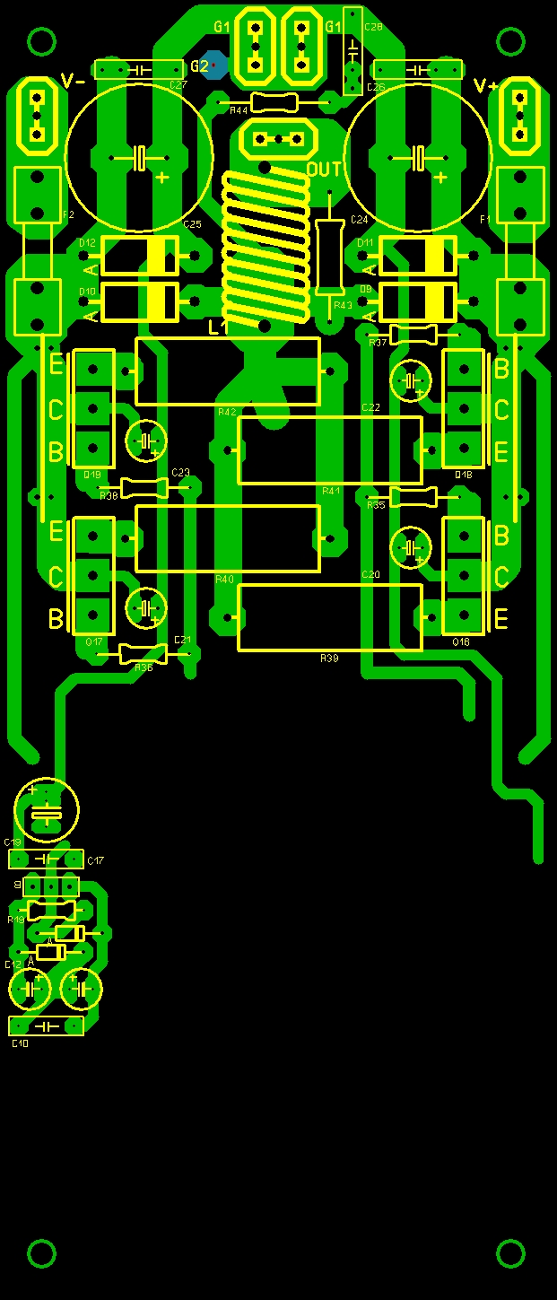

I use the same modular method for my PCB's (below)
That template will be the HK680 triple .... I will "transplant" anything I
want into the blank space for a "front end".
I also have CCS's , multipliers ,Vbe's and regulators as separate files. Just
put them together as "building blocks" - finished board in hours !
One question ? Is the PeeCeeBee a CFA ?
OS

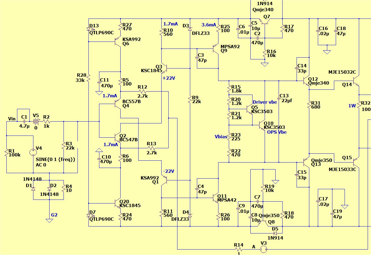

I saw Dadods big 200 watter. Looks well thought out ... but too many devices.
I just looked at the NX , It looks like my first attempt (100 posts ago ).
Actually , is that a diamond buffer I see ? OP stage is different , as well.
I never looked at the NX before - but it is similar to my first sim (below) ... which was put
into doubt ... as to whether it was a "true CFA" 😕 .
BTW - excellent documentation , Bonsai - easy to read/comprehend.
The far simpler Pee Cee Bee looks like a better bet.
I think builders would want -1. scalable 2. durable 3. not "picky" (devices-wise)
4. ALL through- hole
I have seen the comments " call CFA .. "JOE" or "controversial feedback amp"
I'll ask again .. are the NX and peeceebee real CF amplifiers ?
Much of this thread is pure silliness - that's why I am "skipping around" , I
just want the info needed because I am "goal oriented". If the "JOE" amp
sounds/performs good - so be it , whatever it is called.
It is a shame DIY'ers would would rather build poorly designed projects with
catchy names instead of better designs like the NX and others. Dadod's design
just scares the builder with TOO many devices.
OS

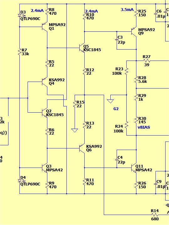

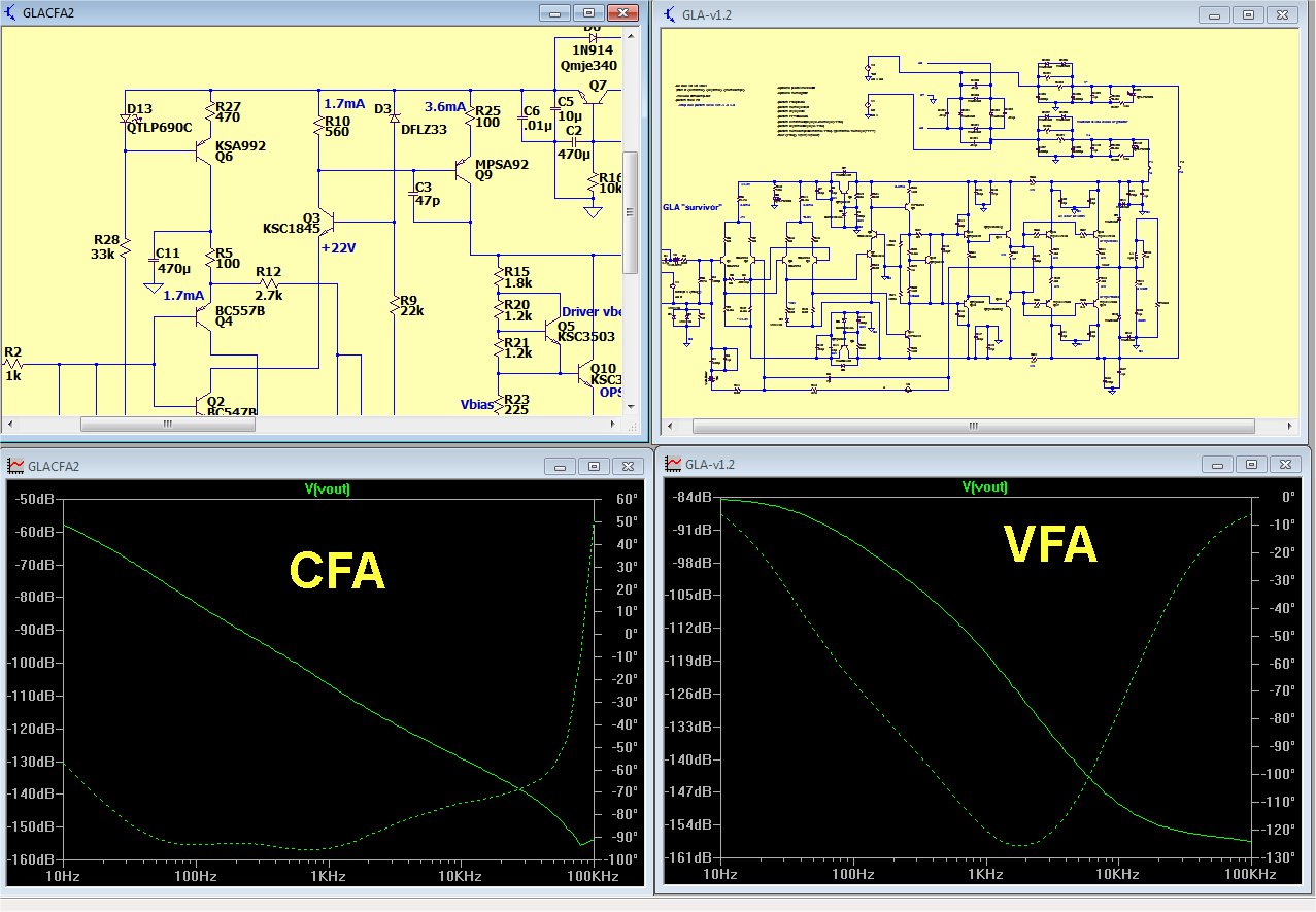

By lazy cat - It seems you ignore me,
Oh ... no, You seem to be the one that started this whole CFA thing.
I took the steps you suggested (CCS) (below 1) . Added the cascode to
allow 70v rails and to have a massive choice of input devices (only 24V-Q2/4).
It is close to my known VFA (below 2 - comparison),
I might try to use Voltage regulators instead of current sources to close
the gap (20db). Still , not bad in most of the audio range.
By Bimo -I wonder if someone can judge the quality amp design but he/she is never build the mathematical model or simulating or build the amp then measure and listen.
But after extensive simulation the amp will work and not burn. The finer "tweaks"
(different compensation/currents) and assessment can come later with the real amp.
EDIT - nope .. CCS is best. Omitting either the CCS OR the cap multiplier
sends PSRR right to the "doghouse". Attachment 1 schema is best for PSRR.
OS
