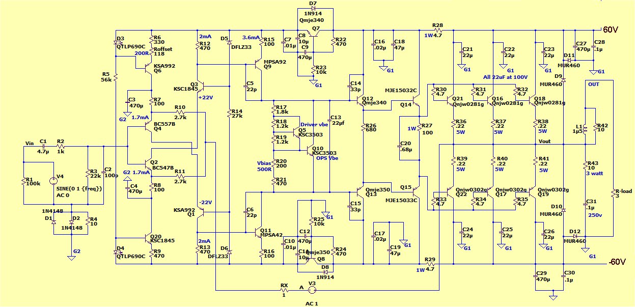

"Balanced" Results ...
From my VFA perspective - the example amp (below 1-final) is a very nice performer
(simulated).
UG (below 2) is typical of my "fastest" VFA ,LF OL gain is nowhere where it is in
a typical "blameless" ... but it is not one .
. Slew is much better , 80K square waves are perfect. THD stays at .005% from 20hz to 40Khz before rising (3R) ,
and with the triple OP , 2R - 8R ... everything stays the same. 🙂
I don't think matching will be a real issue - swapping dissimilar models for
the input pair did not produce as much offset as in a classical (VFA) differential.
Adjusting the positive CCS nulls the DC perfectly.
I would build this just to A/B it to the "badger" or the VFA harmon/kardon 680
the triple is based on.
OS

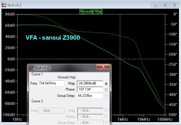

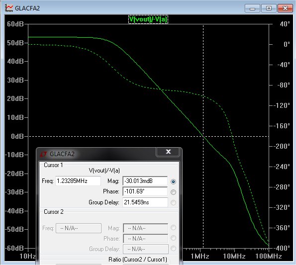

I remember that you have standard (tho very general) on phase response. How they are compared 😉
So you'll know if CFA works with wider variation of speakers (but it can be seen from simulation) 🙂
CFA has real short group delay (plot 1)
VFA is plot 2. It is the sansui Z3900.
Either amp will work with any of my speakers - even 2 pairs in parallel 😀.
OS
