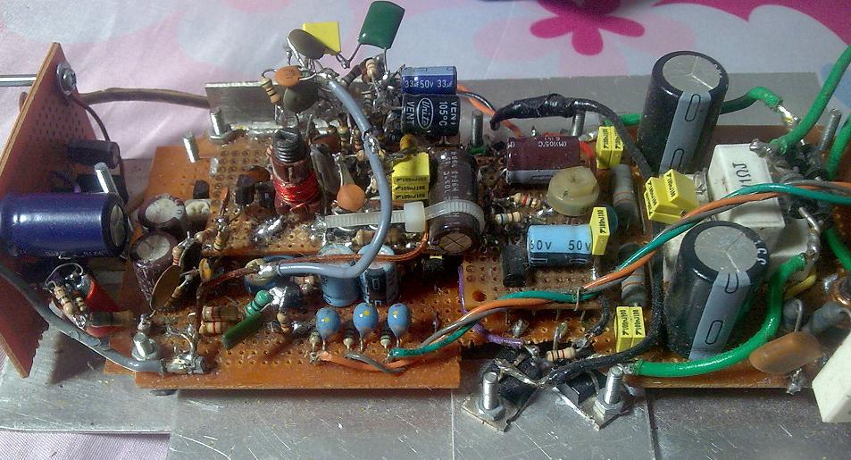

Anyway my amp isn't simple:D It has two type of input stages, two tonal network, one anti oscillating network, one split floating supply, one fatiguing eliminating T path, output passive damper (crossover like but rather a damper), input stages (with opamp), Feedforward path from the opamp to output, and damper manipulating.:eek:
Yes that is true that topology of input stage and its device is one that affecting "another thingy" that is very related to sound quality.

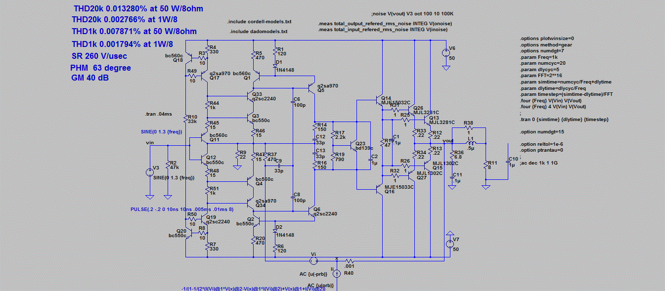

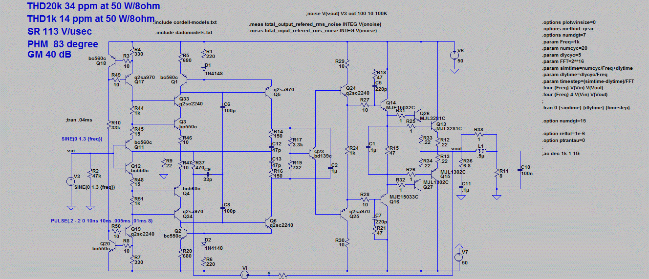

Two CFAs, one with lower distortion (triple OPS) one with higher but with with very musical harmonic distribution (EF2).
Both amps with very good clipping behavior, good PM and GM.
Damir

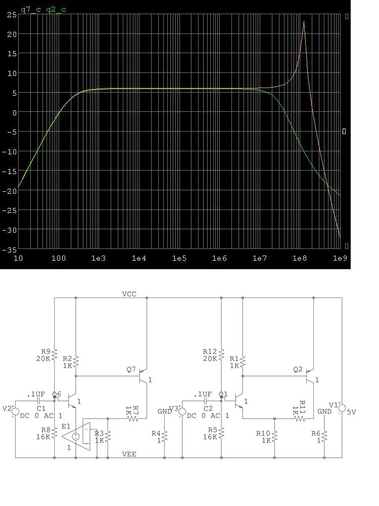

The simplest example I can think of, the so called current feedback pair. Making the feedback only the sampled voltage at the emitter of the NPN has dramatic effect on BW and Aol. Even this simple example embodies the major issues. You cannot break the loop properly without the feedback network loading the output as well as appearing in the emitter of the input NPN. The input voltage is impressed across the base of the input device and a resistance to ground, not the base to emitter of the NPN. The current in the feedback network matters hence the simple semantic device to differentiate the two.
