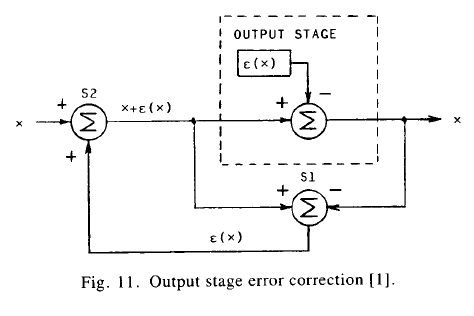

I last remember thinking the Cordell/HEC is a single degree of freedom loop - everything can be resolved into a simple error feedback loop
from Bob's "MOSFETPowerAmplifier with Error Correction" article:
Yes, the HEC arrangement can be viewed as a local negative feedback loop where the combination of summers can be reconfigured to show a unity-gain positive feedback loop in the forward path. Thus, in principle, when things are properly adjusted, there is infinite loop gain. As with any other feedback loop, this infinite loop gain must/will be brought down as frequency increases. The topology itself does have practical advantages, as described in my book. Indeed, HEC requires local compensation. However, interestingly, the primary compensation in the loop acts as a feedforward to the signal, not killing the signal bandwidth. The HEC circuit also forms a very tight local loop, and with fast MOSFETs works quite well.
As I have said before, the different ways of looking at HEC provide different useful insights.
Bob

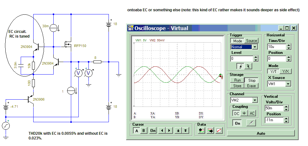

Yes, this kind EC is working on negative feedback loop, even for simplest form, I don't now what is this EC name, you could call it ontoaba EC or something else;). 0.0055%THD 20k in sim working on simple common feedback.
