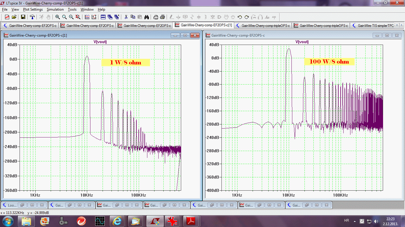

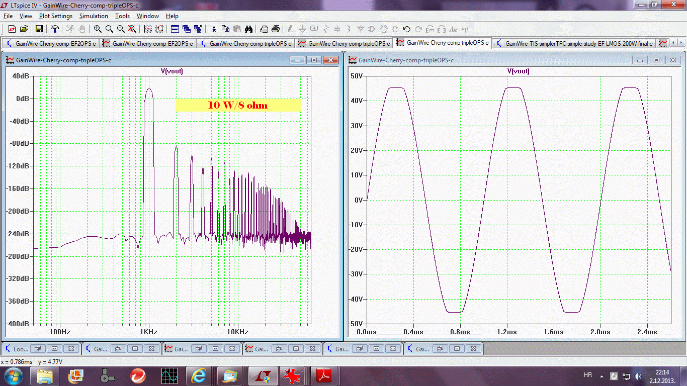

The harmonic distribution for 1W, 10W and 100W.
I never built any amp with such high distortion and don't have listening experience with that kind. I am tolking about simulated distortion as I do not have equipment to measure very low distortion.

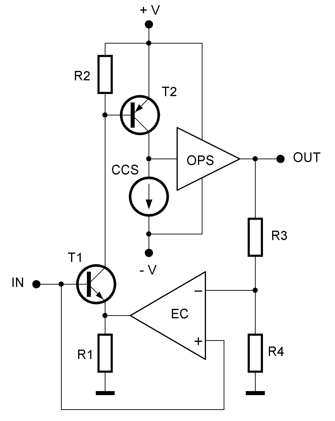

Something like this - combined CFA and VFA with EC, positive features from both worlds.
An EC is normally local, so it will help the slow of main feedback.

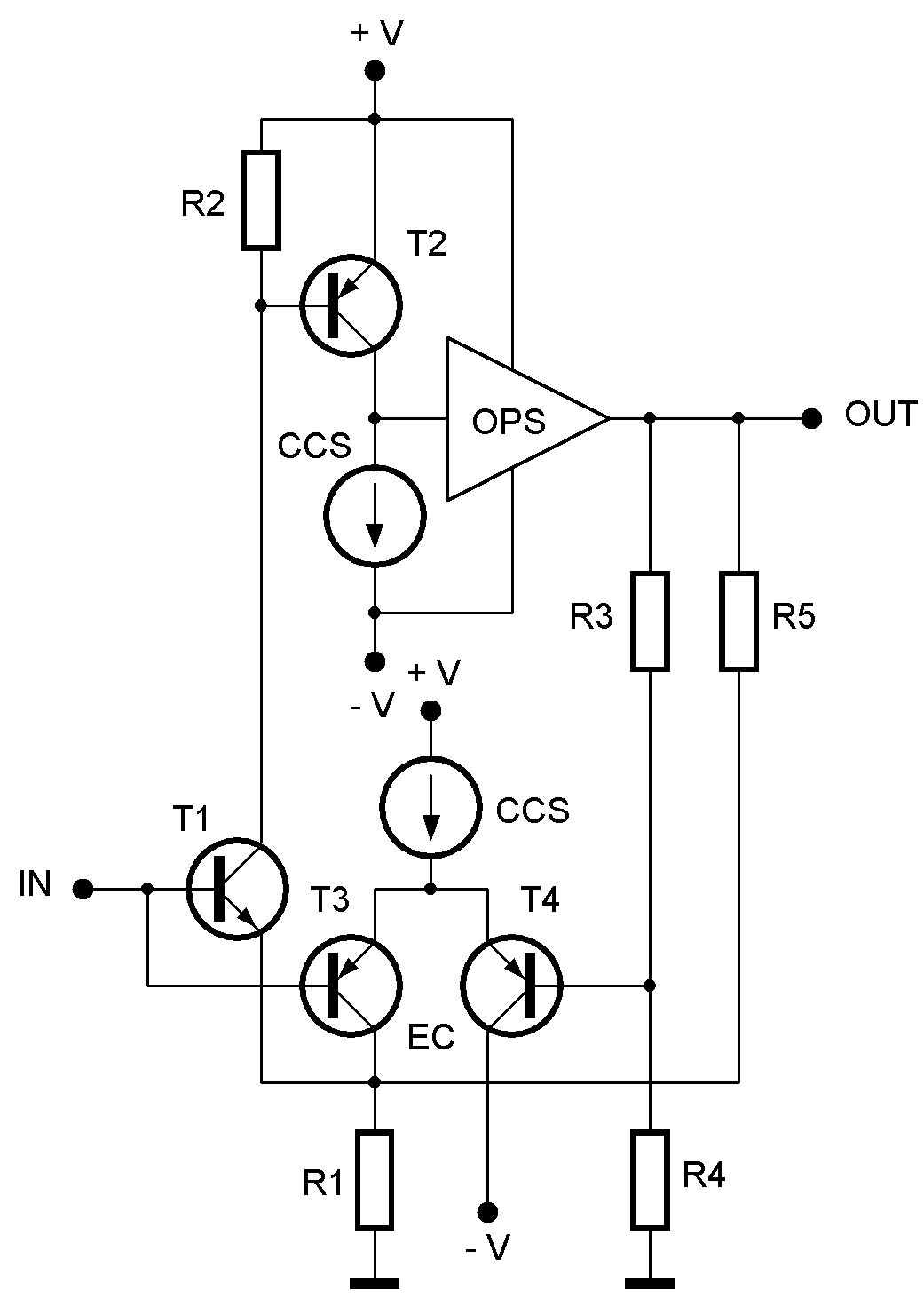

And, when you combine the whole thingy into symmetrical, complimentary, push-pull... etc what do you get for a schematic?

Umm,.. isn't that just half CFA? Is that combination better than separated?
I tried-it. Too tricky for mass production on my point of view as we just reduce the phase margin (for the same reason). I don't want to report my listening experience of those tries to not influence you, if you try-it in future. One objective point is you get better distortion numbers and speaker's damping.Yes clearly, but in this case in discrete way and just as an error correction signal added to the regular CFB.
