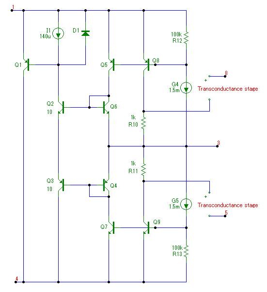

But.....by translinear I suppose you mean that the circuit obeys exactly a geometric mean rule (also known as constant product rule). If that was indeed the case, then the circuit would be vulnerable to Vbe mismatches. Fortunately that isn't the case, as I have shown here (see graph, red curve), the LT1166 does not obey the geometric mean rule. Instead, the current of the inactive OP device is always held above a safe minimum level, according to my simulation about 40mA (or 1/3 of Iq). With such a minimum current, the voltage drop across the sensing resistors, typically 0.22 Ohm, is always large enough to cope with some Vbe mismatch.

Not necessarily. Translinear just means that you make a circuit with one or more loops of diodes or BE-junctions, such that the number connected clockwise in each loop equals the number connected anticlockwise, and take advantage of the exponential voltage to current transfer to make some nonlinear function. That nonlinear function could be a product, a geometric mean, a harmonic mean, the 33rd power root of the product of I1 to the twelfth power and I2 to the twentyfirst power, or anything in between.

This is not true, Vbe mis-match in this context is a simple scaling error. Delta-Vbe with current ratio factors out the absolute Vbe, i.e. 10X the current is an ~60mV delta for any Vbe. If you normalized those plots I don't think the difference is that large.
Constant product biasing works fine.

I agree with Edmond on this one. It is not the VBE mismatch inside the translinear loops that could cause a problem, but the VBE mismatch in the input stages of the op-amps of the voltage to current converters. The LT1166 uses resistors to sense the current, rather than injecting the currents straight into the translinear loop.
Maybe Linear Technology introduced a deliberate offset in the right direction in those op-amps. If so, that could explain why it has a harmonic-mean-like behaviour while its datasheet shows a product rule translinear circuit.

Actually you are agreeing with me, if there is some sleight of hand in the op-amps fine, the operation of the current mirrors is basic physics.

Hi Marcel,
Exactly.
BTW, this circuit is quite immune to a moderate input offset (1mV or so).

I've simmed the simplified circuit of the LT1166 (see below) and it seems that the harmonic-mean-like behavior is a inherent property of the circuit, thus without any deliberately added offset. So, somewhere this 'offset' has been hidden. Where exactly, I haven't figured out yet.Maybe Linear Technology introduced a deliberate offset in the right direction in those op-amps. If so, that could explain why it has a harmonic-mean-like behaviour while its datasheet shows a product rule translinear circuit.

BTW I assumed we are talking about IC's typical delta Vbe's would be in the 250uV max region, I would not try to make this exact thing discretely.

In case of a geometric mean bias, even an offset of 250uV might already cause trouble: Suppose Iq = 100mA and RS = 0.22 Ohm and the active OP device draws 10A, then the inactive OP device should draw 1mA. IOW, 220uV across RS. With 250uV offset in the 'safe' direction, the latter current will rise to ca. 2mA, while in the ''wrong' direction it means havoc (as 250uV > 220uV).

Yes, offset in the sense amp is bad I meant in the translinear loop even 18mV means you have 1/2 of what you thought but it can't fail from sign reversal.
How did you model the op-amps? Ideal controlled sources with huge gain?
The base currents of Q7 and Q8 subtract Iref/hFE from the sensed current, so maybe it is simply the finite DC current gain of Q7 and Q8 that does the trick. Does it still work with ideal voltage followers driving Q7 and Q8? Or with the BF of the transistors increased by a few decades?

They were simple synthetic transconduction stages (VCCS) with a gain of 1.5mA/V (the same as in the real chip). Please see pic below. (D1, R12 & R13 have little effect. They only are meant to avoid convergence issues. Node numbers correspond with pin numbers of the LT1166)

Beta does have some effect, but not that large. When I increase beta to 10000, the minimum drain current (of the OP device) is half as large, but still much larger than expected form a true geometric mean bias control.The base currents of Q7 and Q8 subtract Iref/hFE from the sensed current, so maybe it is simply the finite DC current gain of Q7 and Q8 that does the trick. Does it still work with ideal voltage followers driving Q7 and Q8? Or with the BF of the transistors increased by a few decades?
