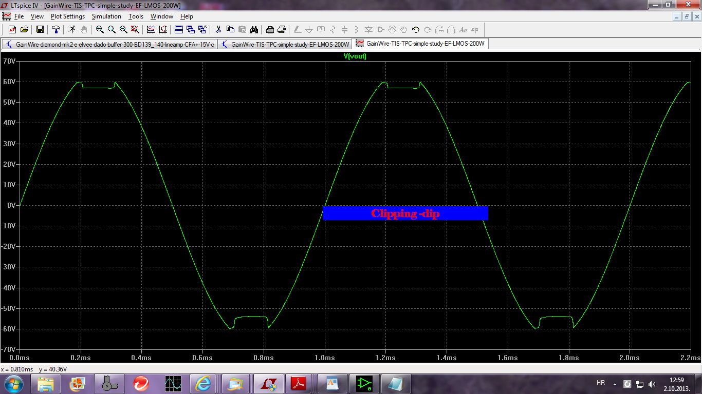

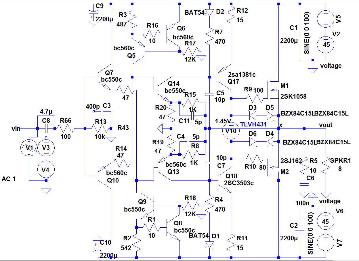

Hi Edmond,
Does simulation wil that "sticking"?
This is simulated clipping of my 200 W CFA with lateral output and no "sticking" at all.
BR Damir

Hi Damir,
That looks OK. But I have a few questions:
How well does the circuit behave with even larger input voltages and higher frequencies (e.g. 20kHz)?
Are you sure there are no transistors that saturate. Beware of the fact that they might suffer from sticking, while a simulation doesn't show it.
Where can I find the schematic (as there are so many updates)?
Cheers, E.

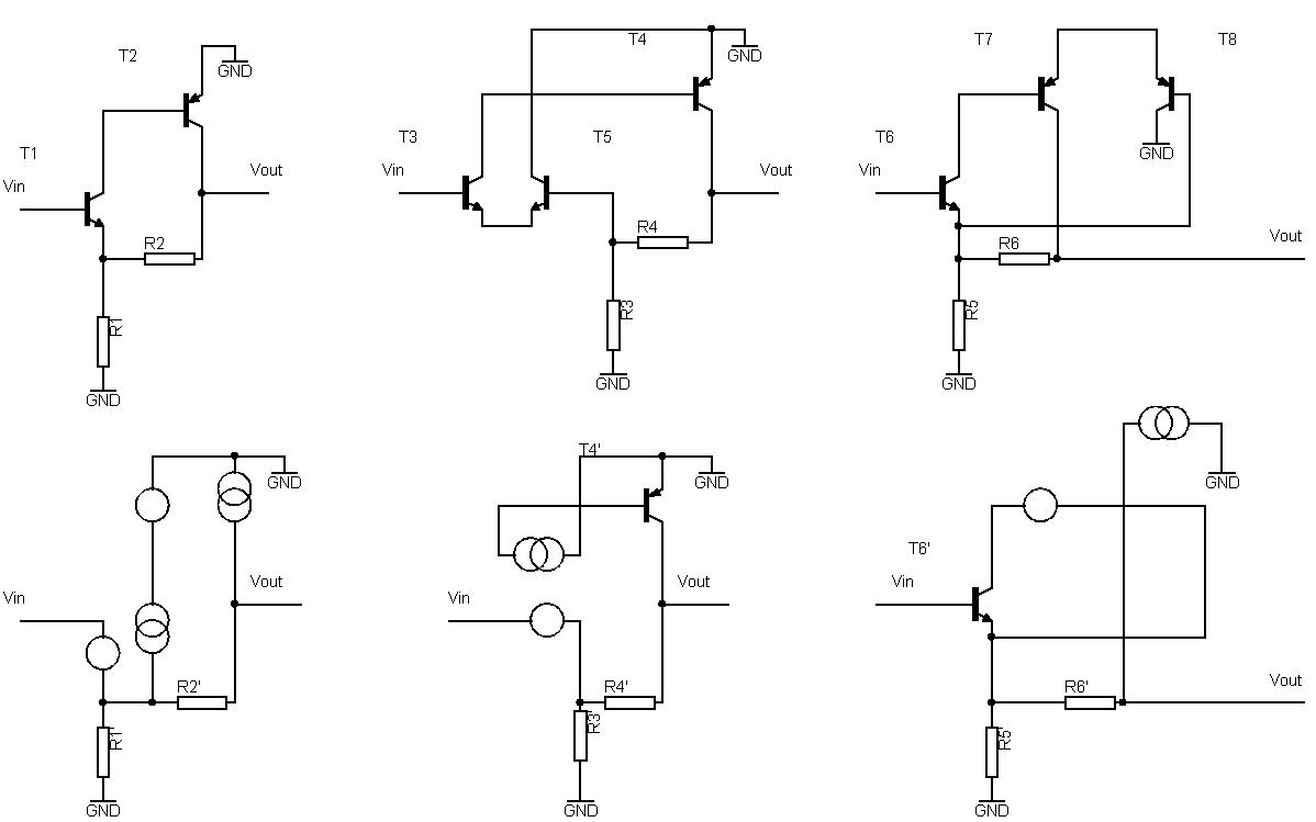

Hi all,
With the risk of stating the obvious or stating something that has been stated before in this thread (which I haven't been following since the beginning), I would like to make a few comments:
Slewing
Slewing is caused by clipping of the stages in front of the stage that sets the dominant pole or poles. Hence, there are two ways to get a good slew rate:
1. Make sure there are no stages in front of the one that sets the dominant pole, as explained by Edward
2. Ensure that the stages in front of the one that sets the dominant pole don't clip. For example, you can use a large bias current combined with local series feedback (emitter degeneration). The emitter degeneration need not be active at low frequencies, so you can put a big inductor across the resistors if you like.
Another approach is to use some sort of class-AB biasing for these stages. One way to do that is with complementary common-base stages and current mirrors, the input stage topology used in most of the controversial feedback amplifiers. Other methods can be found in:
Giovanni Stochino, "Non-slewing audio power amplifier", Electronics World March 1996, pages 256...259
M. G. Degrauwe and W. M. C. Sansen, "Novel adaptive biasing amplifier", Electronics Letters 3 February 1983, pages 92 and 93
Terri S. Fiez, Howard C. Yang, John J. Yang, Choung Yu and David J. Allstot, "A family of high-swing CMOS operational amplifiers", IEEE Journal of Solid-State Circuits, December 1989, pages 1683...1687.
Amplifiers that remain inaccurate when the gain of one stage is made infinite
See the attached figure. The upper three schematics are the signal schematics of three amplifiers. Everything related to biasing is left out.
As someone already mentioned (in different terms), the voltage gain of the upper left circuit does not approach the feedback resistance ratio plus one when the gain of one stage approaches infinity. When the gain (I mean voltage, transadmittance, transimpedance and current gain) of the first stage goes to infinity, you still have an error term from the second transistor's base current. When the gain of only the second stage approaches infinity, you still get an error term due to the Early effect of the first transistor. You only get a transfer set by the resistance ratio plus one when both stages have infinite voltage, transadmittance, transimpedance and current gain.
One way to solve this issue, is to use a differential pair as the first stage, see the upper middle figure. The base current of the second stage now no longer flows into the feedback network, but the circuit has become off topic as this is voltage feedback in all senses of the word.
Another approach is the upper right circuit. Assuming matched transistors in the second stage, the base current error of the output transistor T7 is corrected by the equal but opposite base current error of T8. There is ideally no signal voltage across the input transistor T6 and, hence, no problem with T6's Early effect.
This circuit looks like it is on topic, with the feedback network connected to an emitter, but any current flowing in is compensated by the base current coming out of T8. Hence, I'm afraid this one is as off topic as the middle circuit.
The bottom three figures illustrate what I've just written for those familiar with two-ports and nullors. They show how you can get to a closed-loop voltage gain of the resistance ratio plus one by replacing the minimum number of stages with nullors (two-ports with infinite voltage, current, transimpedance and transadmittance gain).
A single circle is a nullator, a network element that conducts zero current and has zero voltage across it, a double circle is a norator, a circuit element that can conduct any current and have any voltage across it. Together a nullator and a norator form a nullor, an infinite gain two-port that can only be used in feedback configurations. A nullor is basically the same as an ideal op-amp, but with an extra output terminal that conducts an equal but opposite output current.
For all circuits except the first, it suffices to let one stage get nullor properties. For the first circuit, both stages need to get nullor properties. Note that a nullator with a norator in series is equivalent to an open branch.
Best regards,
Marcel van de Gevel

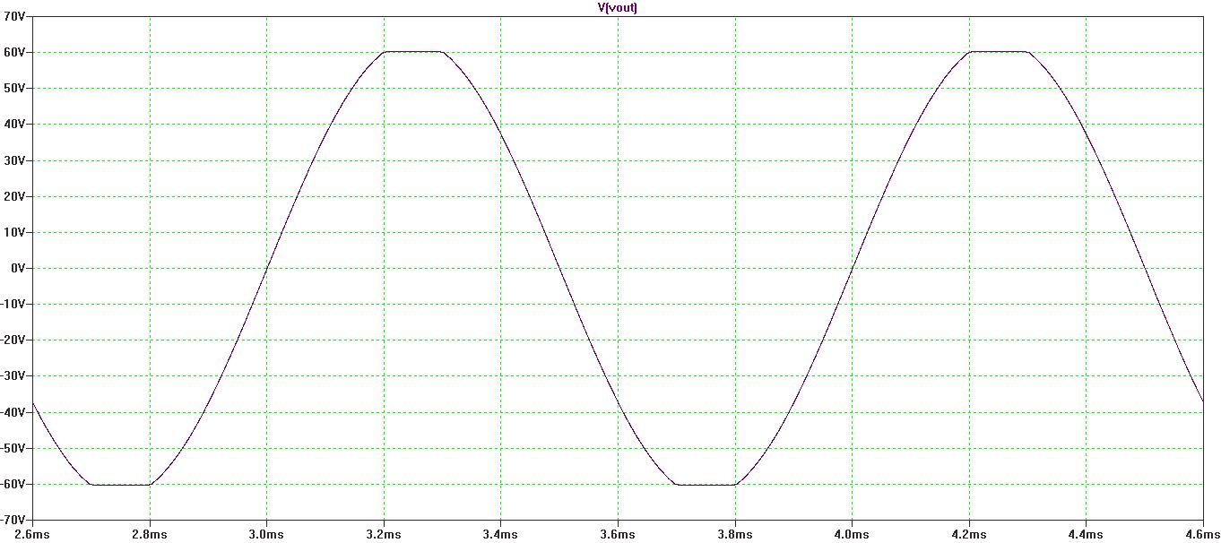

Sticking
>I have no sticking issues on CFA either. Clipping in fact is very soft.
Hi Andrew,
Apparently it depends on circuit details. One of Damir's earlier versions does have clipping issues, see pic, Glen K. and I had also issues.
Cheers, E.

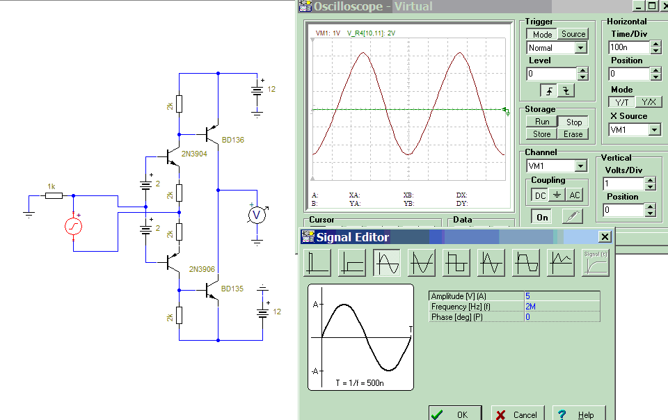

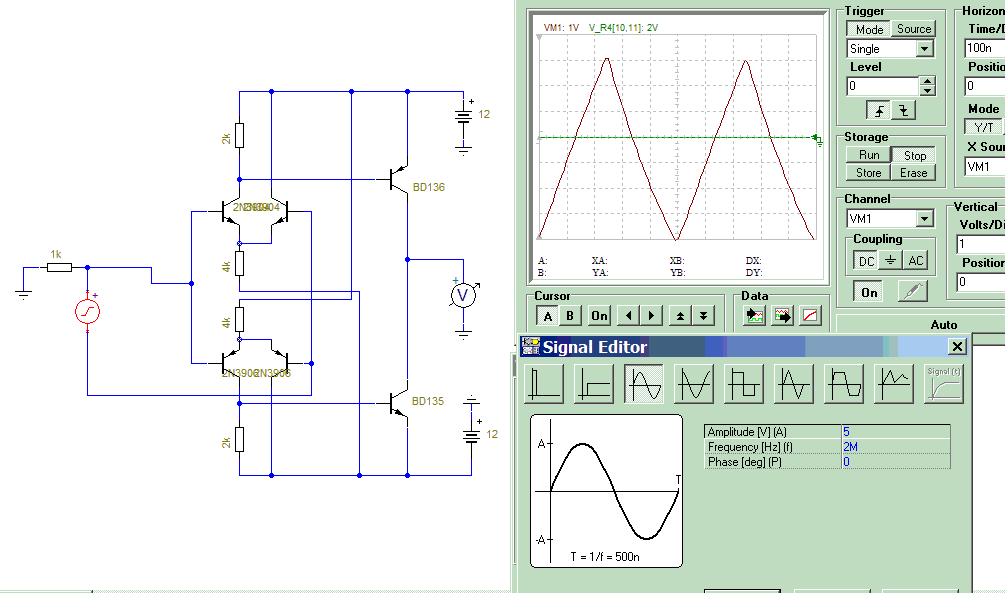

Why ? Nothing impeach-you, and it is even recommanded, to use a CCS, collector side, to set the DC current of a VFA's input stage.- the quiescent current through the device ;
unlike a VFA input where the quiescent currents are settled "externally" to the devices by a constant current source.

I am not sure to understand what you mean by 'the control of the circuits'.Does it make the control of two circuits behaving differently, one relying on currents subtraction (CFA), the other relying on transconductance (VFA) ?
Same remark on my side. Of course, you will take care to set a low pass filter at the input to ensure slew rate margin under all circumstances. This will avoid TIM as well. The high bandwidth of VFAs will help to get higher margin and high enough FC to get a flat phase response.I have no sticking issues on CFA either. Clipping in fact is very soft.

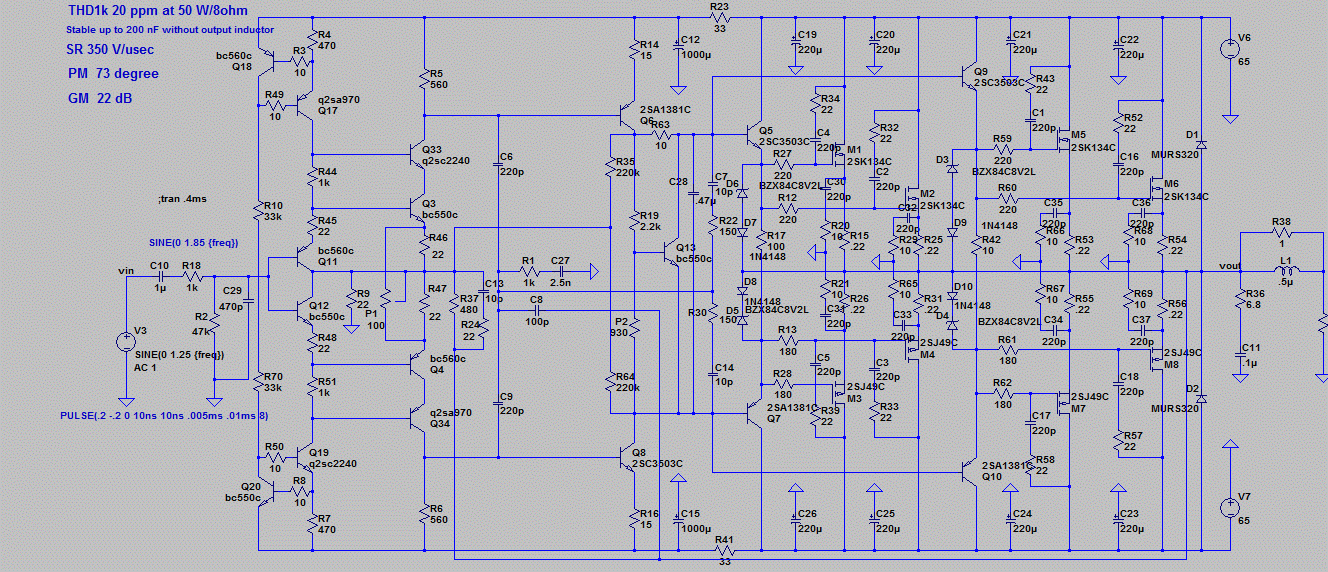

Hi Edmond,
Here is schematic and zip file with .asc.
BR Damir

Hi Edmond,
This is one interested case. It uses enhanced VAS/TIS and the collector protection resistor in the enhancer transistor should be of higher value. With 220 ohm that was standard used in VFA) there is "sticking", but increased to 4.7 k the sticking disappeared.
BR Damir

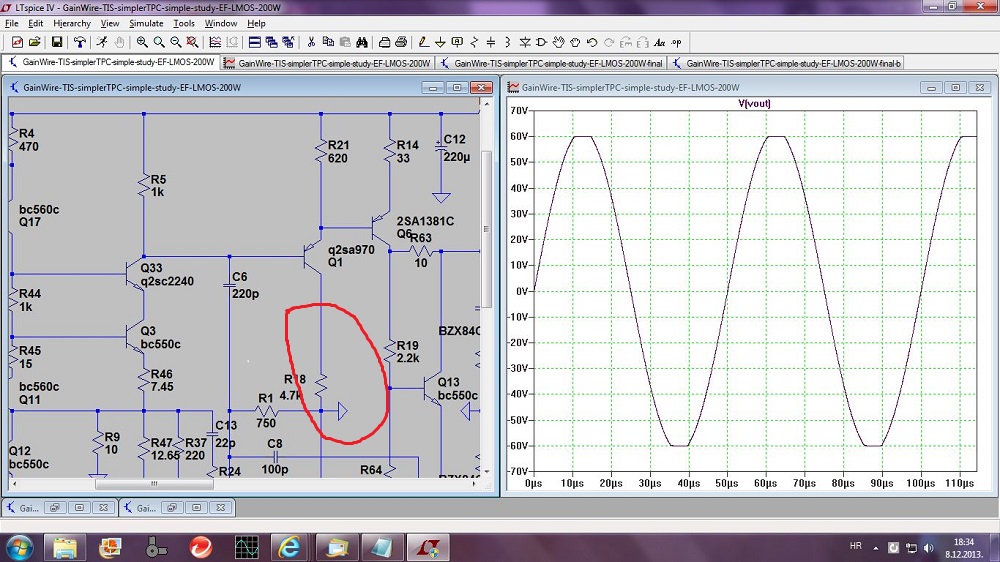

Hi Damir,
But then Q1 gets saturated. As I don't trust simulations with regards to saturation effects, I hope that also in real life this 4.7k resistor will solve the sticking issue. Anyhow, a CFA IPS can deliver far more current than a VFA IPS, so more attention should be paid to overload conditions.
Cheers, E.
Hi Edmond,
