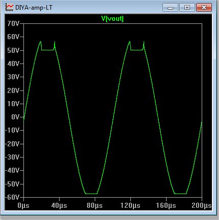

Edmond, that sticky clip is not coming from the CFA. This one clip in 2MHz and not sticking. input is 40Vpp
Add: Probably in your amp, there are some BJT with collector voltage reaching its emitter voltage (zero Vce) then ti is sticking.

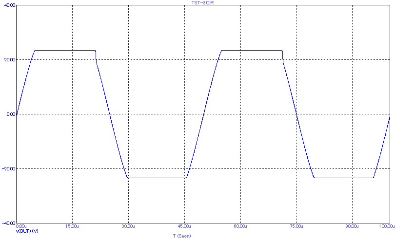

Hi ontoaba,
Indeed, no sticking. But that circuit has little to do with a real amp.
Below another example that does show sticking. It also shows how unreliable simulations can be: Only the positive halves show sticking, while the negative halves don't stick at all. The 3rd pic shows the effect (more sticking) of making R6=R7=3k that should protect the emitter followers Q3 and Q4 against overload. Clearly not a good idea.

Hi Edmond,
It's clearly helping in my case. Maybe you push it to much into clipping, why do you want to generate a square wave from sinus?
If I push my example to much it just stops simulation, but when simulate(still very hard clipping) thare is no sticking.
BR Damir

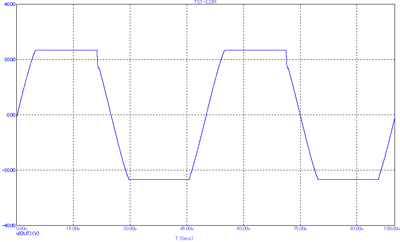

I can see that the sticking is worse with the protection resistor set to 3k.
Why set it that high?
The worst case dissipation in the preVAS is <40mW
Does setting to 680r for a worst case dissipation of 212mW show much degradation from the zero ohm case?
What modifications would you suggest for eliminating the sticking?

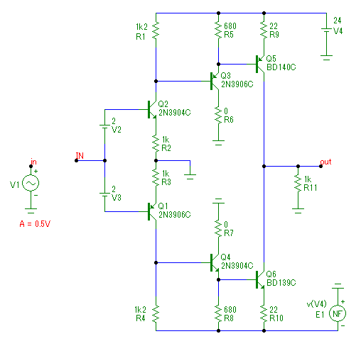

Edmond, you are using BD139/140. In my experience, these were not much better in this regard than MJE340/350 i.e terrible. You can get around it by doing some of the stuff you show above, or use a Baker clamp ( I know you don't like this latter solution, but I think its elegant). Try this same sim with a fast tranny KSA1381 and it's complement for example. The results should be better.
Well, well, well, it took quite some time for you to reach to this conclusion.

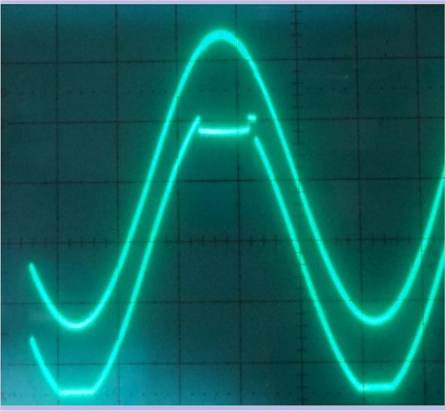

ksc3503/ksa1381 (models) stick the worst. But , I feel those models most accurately
represent the real devices.
I was given a shining example by a Badger build. My simulation reflected the
real oscilloscope reading to a "tee".
Same simulation with mje340/350 , any of the BDxxx's , most of the included
LTC collection or many of my japanese models - NO sticking.

@AndrewT. I wasn't my idea to use such protector resistors. It was Damir's suggestion, see this this post.
The reason I've used them in the simulation was to show that they make things even worse.
@Andrew (Bonsai), Again, it wasn't my idea to use BDxxx's and I agree with you that SA1381 and SC3503 are way better for a TIS.
Is that so? I do use Baker (or other) clamps, even when a sim doesn't show sticking. Better safe than sorry.

Ostripper that is not rail sticking you are showing there. Rail sticking is when you have overhang after the waveform exits clipping. What you have there is saturation during the clipping event that's causing phase inversion which in turn is being clamped by some mechanism. You probably still some sort of clamp or shunt to fix it ( I'd have to see the circuit to comment) but this is not rail sticking IMV.

I agree with Bonsai, no real rail sticking there.
Easy to remedy your case, use a diode in place of vas emiter resister.
Saturation - "sticking"
My point was how accurately the models simulated the actual circuit.
Unfortunately, (fortunately for the real world) I have encountered both in
my simulations - preparing me for what I was about to construct (burn up 😀).
The fairchild ksa/c 992/1845 , 1220/2690 , 1381/3503 and Cordell's ON semi
modified models are Sooooo close to reality ... nearly right to the Pf and ohm
when it comes to where the real "mcCoy" will burst forth with "magic smoke".
P vs. N channel (model wise) cannot prepare you for what you pull from the parts drawers.
For example , I would use a "wrong" device in a differential
to see how that circuit would behave with a mis-match.
I did add a "anti-saturation" diode to the real above circuit. Works well.
BTW -At gross overloads the bottom (ksc3503) would actually "stick"... as well.
