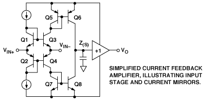

Diamond input buffer or not --- if any circuit does not fundamentally look like this --- it is not a CFA. Strictly speaking. Everything seems to get simplified or dumbed down.... so now we have anything with feedback of any kind to an emitter/source as a CFA.
Just to stay clear. There is a difference. When we go to simplify this further..... down to a minimalist circuit, we could end up with something else. But that can also be pretty good with care.

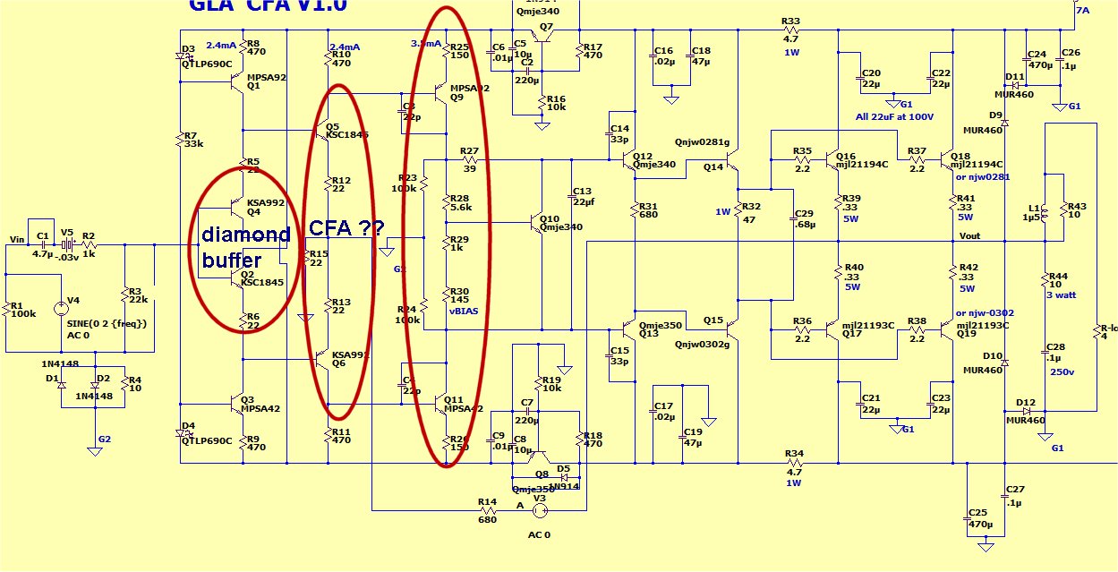

Will someone please say which post shows a Diamond buffer. Thanks
Can something be agreed upon to be built and listen to so that those that have never heard one can compare it to other topologies. Again Thanks

The term current feedback has nothing to do with the characteristics of the feedback, see Walt Jungs and Barry Gilberts definition of when and why a amp is called current feedback.
Ive posted this before long ago but I see the most still like to base the analogy on the feedback characteristic.
The answer can be found in Walt Jungs Opamps applications handbook.

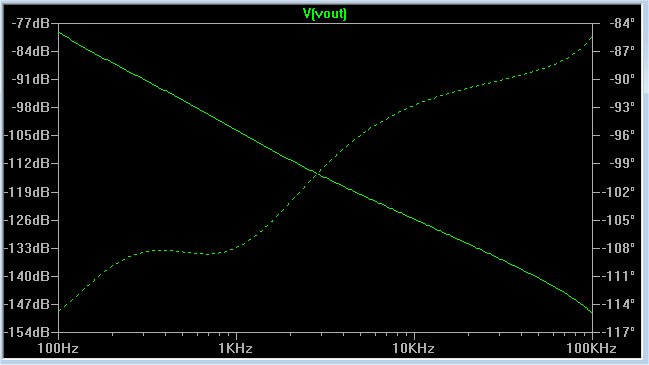

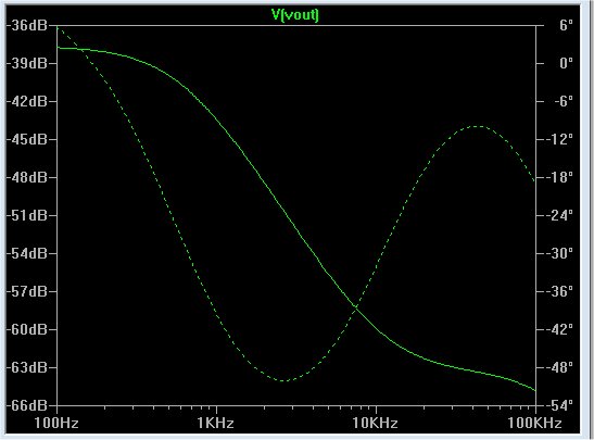

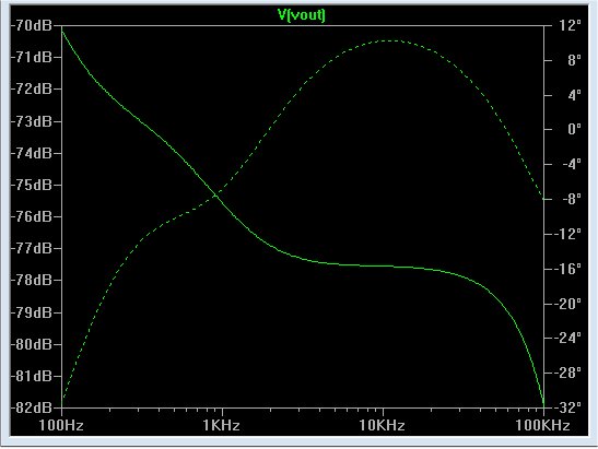

Here it is (below 1)..
Below 2/3/4 are the PSRR plots
2= native amp
3= cap multipliers
4= multipliers + a 8200u-1R-8200u CRC PS
BTW - THD = .007% 20khz FULL power 3R load , not too "shabby"😀 .

what do the two 10Kohm resistors to GND around the VBE do..?? I would expect them to be a source of distortion.
I see the diamond is just another way to bias the input pair, an advantage here is that you just have one FB network.
IRL the tolerances of the two FB networks for the VSSA may be of greater damage than the input diamond, matter of tradeoff i guess
Also try to add a "cherry" nested FB to your circuit. maY lover your 20KHz distortion 10 times. (have not yet implemented it in real life but s working on something.🙂
(I have not any experience with output trippels so I am not sure if substituting the miller cap with cherry compensation will work without oscillation)
