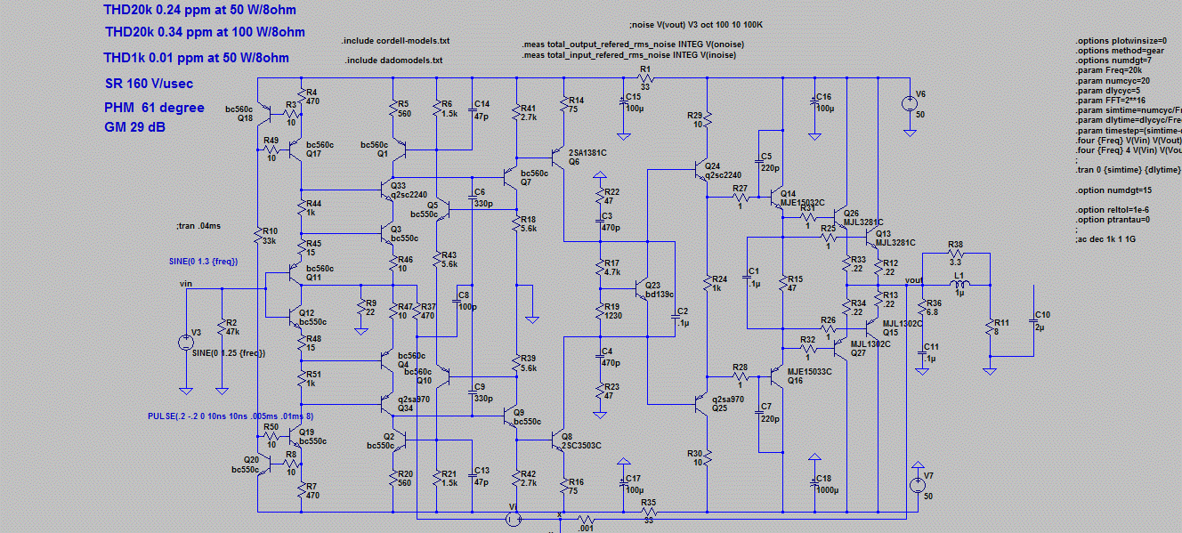

what do the two 10Kohm resistors to GND around the VBE do..?? I would expect them to be a source of distortion.
I see the diamond is just another way to bias the input pair, an advantage here is that you just have one FB network.
IRL the tolerances of the two FB networks for the VSSA may be of greater damage than the input diamond, matter of tradeoff i guess
Also try to add a "cherry" nested FB to your circuit. maY lover your 20KHz distortion 10 times. (have not yet implemented it in real life but s working on something.🙂
(I have not any experience with output trippels so I am not sure if substituting the miller cap with cherry compensation will work without oscillation)
Those are 100k not 10k and better to connect middle point to the feedback input instead to the ground if you want lower LG.
It should work. I showed it in here http://www.diyaudio.com/forums/solid-state/240712-cfa-topology-audio-amplifiers-213.html#post3714654 and here is improved compensation and no problem with square wave now.
Damir

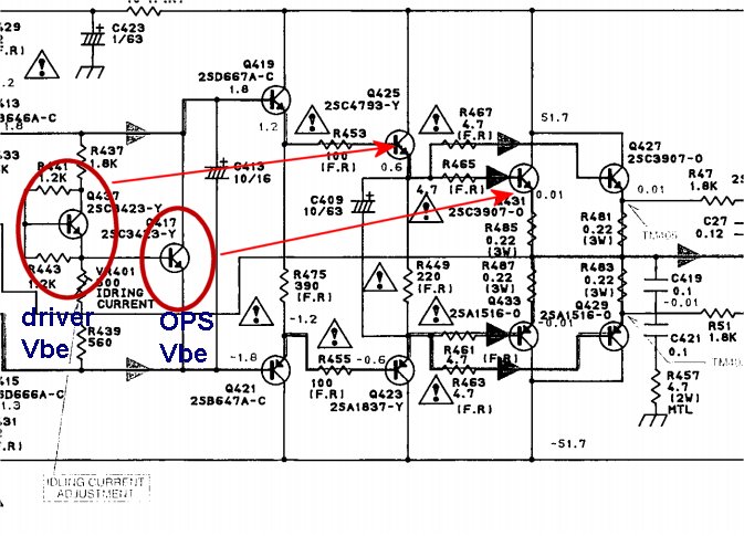

The triple is the BEST , award winning HK680 (below)... build that triple ,
have 20 years of a great sounding "party amp" .
Load it down with 2R subs (4 pair devices) , it will survive.
It's a compound Vbe - one device on the driver HS / the other on
the main HS .... 1mv from snowbank to heated house - Very accurate.
thermaltrak's are the only thing superior (H/K 990).
I own this triple - it is almost 20YO !! very durable/stable.

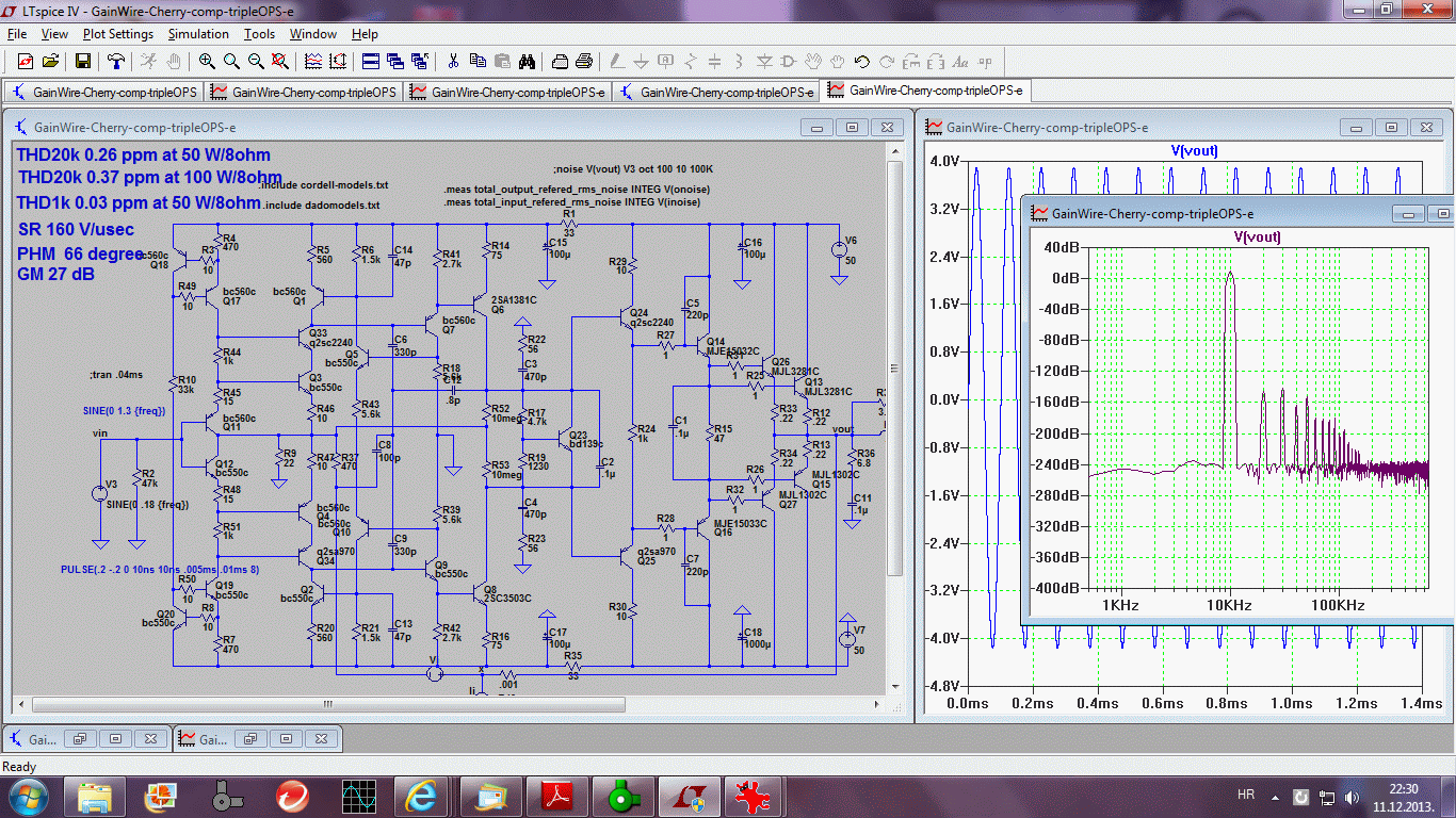

This is FFT at 10kHz and 1W.

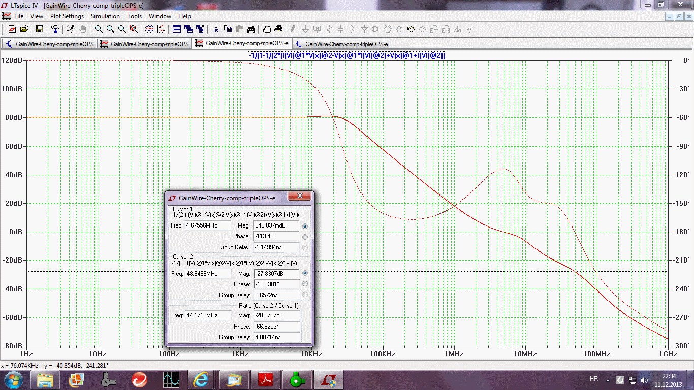

This amp has flat loop gain of 80 dB up to 30 kHz(it uses local feedback from VAS output to the feedback input R52, R53).
Damir

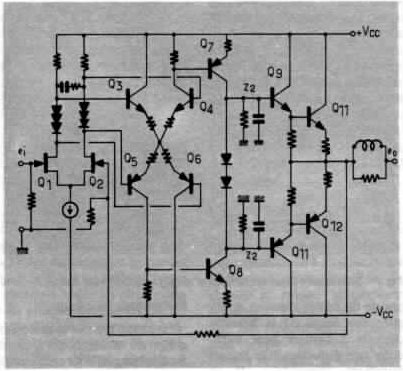

The diamond front end is not from Hiraga. It's been described in professional literature in the 1970''s with the first commercially available devices from Comlinear.
First diamond circuits in the hifi market ?
Revox A740, 1978
Analyse du Revox A740
Hiraga classe A, may 1979
Ralisation d'un amplificateur classe A de 20W
The diamond concept (a complementary pair NPN-PNP of emitter followers biasind ans driving a seconde complementary pair PNP-NPN) was found in low power output stages by W. Jung. It was also used in the output stage of the first solid state power amp built by Audio Reseach.

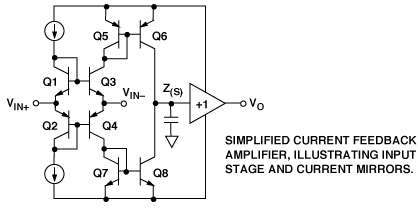

Diamond input buffer or not --- if any circuit does not fundamentally look like this --- it is not a CFA. Strictly speaking. Everything seems to get simplified or dumbed down.... so now we have anything with feedback of any kind to an emitter/source as a CFA.
Just to stay clear. There is a difference. When we go to simplify this further..... down to a minimalist circuit, we could end up with something else. But that can also be pretty good with care.
Thx-RNMarsh
